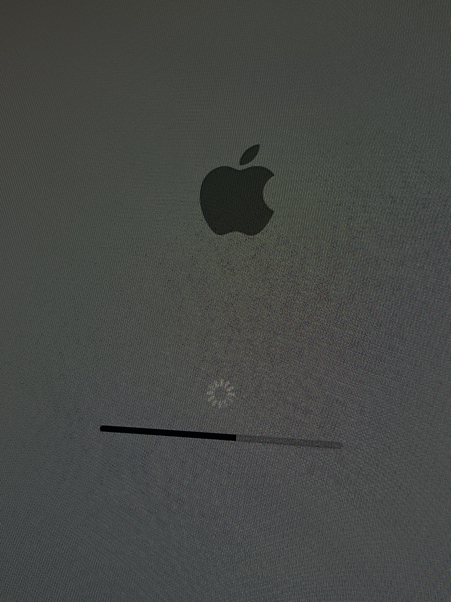

Used Mojave patcher post install to install the emulator on high Sierra and it still quits booting and getting stuck in this...
I don't know if the emulator actually loads considering it doesn't show up when you boot safe mode and if i boot normally I can't get into the os all.
