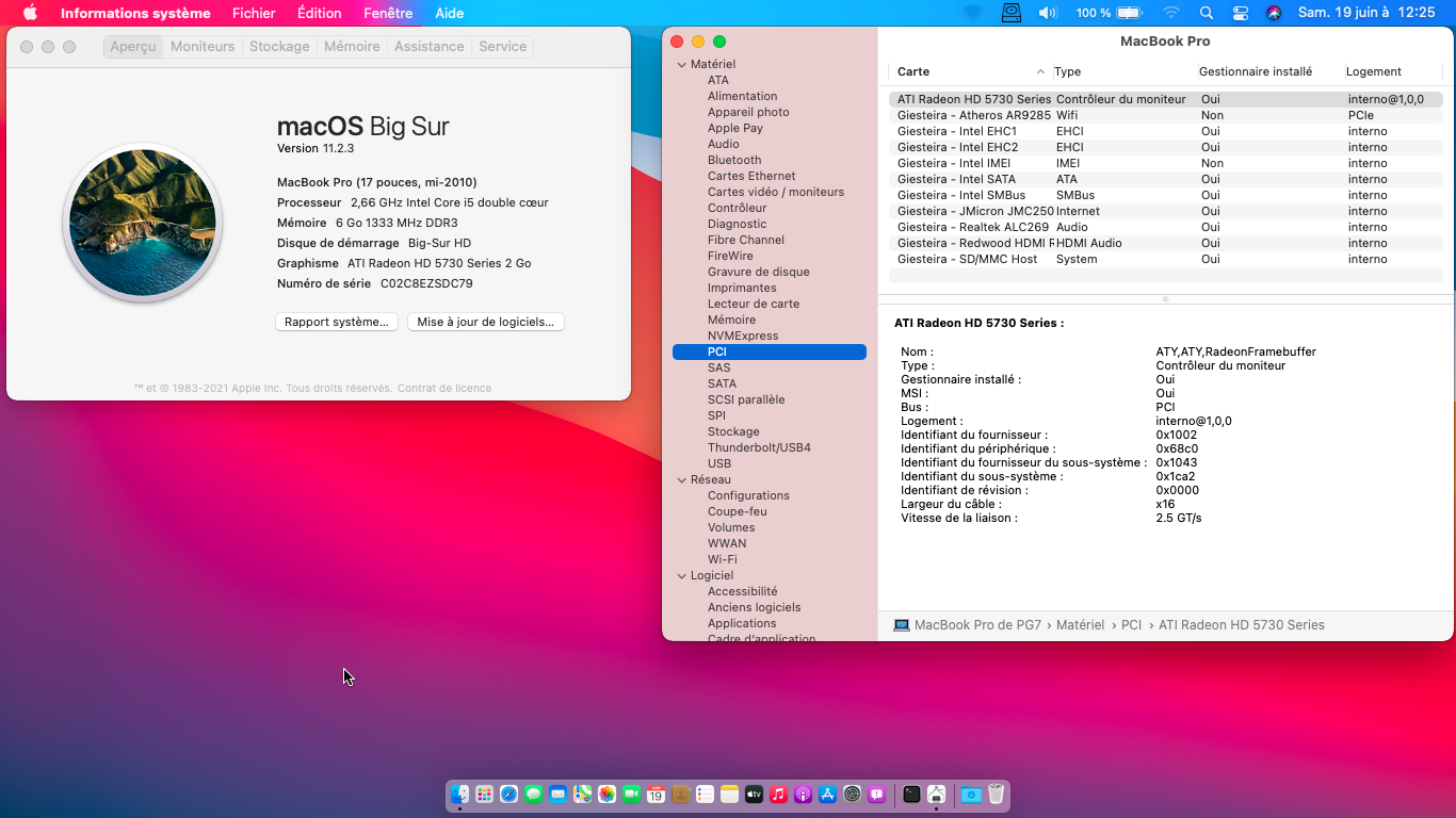

Successful install of Monterey using OCLP on MacBook Pro 7,1
Here’s the GPU information if that helps with the development of the acceleration patches

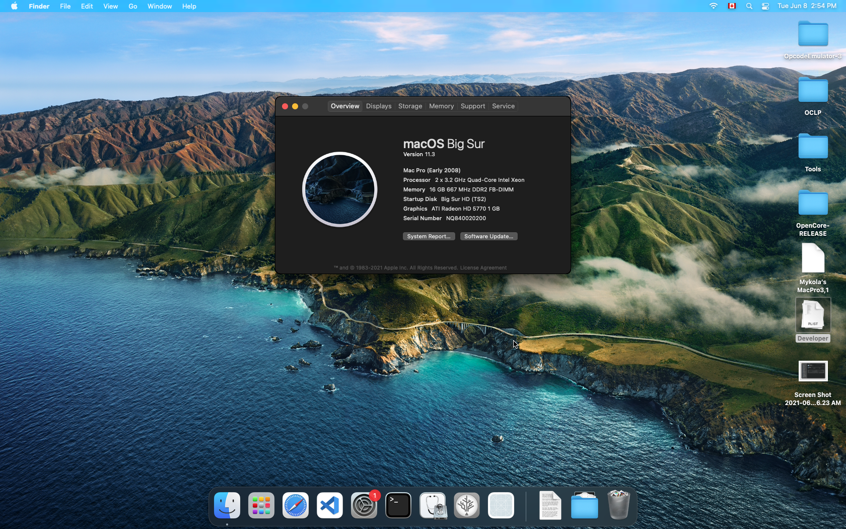

@Syncretic Fantastic work, both Big Sur and Monterey working!
Here's TeraScale 2 working in Big Sur nicely:

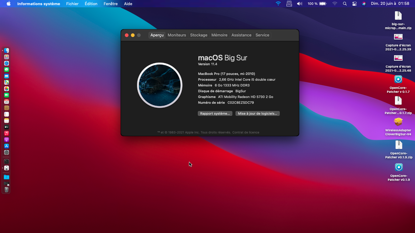

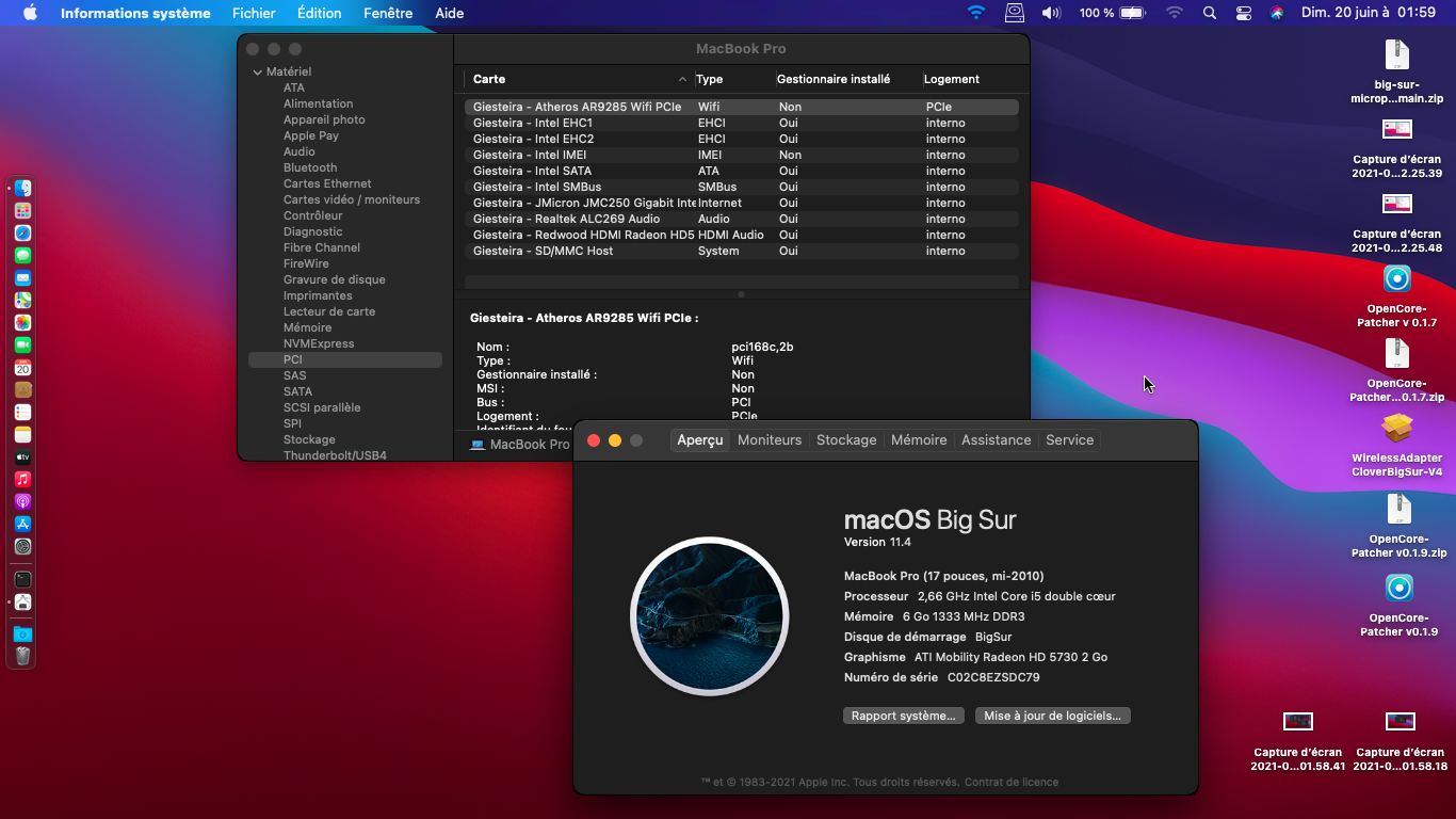

got it but I have flash graphics where the colors are unstable!
in any case brave the community for the work done.

I’m curious why you think you need the SSE 4.2 emulation kext when you have a core i5 processor. Even the first generation i5 (which was based on the Nehalem Xeon used in a 2009 Mac Pro) had SSE4.2.
good morning,
I don't need to emulate the processor SSE4.2 anywhere I indicated this process!
I do need to use Correctives for Radeon HD5730 in Big Sur to enable QE/CI
sorry if somewhere the comprehension is complicated but i use google translator !!!
