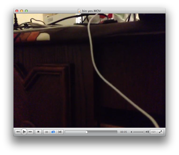

I've just finished playing with two dictionary entries in the AVCaptureSession.plist file:
AVCaptureDevices[0] > AVCaptureSessionPresetCommon > LiveSourceOptions > MinFrameRate and TemporalNoiseReductionMode.
The default values of these are 20 and 10, respectively.
Raising the former to 30 had no effect on the VGA recording made straight in the stock Camera app: under bad light, it consistently recorded with around 20.05 fps, while under good light, it always deliver 29.97 fps.
Changing TemporalNoiseReductionMode from 10 to 0, 1 and 2 and, finally, deleting the entire entry didn't change the framerate, either.
Finally, I've played with an added "Binned" Boolean entry to AVCaptureDevices[0] > AVCaptureSessionPreset640x480 > LiveSourceOptions. Setting either NO or YES had absolutely no effect on the framerate / low-light performance. (Of course, binned mode didn't work with high resolutions in my earlier tests. I just wanted to know whether changing it has any effect on VGA recording in iOS7.) Attached are two framegrabs of the two videos; the upper bar of VLC shows which mode was currently enabled.
All in all, I don't know of any way of forcing iOS to shoot at 29.97 fps even in bad lighting, on the expense of exposure (which, in post processing, could be increased if framerate is more important than the signal-to-noise ratio / dynamic range.). Neither the third-party (API) way nor the direct AVCaptureSession.plist hacking way seem to work. Sorry.
