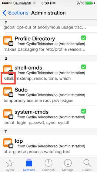

Guys, some GREAT news:
you no longer need to kill the Camera app when changing any parameters using my app. With the help on the iOS port of the Unix command-line utility "killall", I was able to implement automatic Camera killing right from my utility.
The "killall" port is automatically installed with all Cydia installations, regardless of the version of the iOS. Nevertheless, should you want to check whether it's really installed, got to Sections > Administration in Cydia and look for shell-cmds. If it's installed (there's a green checkbox on the right), then, you don't have anything to do. (If, for some reason, it isn't, you can safely install the whole package.)
A screenshot:

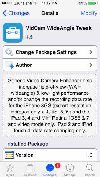

And, finally, a test version (1.5) already killing Camera after saving the new settings as a DEB file: https://dl.dropboxusercontent.com/u...videocameraenhancerios67_1.5_iphoneos-arm.deb
Source: https://dl.dropboxusercontent.com/u...ancerDEB/iPhoneWideFoVCamcorderEnhancer15.zip
A screenshot:
I've finished testing this version with the just-released 7.0.6 (on my iPhone 4). Works just fine WRT not having to kill the Camera app manually. I'll very soon post it to my Cydia repo; before that, feel free to use the DEB installer: https://dl.dropboxusercontent.com/u...videocameraenhancerios67_1.5_iphoneos-arm.deb

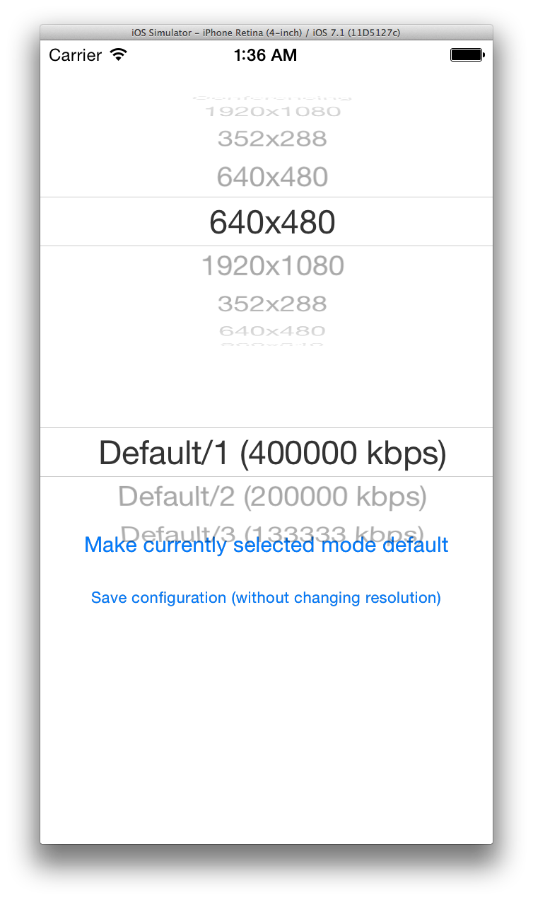

It's, slowly and steadily, getting ready. An example screenshot of the current state of the GUI, showing absolutely dynamically presented values:
