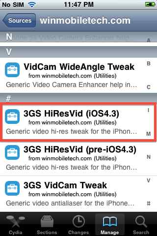

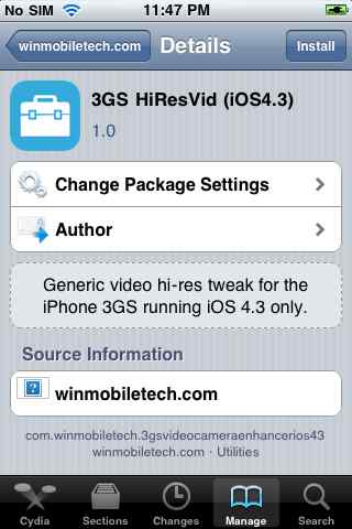

I've released the final version of my iOS 4.0...4.2.1-specific iPhone 3GS high resolution tweak. It allows for, in general, 10...12 fps recording at 1168 * 876; that is, almost twice the resolution (four times the number of pixels) of the original VGA recording.
It's available in my private repo at http://www.winmobiletech.com/cy under the name “3GS HiResVid (pre-iOS4.3)”:
The Cydia detailed view:
Simply install and start it. No previous tweaking needed.

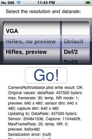

And this is how the GUI looks like:
It must be operated in exactly the same way as my previous, universal tweak. The screenshot above, as you can easily see from the messages at the bottom, shows starting the app in VGA (default) mode and, after switching to hi-res mode (on the left) and increasing the bitrate to 10 Mbps (on the right), saving the new values via the "Go" button.
NOTE: despite my vast efforts on making the tweaked mode as flawless as possible, the hardware is simply incapable of delivering fluid results. Nevertheless, if you do need substantially higher-resolution footage than in the default mode and are ready to sacrifice the framerate and battery life (not a problem if you, say, record a slow-moving lecture and can power your phone while recording), you'll really want to give it a try – it'll deliver MUCH better results.

Using the New, 4.3-specific Tweak
If you do want to stick with 4.3 (again, as has been proved above, you _really_ want to prefer 4.1 if you need the best possible image quality, unless you do need 4.3 for app compliance!), get the 4.3-specific version from my Cydia repo. The name is “3GS HiResVid (iOS4.3)” (direct link to the downloadable DEB file: http://www.winmobiletech.com/cy/deb...videocameraenhancerios43_1.0_iphoneos-arm.deb ):
Note the version I've released yesterday for iOS versions prior to 4.3 is listed directly beneath the new tweak.
This is the detailed view in Cydia:
Using the tweak is the same as with my previous releases. Here, there are three elements in the left picker, all corresponding to the three available video modes. Based on the above description, you'll now be able to properly select the right one best for the current subject lighting, distance etc. This is shown in the following screenshot:

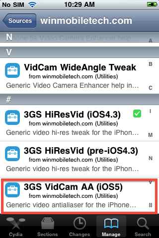

Cydia list:
(as you can see, the two iOS4-specific versions are directly above it in the screenshot, while the universal, multi-model, iOS6+-only "VidCam WideAngle Tweak" also supporting the AA mode of the 3G S is above the three of them)

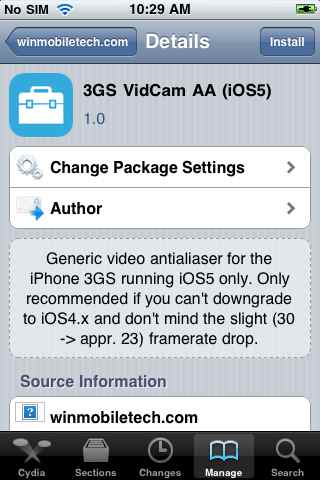

Detailed description:
Full source code: https://dl.dropboxusercontent.com/u...s/iPhoneWideFoVCamcorderEnhancer -3gsiOS5.zip
NOTE: as I've explained previously, under iOS5 and 6, on the iPhone 3G S it's not possible to oversample the sensor, unlike under iOS4. The only hack worth doing is exporting the originally VGA-sized sensor output at a considerably higher resolution, which results in somewhat better results - this is what my tweak does. Don't forget that doing this incurs a framerate decrease (from 30 to approximately 23). That is, only use this export mode if you're shooting little movement and not, say, shooting sports events.
