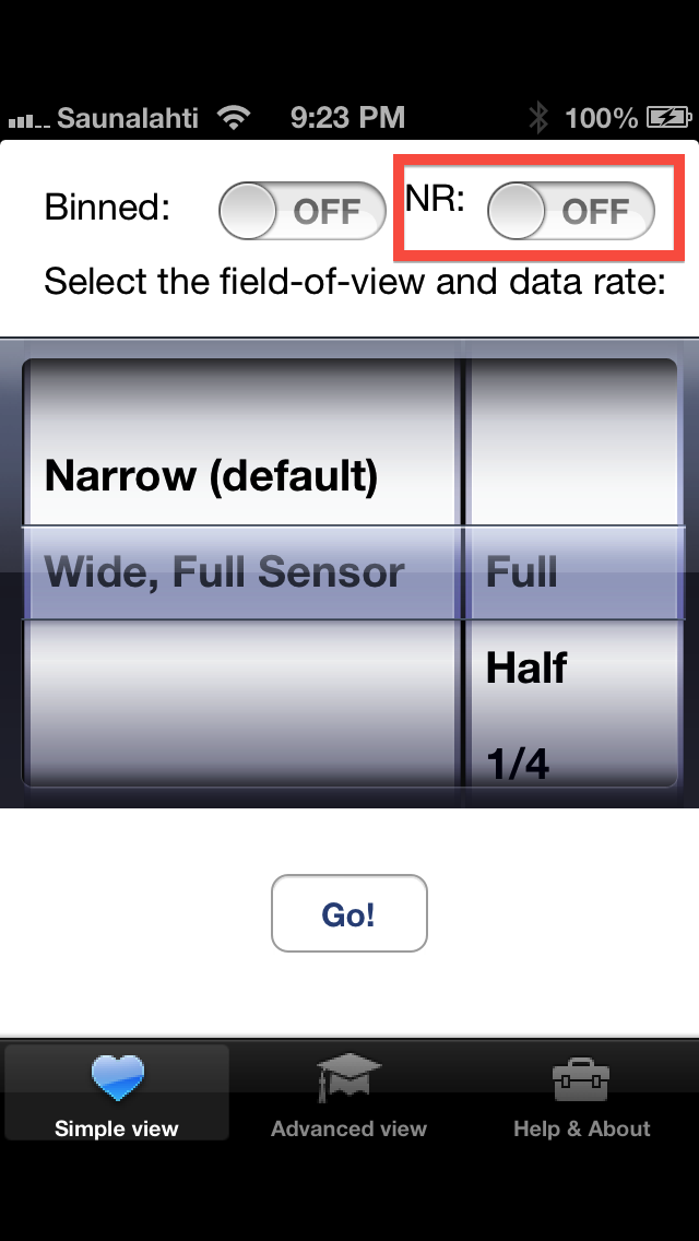

I've run several fps tests today to find out the effects of the different settings on the resulting framerate - all in full sensor mode, of course.
The results are as follows: never EVER enable noise reduction if you want tolerable (20 fps) framerates. That is, make sure the switch I've annotated in the following screenshot remains "OFF":
By keeping this in mind, you can shoot pretty tolerable wideangle, high-resolution 4:3 footage without having to use low-res modes (it's 4:3 modes up to and including 640*480 that provide almost as wide wideangle as my custom mode) or an external add-on lens. For pretty much static family meetings etc, it's sufficient - but, of course, not for action / sports shots.
Note: The framerate doesn't depend on the target encoding bitrate - it has absolutely no effect on the actual encoding framerate. It'll be the same if you select full / half/ quarter / whatever target encoding bitrates.

Now that I've found out why some of my recordings dropped so many frames (I've switched on the "NR" switch), I proceed to cleaning up the entire app, and, most importantly, the Advanced tab. Then, it'll be very easy to quickly switch between any kind of configuration (different resolutions, bitrates, NR / binding configs etc.) anyone can easily modify / customize.
