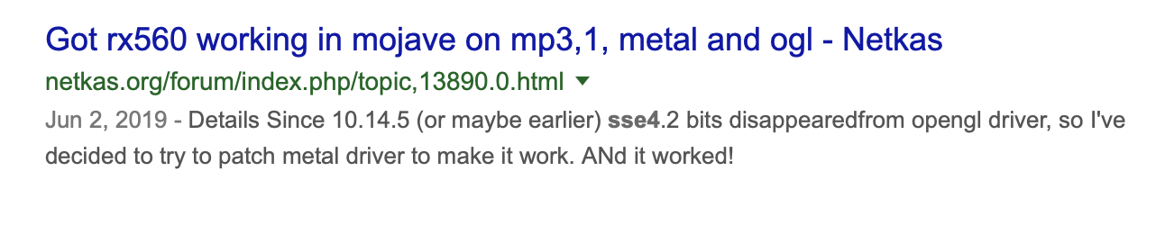

There was a thread on netkas forums about how he got the RX560 working, but I can't access the cached version b/c the forums seem to be down.
I'd like to find a way to run one of those on my MP3.1.
The thread about getting the 3,1 working with the rx 560 isn’t related to EFI boot screen that is being teased by MVC.
[doublepost=1560829931][/doublepost]@ferologics - I have the RX 580 working in my 3,1 now thanks to netkas’ efforts.
Dosdude1 added the patch to his patching tool, however at this point it’s not complete. You can either add a kext to fully disable code sign enforcement or you can try using “ldid” to sign the binary. Ldid would need to be installed via brew as it’s not included in macOS. Check out the last few pages (around 640 I think) of the Mojave on unsupported macs thread to see posts about this.

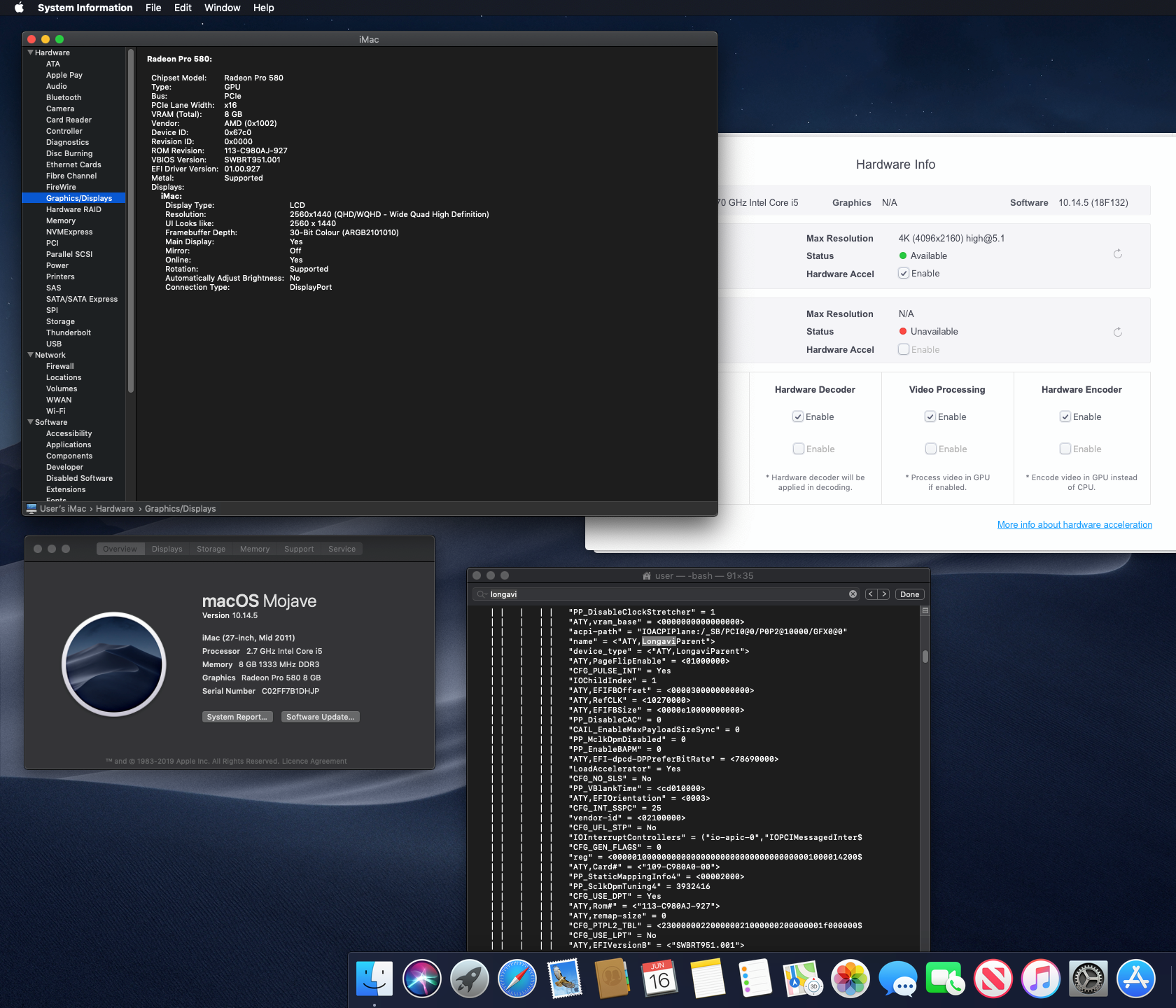

I wonder if they’re using a patched iMac 18,3 EFI (loading CoreEG2 etc)
that gives you boot-screens on Polaris / Baffin MXM cards in the 2010 / 2011 iMacs,
but these mobile vbios almost perfectly match the Longavi frame-buffer anyway.
Just a small update added to that blogpost:
UPDATE: To clarify, these cards are 95% done. Will be offering 580s for pre-order as soon as I remember how to add a product to the website. US MVC will be shipping within 2 weeks, barring any roadblocks .I believe our European partners will be onboard as well.
And a couple other tidbits from the comments:
- They will offer a flashing service for existing cards
- Boots properly and shows bootscreens connected to 4K monitor via DP1.2
