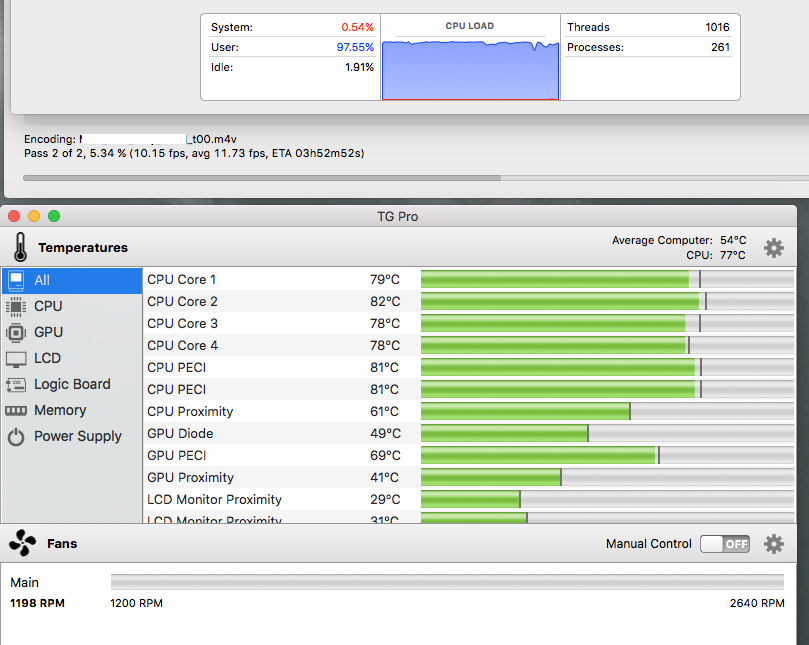

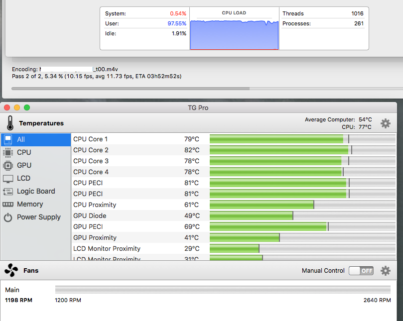

I can't personally speak for Skylake CPU's but here is my Haswell i5 3.4ghz. Its been encoding for about 20 minutes, max was 84 which is the highest it will get, intake air temp is 19.83c measured with an AprilAire weather station which should be within 1 degree F.
That encode is using the VerySlow preset btw so thats not a very accurate way to compare speed but I think its safe to say faster chips are faster... :)
