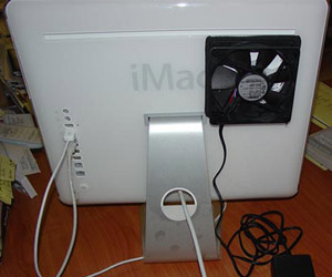

If this is really a big concern for you, than the low tech solution is to run a small fan, while you're doing heavy encoding. Back when I used to do a lot of Handbrake, I'd always queue up a big batch to run at a time when I wasn't sitting in front of my system. It'd get hot and loud, which is the nature of the beast. But I noticed that when I ran a very small fan on the back of the system, things would cool down considerably. And the noise of the fan was a lot quieter than the sound from the internal fans.
A low-tech $20 solution to ease your mind on the longevity of your $3,000 purchase. Again, not really necessary, but it's an option. And you don't need much of a fan - I've even heard of people running those little USB powered fans in the back of their iMacs. Only time you'd even need to think about this is when you've got a big batch encoding. It's amazing how much of a difference a tiny bit of airflow will make.
This looks like a good idea ;)
I hope this will give a better cooling and noise control on my new iMac next week.
Can you tell me how to put it on my iMac?
A better example than this?
I don't think you need to get overly complex about it. Any old tiny fan will do. There are some cheap USB powered ones in the $10 range that should be adequate. I've even seen some blade-less designs (ala Dyson) that are supposed to be quiet, under $20. Point is just to ensure the the warm air doesn't get trapped behind your system.It doesn't need to be on the iMac, just in a position where it can help air flow past it.
Thanks ;)
Once the new iMac comes I will keep you informed!
Of course I go first without external fan to see the difference.
Now, to find a suitable USB powered fan.

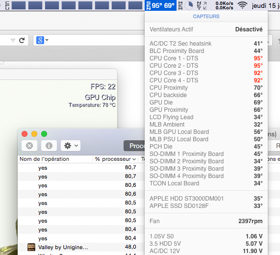

My final measurements have shown very clearly that the foregoing exemplary model, nevertheless had a problem around cooling.
As you saw in the 1st model at 100% CPU load, the Fanspeed (2850 RPM) runned continuously at its maximum.
In this 2nd model with a 100% CPU load, luckily the Fanspeed gets no higher than 2280 RPM. Also it strikes me at this 2nd model, that the cooling unit at 100% CPU load is now much less.
I can therefore say that there is enough reserve to cool the CPU and the noise level is also clearly calmer.
Finally I can enjoy this iMac i7 for its purpose, and I will not be stressed any more, because it is a much quieter running fan.
100% speedfan (bad cooling)
Speedfan (silent cooling with reserve)

The fan speed on the iMac at the office seems to vary a lot during heavy load of the CPU. I've been running a couple of processes for the past few days that take up 100% CPU on a Core i5 of an iMac 2014 5k Retina. For the first five minutes or so the fan speed ramped up quite a bit (the peak appears small in the 7 days overview because of averaging), but then settled at low speed again. Over the course of the days it occasionally ramps up before settling again. It varies from barely audible to the occasional noticeable humming, but that's in a quiet office environment. All the time the CPU was running at 100%, CPU core temperatures varied between 85 to 95˚C, the CPU proximity remained stable at 66˚C.
I was quit surprised to see the fan speed drop even tough the temperature remained high. And no, there was no case of thermal throttling of the CPU. It actually ran at a stable 3.7GHz, slightly above the baseline performance of the CPU. Not sure why the fans go down after a while, but if you are experiencing a lot of fan noise, maybe give it a couple of minutes for the system to reach some equilibrium.

If it can help you: my Late 2013 iMac (i7 3.5GHz) on heavy load:
And I don't like the GPU running at +100°C, because I've seen a lot of them burning to death... But I've never seen a modern CPU dying, by heat or something else: modern Intel CPU are rock solid and can stand 100°C without any damages. And they include a protection: if the temperature is close to the limit, they are shutting down themselves automatically before the damage ;)
