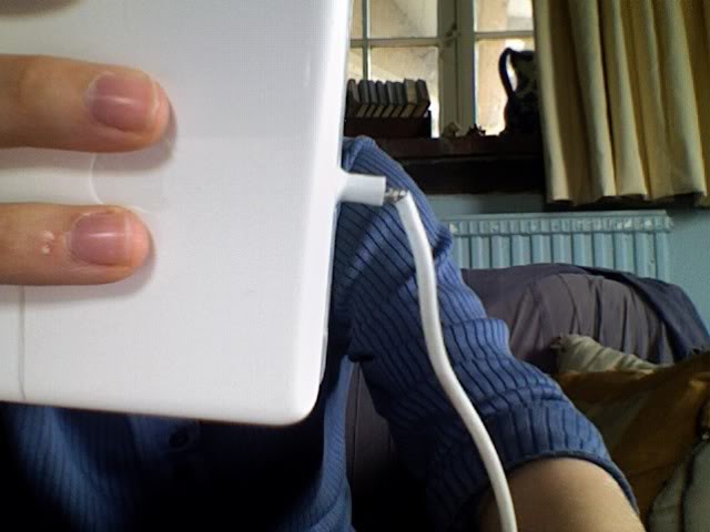

Heres the state of mine at the minute because i wind it up around the two little flippy arms:
Any ideas about what i should do. I doubt they'd replace it do you agree? I'm just a bit worried now.
