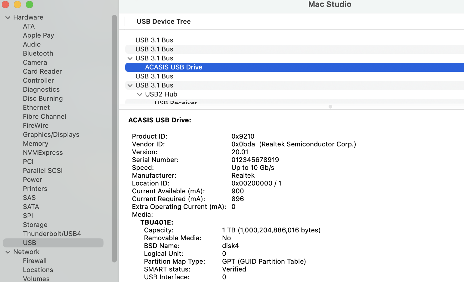

Hello guys, About a month ago, I purchased the Acasis tbu401e SSD enclosure and a 1TB Samsung 980 Pro. Many YouTubers and users recommended the Acasis tbu401e as it works well with the M1 Mac. Initially, the read and write speed in Blackmagic was around 2600MB/s, which I found satisfactory. However, Yesterday I noticed a decrease in speed when I copied files to the external SSD. Upon checking with Blackmagic, the write and read speeds were only around 900MB/s. With only 80GB of used space, I don't believe that the decrease in speed is due to the SSD becoming full.
I checked the System Information and found that the external SSD is recognized as a USB 3.1 device with a speed of up to 10 Gb/s, instead of a Thunderbolt device. I tried rebooting the Mac, unplugging and replugging the SSD cable, and open the enclosure reinstalling the SSD, but the issue persists.
I can't recall any significant changes made to the system apart from upgrading to the Ventura 13.2.1 operating system last weekend, which may or may not be the cause of the problem. As I rarely unplug the SSD from my MacStudio and it has been working 24/7, I'm uncertain if the issue is related to hardware. I'm hoping someone can help me troubleshoot this issue. If you have the same enclosure, can you confirm whether it appears under the Thunderbolt section in System Information? Thank you in advance for your help.
Update 20230217
I received a new identical enclosure and tested it today. Surprisingly, it also works with USB 3.1. This makes me suspect that the issue is with my Mac itself. However, I cannot find another Mac to test it with, so I need to figure it out on this one.
My Mac has two external monitors that are both connected to the rear thunderbolt port. I don't use the HDMI port because I can't control the monitor's brightness via I2C commands from HDMI, but I can with the thunderbolt port.
I unplugged one of the monitors and connected the SSD enclosure again. To my surprise, it was recognized as a thunderbolt device. I plugged in the monitor again and everything worked fine. The SSD was working at the correct speed. However, if I restart the computer, it doesn't work again, so I have to repeat the steps. My current solution is to switch one monitor to use HDMI and the other to use thunderbolt. This works fine after a reboot.
It's strange that the Mac doesn't work with all three thunderbolt ports simultaneously. I think it's a software bug because I've tested it and all the ports actually work fine with the SSD if there are only two connections. But a month ago, the Mac works for sure with 3 thunderbolt ports simultaneously..

Dual Chip:Intel® JHL7440 Thunderbolt™3 with REALTEK® RTL9210B
looks like is connecting with the Realtek which is the USB chipset. Wonder if the Thunderbolt part failed.

which thunderbolt is the ssd attached to?
the front ports on the mac studios withOUT the M1 Ultra are USB only
(rear are TB/USB).

There are known things issues if the total power load on the aggregate TB ports is too high. The issue goes away on externally powered enclosures

While this could be a reason, however it fails to explain two important points:
  1. This configuration has been working fine for a month.
  2. When I plug in the SSD first and then the monitor, everything works fine until I reboot. If it is a power issue, it wouldn't work at all I think~

Just the power on sequence is exceeding the power threshold, so plugging them in separately takes less power. It's probably checking the threshold more strenuously now with the TB/USB ports. I know there was a lot of changes in the device drivers for that...
edit: or it could just be a bug. :)

My monitor is LG 27up850, it only has a usb-c input, no thunderbolt output. but the video is interesting.. I will watch it

do you have a monitor directly connects to the mac via usb-c to c (no hdmi/dp adapter)?

Indeed, yes - 32" 4K NEC monitor connected with an USB C 3.1 (Mac Studio) to DisplayPort 1.4 (monitor) cable. It's a temporary setup until the ordered HDMI cable arrives. Why, do you think this could cause the problem?

yours is not directly connection, the cable includes an adapter to DP. However, for my mac, if I use c-to-c cable to connect a monitor (my monitor has usb c port), the ssd enclosure doesn't work as thunderbolt. If I use C-to-DP/HDMI adapter, the enclosure works fine. Looks like some inside conflict... anyway, you may try hdmi port to monitor to see whether the problem is solved.

Thanks for sharing your experience because that seems to have been exactly the cause here!
I connected the two Acasis TB405 enclosures for testing to my Intel Mac Mini with 4 unused TB 3 ports and indeed, the system profiler now lists both enclosures in the Thunderbolt/USB4 tab.
On my Mac Studio, TB port 3 is connected by TB3 cable to an external Aikitio SATA quad drive enclosure. Port 4 and 2 were connected with TB3 cables to the two Acasis, and port 1 via USB-C-to-DisplayPort 1.4 cable to the monitor. So, the Aikitio TB3 connection caused no disruption but the USB-C did, which must be either due to an inherent limitation (mixing TB with USB-C connections) of the Mac Studio's or the Acasis' Thunderbolt controllers.
I'd never would have thought of such a cause - quite a limitation for the TB ports!

Just as a final update...
So I purchased a new USB-C to DisplayPort 1.4 cable from Amazon - brand name "uni" and supports 8K@60Hz, 4K@120Hz, 2K@240Hz, 5K@120Hz, HRD, HBR3, HDR10, ARC, 32.4Gbps, FreeSync, G-Sync, MST, DSC. This cable was recommended in a forum as being compatible with the Mac Studio for connecting to a 4K DisplayPort monitor.
After running this setup for 2 weeks now I am pleased to report zero issues with the attached TB drives and the display being connected simultaneously. But initially even the "uni" cable did not work until I plugged-in the USB-C plug reversely, even though this should not matter with USB-C. It seems the Mac Studio has some rather funky UB-C ports - as also some USB-C cable plugs fit only loosely while others again are hard to plug-in. And it's definitively rather selective about which USB-C cables it will agree to work with.
