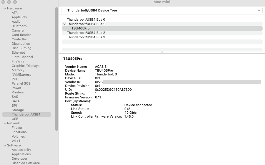

Hey Did some chatGPT and here is what helped me.
I had two monitors connected to thunderbolt port and the SSD casing to the other.
I switched it as 1 HDMI, 1 Thunderbolt (display), SSD casing for the 3rd and now it looks like that did the trick.
Before I tried switching the ports and it seemed to work with 2 monitors occupying two ports and the 1 port occupied by ssd casing. after shutdown and restarting it would go back to the same old setting of 10gbps (ssd casing).
now even after restarting and shutting it down 3-4 times I see that its stable at 40gbps/thunderbolt 3

Moving one display to HDMI definitely helps, it essentially removes that display away from the TB pool.
You current setup will only start to give problems if you add more bus-powered devices.
As for why a reboot would reduce the SSD enclosure to 10Gbps:
1) rebooting has specific, sometimes random, order of which the Mac decides to see the devices. It is very likely displays would be negotiated soonest since the headless computer relies on it, Apple would program their Macs behaving this way
2) as a result, at boot when 2 displays are already occupying 2 TB buses, the SSD comes as a 3rd device
3) the Mac at this point does not know it should release the port 1 and port 2 from the power pool, despite no actual power are consumed by those displays
4) if the 3rd device were a TB SSD, it simply should not mount
5) but your Acasis has dual chip inside, it has both a TB3 JHL chip, and a USB4 Realtek chip, so as a fallback solution the enclosure's USB4 connection can be recognized and negotiated with the Mac, but at reduced 10Gbps (USB3 gen 2). It is unclear why the Mac behaves this way, it probably has different logic for powering against pure USB devices, or that the Realtek USB4 chip consumes less power to the point it is just below what is allowed.
