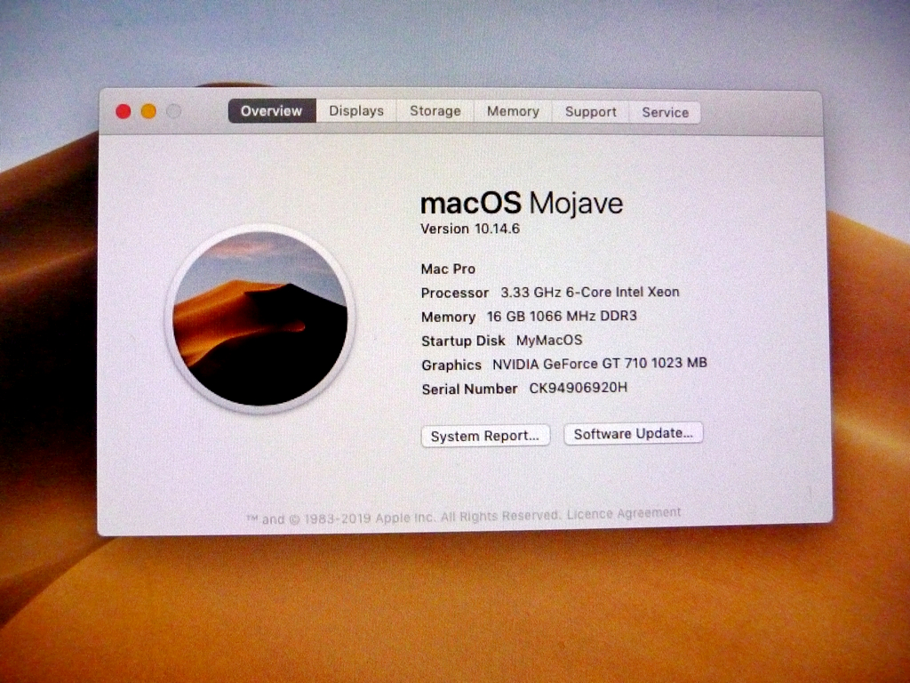

I have just got myself a Mac pro 4.1 upgraded to a 5.1. I was a bit mysified by the no-boot screen, but understand that's down to the graphics card... But it also has no W-Fi card, that's a bit of a bummer. I am running Mojave and thinks it's right that this does not support the old wi-fi cards, So I need a wi-fi card, there seem to be a lot on ebay, but what's good or bad? Any BCxxxxxxxx numbers I should look for?
In time I hope to dual boot windows 10, not sure if that works with no boot screen, or would opencore be a better way of doing it. One youtube video made it look so simple, other talk about patching, etc think I need to learn a bit more yet!!
Here's a couple of screen shots that might help you see what I have.

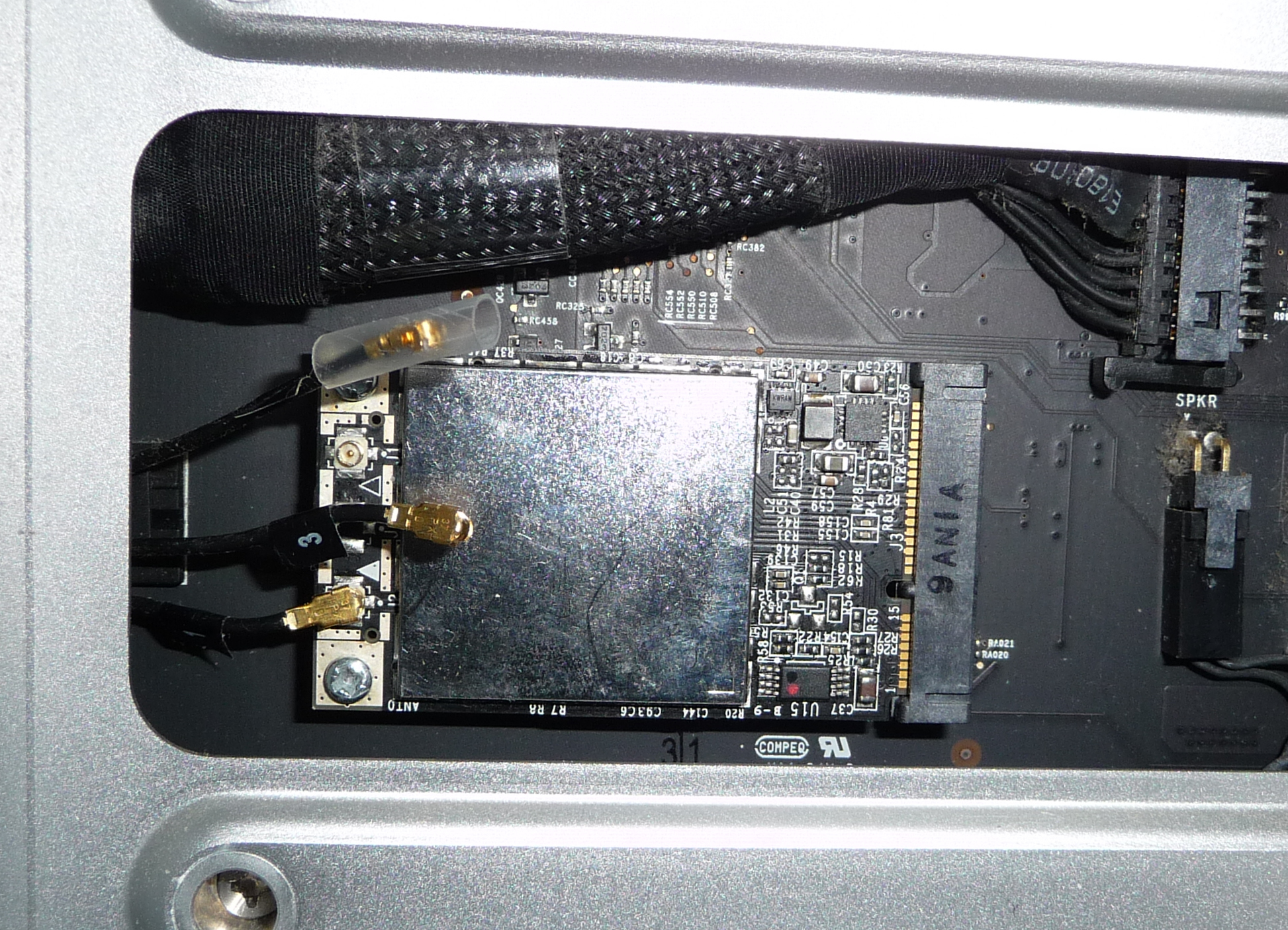

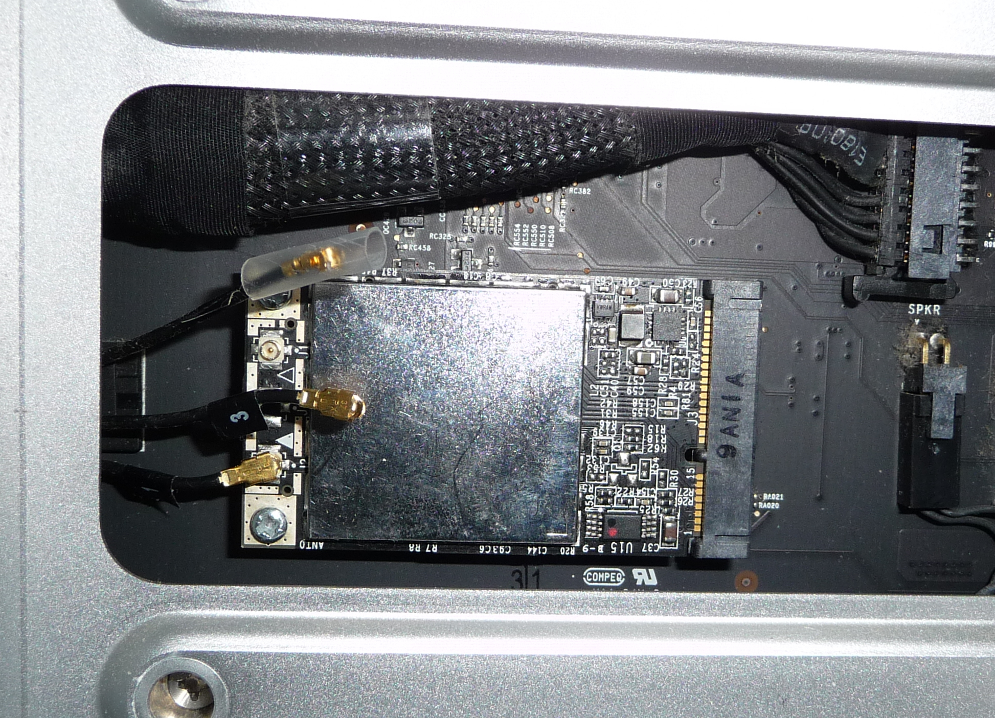

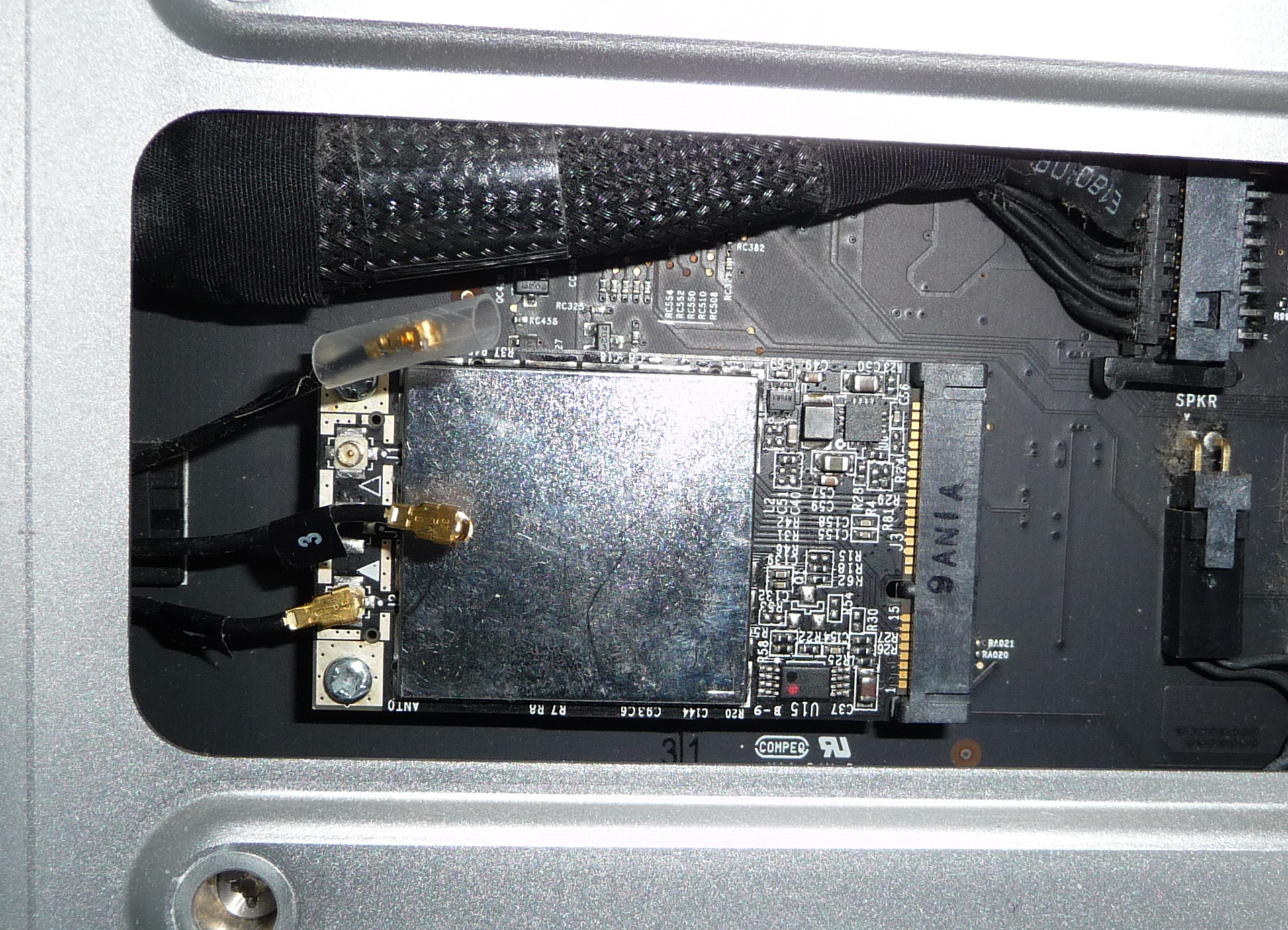

well my wireless card arrived today (very quick) and I installed it, but had trouble connecting the second aerial lead, and gave it a try without, and the connection is fine. I get a full set of bars. A few minor things I've got a white! mac keyboard and mouse arriving next week.
Yes I noted the memory was not the fastest I could use, perhaps 32GB would help, a better GPU yes in time...

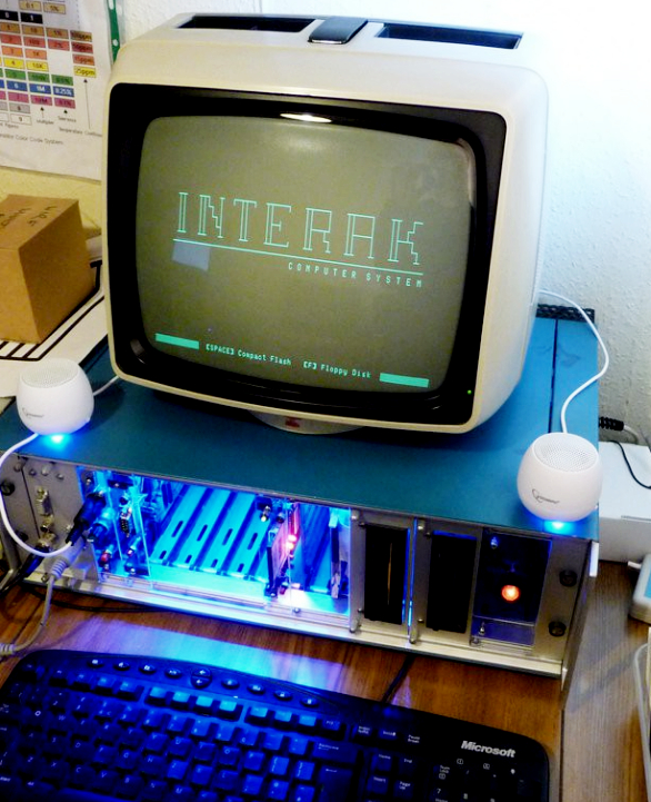

Here's a couple of pics, the other is my DIY Z80 system... https://hackaday.io/project/168104-...slrLPOT9_0maRE8MjxCljVLgEsdZt7Cpn5RYl5wko4xwc

Hi Mel,
Good to hear the airport card works, keep upgrading😉
Getting the antenna cables connected can be a challenge , been there.

The Z80 looks very cool, but the monitor is awesome!

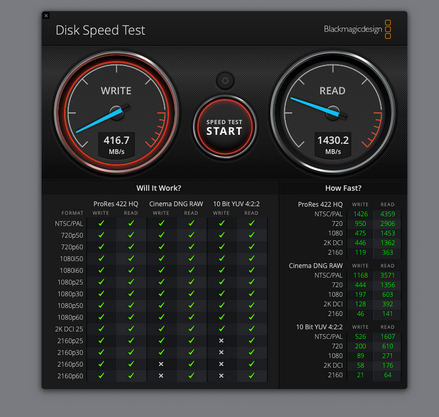

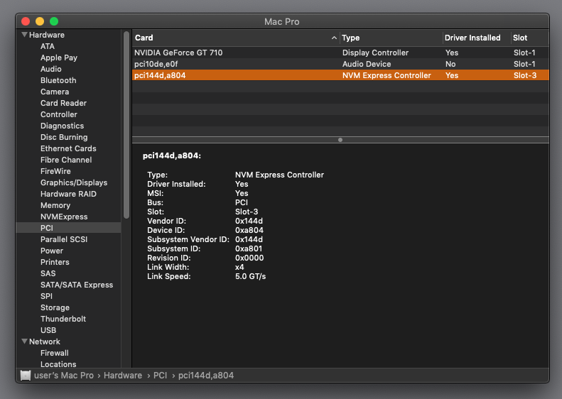

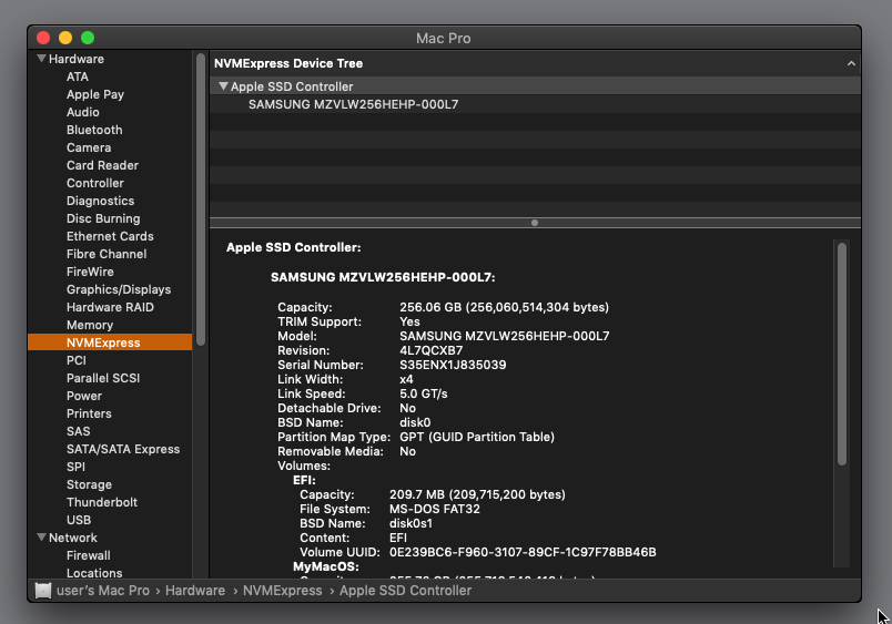

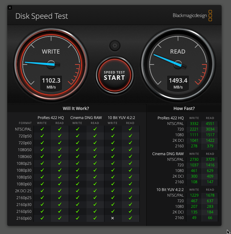

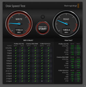

The Mac already has a PCIe drive it's 256GB, here's a speed test! what do you think? I have nothing to go by!! I have a GTX660 in the PC I could try that, how do people get Graphic cards flashed ?? Can I do it, done a bit of PIC and arduino flashing!!!

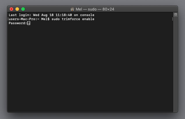

Hi Mel,
Write speed seems quite slow to me (usually R/W are both ~1500 = saturating PCIe 2.0x4 )
I don't know what blade it is exactly, but check if TRIM is enabled in About this Mac>system info> PCI
If not , open terminal:
sudo trimforce enable

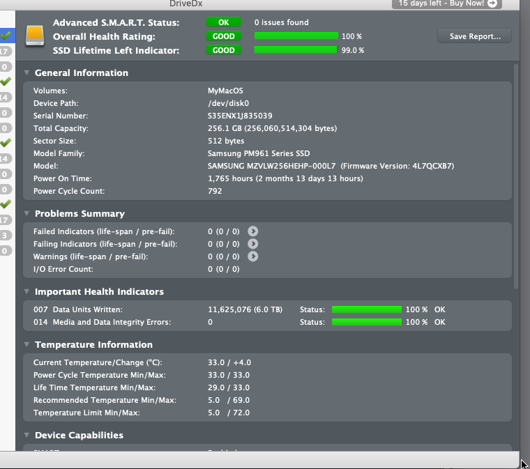

Another very useful app is DriveDX to check the health and status of your drives.

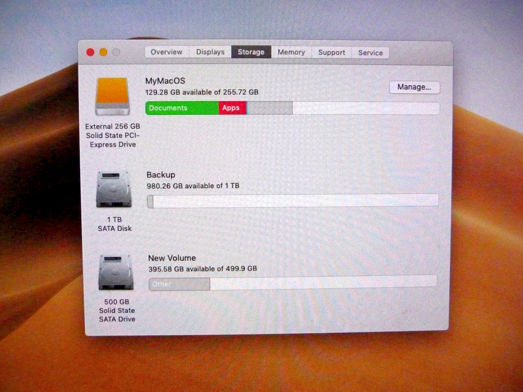

Yes I got DriveDX and it shows the drive has ran for 1700+ hours but healthy! The drive is on a very basic PCIe card, no controller or anything like that, so perhaps that could do with a change.(I assume a blade is a combo of drive etc) I found nothing in system, infact I don't think I found system info!! (Mojave) but can't see it anywhere? Ref TRIM.

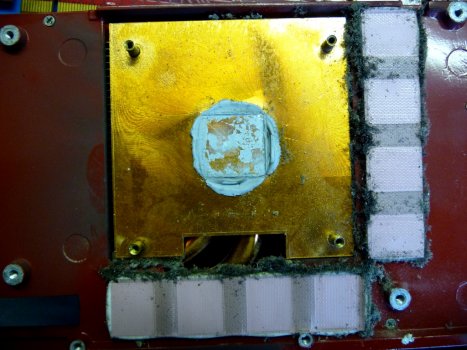

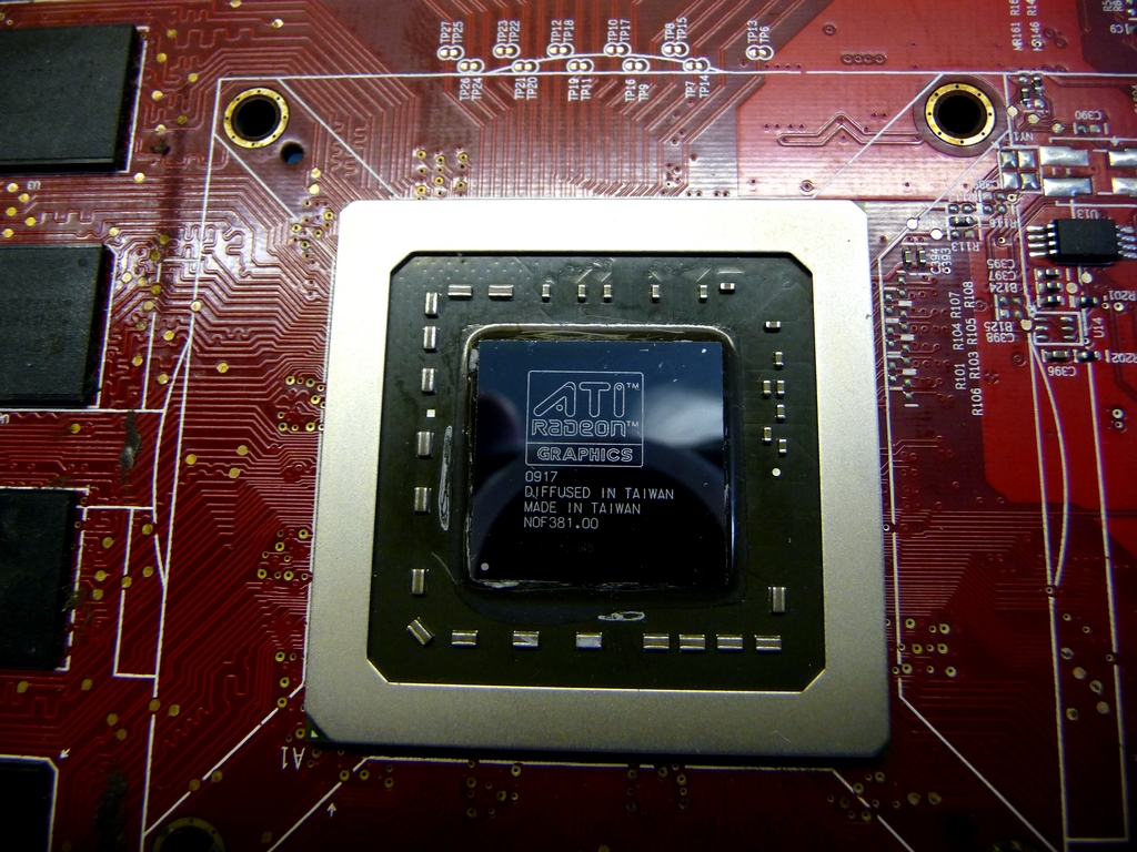

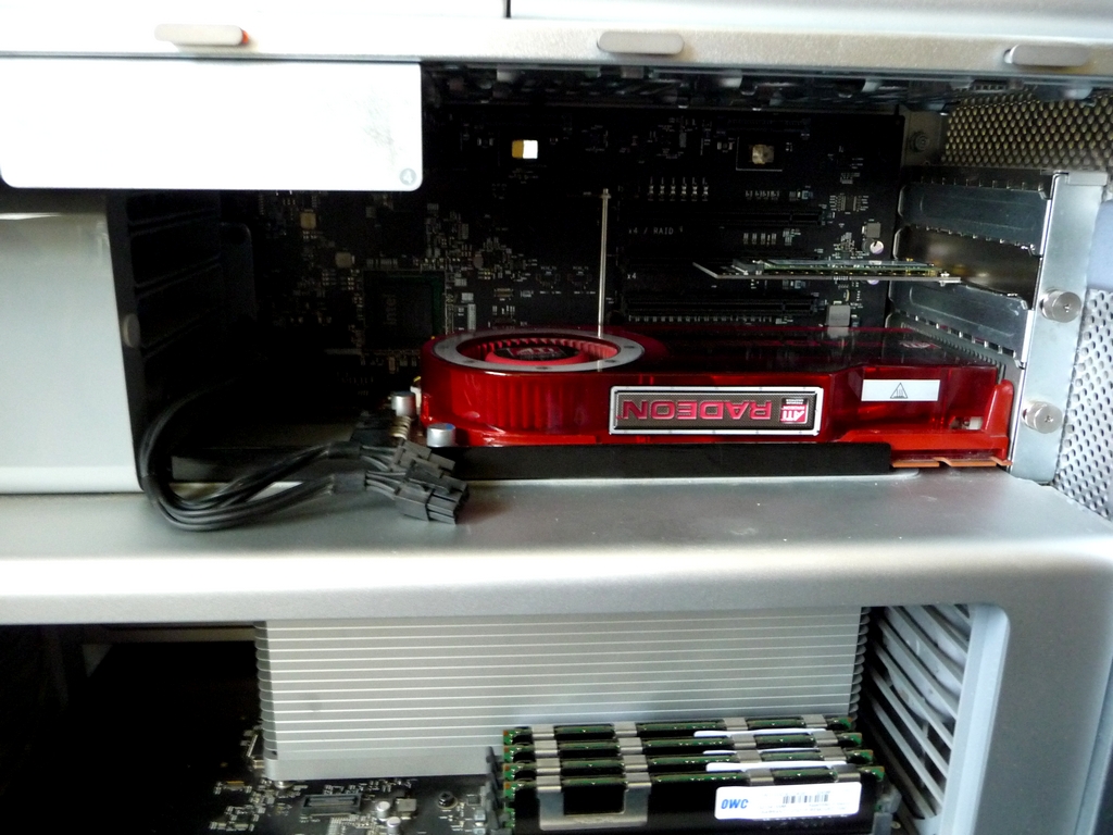

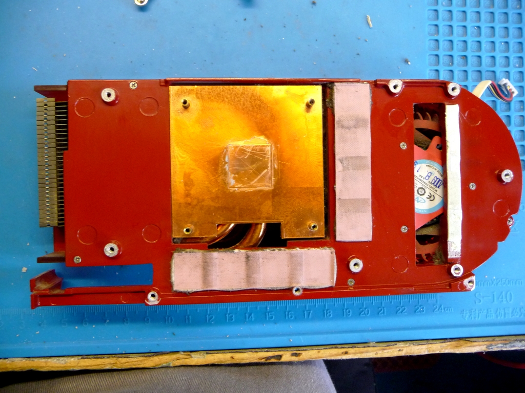

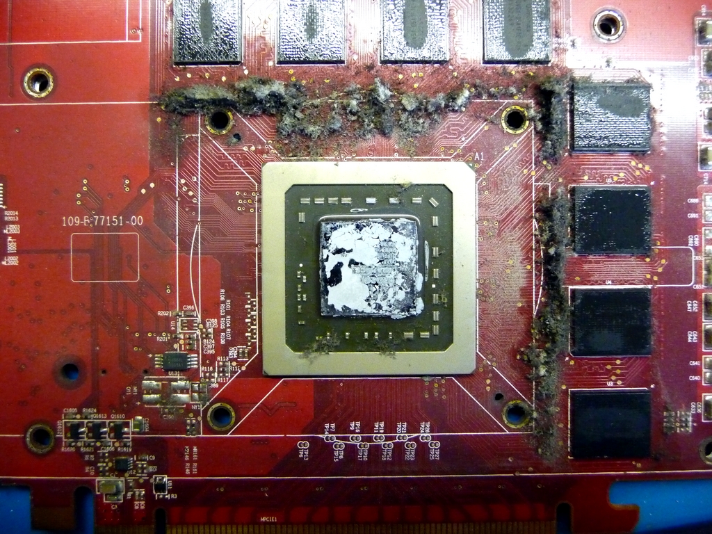

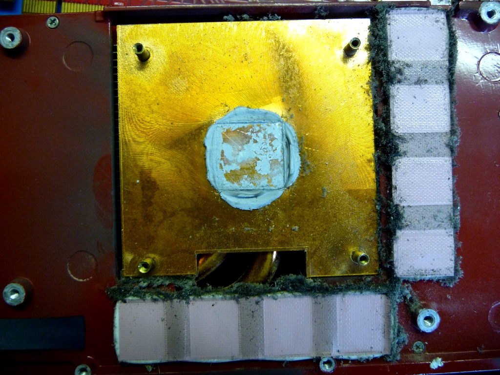

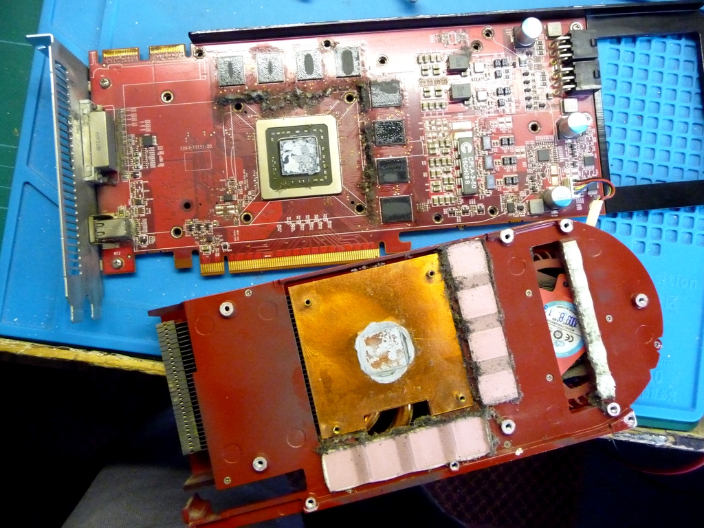

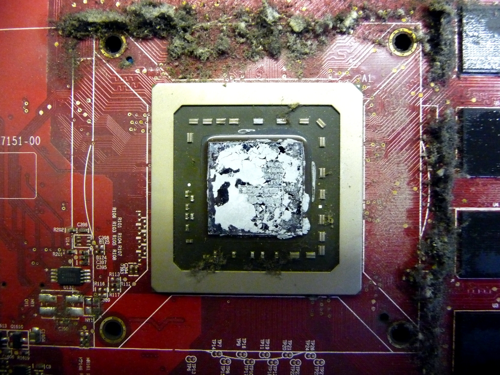

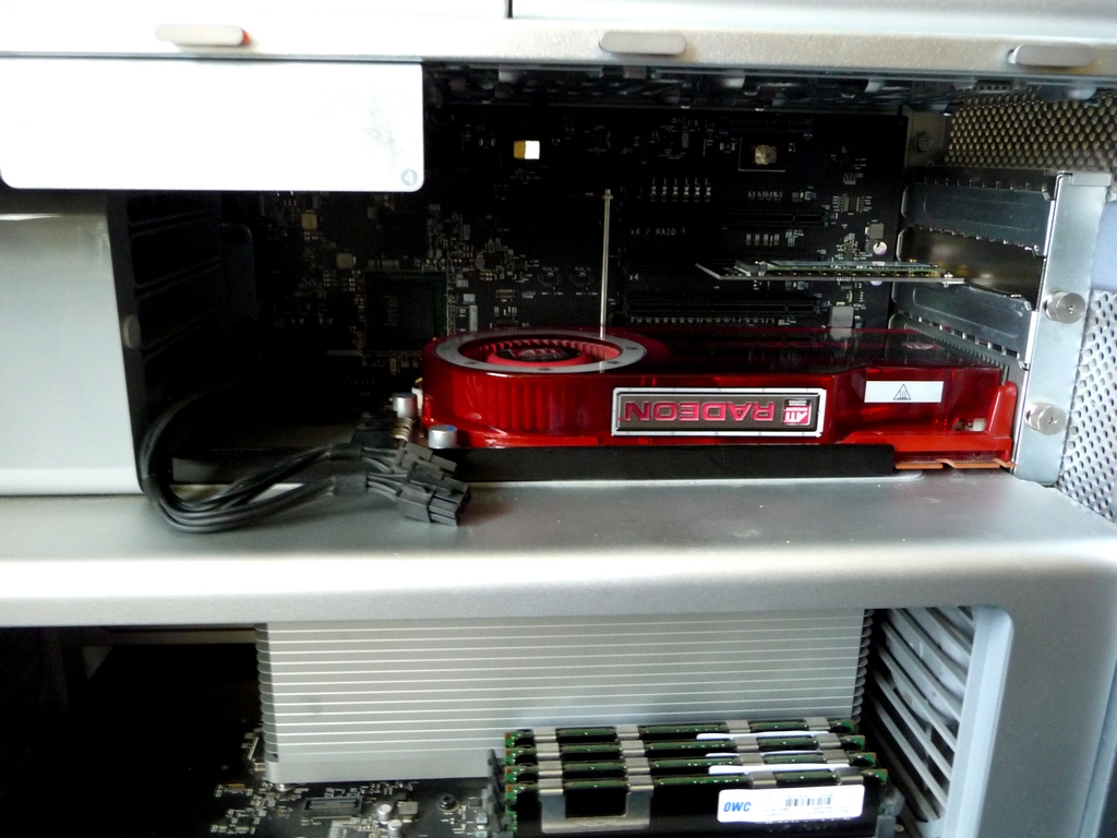

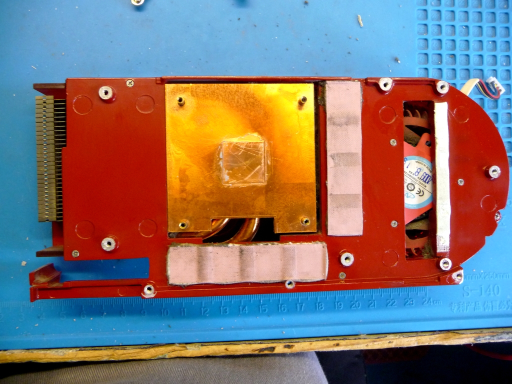

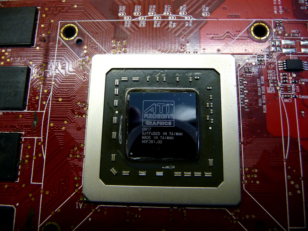

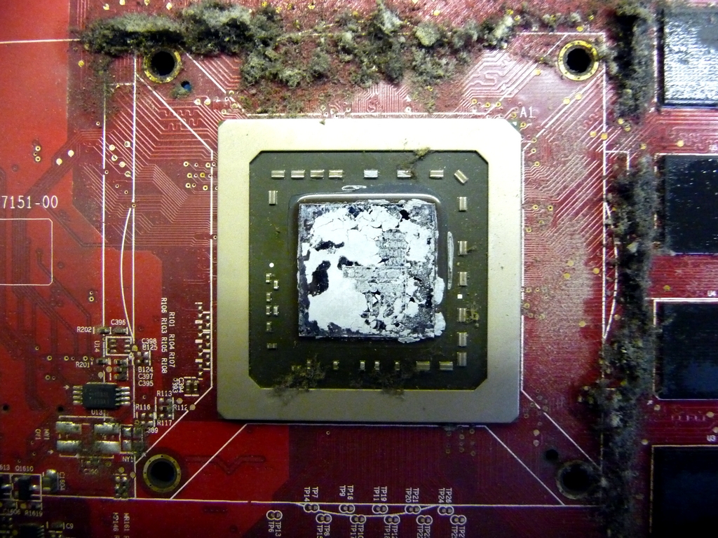

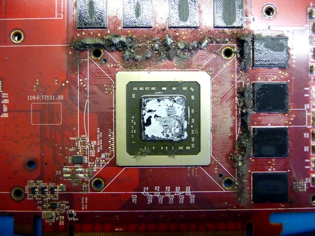

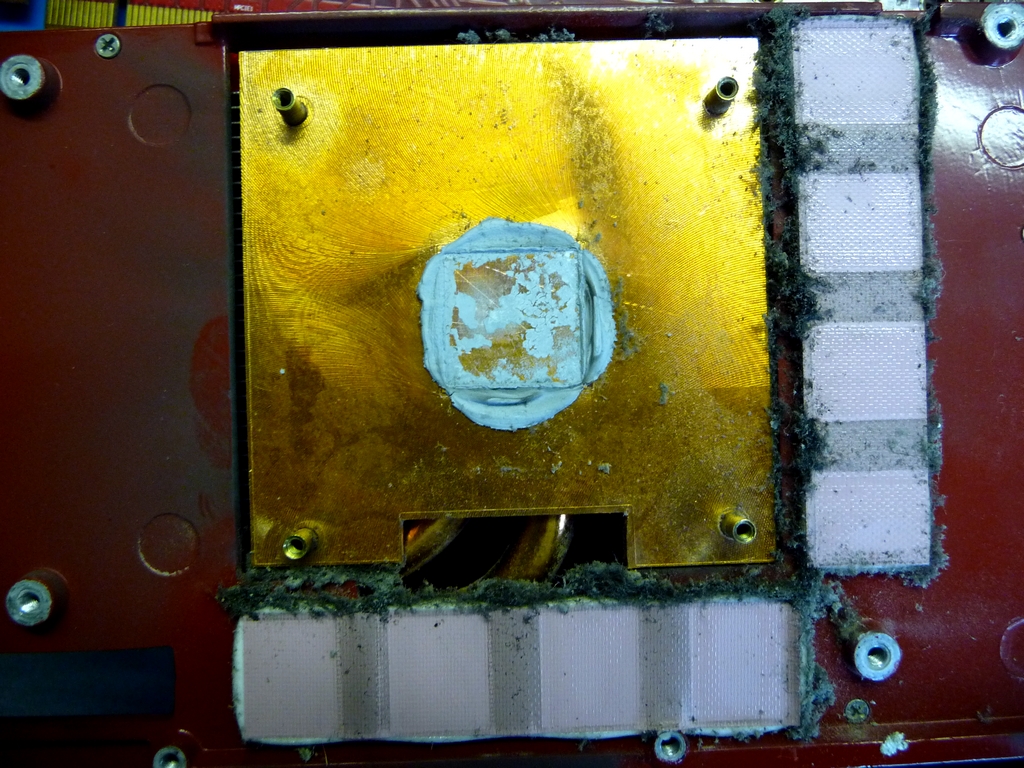

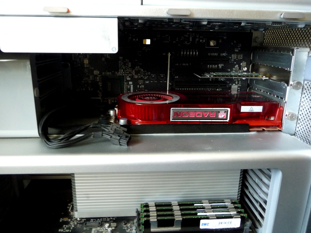

Last week I brought a ATI HD4870 for 99p that's less then 1U$D (I think?), sold as faulty as the fan was very noisy! So I gave it a try and yes the fan was going full speed. I removed the fan and heatsink to find the thermal paste solid, like cement, cleaned it up added some new and OK, BUT the fan was still going full pelt!! I removed the extra power connectors and it's been running fine, even with videos/youtube, photo editing, etc. Is it safe to leave it like this??
More pictures...Screenshot 2021-08-15 at 12.25.36.pngScreenshot 2021-08-15 at 15.54.23.pngScreenshot 2021-08-15 at 12.25.36.pngScreenshot 2021-08-15 at 15.54.23.pngHD4870-01.jpgHD4870-02.jpgHD4870-03.jpgHD4870-04.jpgHD4870-05.jpgHD4870-06.jpgHD4870-07.jpgHD4870-03.jpgHD4870-04.jpgHD4870-05.jpgHD4870-06.jpgHD4870-07.jpgHD4870-01.jpgHD4870-02.jpgHD4870-03.jpgHD4870-03.jpgHD4870-03.jpgHD4870-03.jpg

Sorry my mistake, look at NVMe in system info.
A blade is a NVMe SSD.
You could also check under SATA since you have another SSD installed ;if TRIM is enabled it's for all SSD drives.
A controller isnt needed: the NVMe blade is connected directly to the PCIe slot through a PCB.
The HD4870 is a nice find to tinker!
Unfortunately it's not Metal compatible, so it will not run/ run without acceleration under Mojave though...
Personally I would never run any GPU without all 6/8 pin power connectors connected.
Besides the probability to destroy the card, in this case all power is drawn from the PCIe slot.
I'm actually surprised it works.
The HD4870 is rated TDP 150W, but the slot is rated at max 75W...

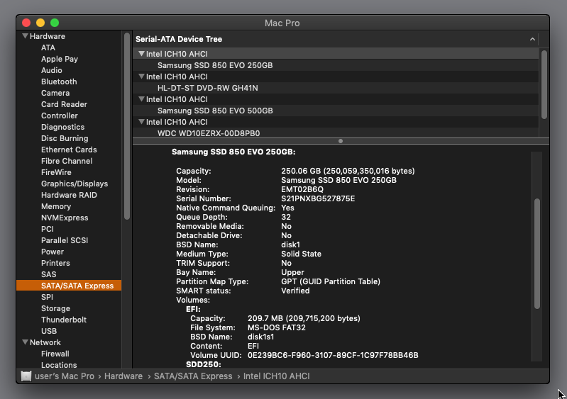

It looks like TRIM is enabled for the PCIe SSD but not the others, which seems kind of strange!
I tried the HD4870 and it seems OK, gives me a boot screen that I'm sure will be useful at some point.
I downloaded an on-line shooting game, to test the cards and the difference now shows, the HD4870 is pretty useless for anything like that.

Hi Mel,
I guess the NVMe is an Apple SSD , and thus automatically with TRIM enabled.
For 3rd party SSDs you have to use the terminal command.
If you set up the new user account with admin privileges, the command should work.
Note that when you write your password in terminal, it shows nothing, so just "blind" type password and press enter.

IINM Apple used a PM961 too, and this would be the only possibility to have TRIM enabled on this drive and the SATA SSDs not....
Anyway, I would check TRIM for all SSDs and if not activated for all yet, use the terminal command.

I've just been reading a lot about setting block sizes etc : very interesting, but finding a hands-on howto isnt easy apparently...
Looking at the specs of the PM961 Write speed is rated at ~1100MB/s.
Now benchmarking the blade with larger files e.g. 5GB, could it be that the result as posted by the OP is normal, due to filling the cache completely and/or wear?
@Cactusface : could you maybe run Blackmagic set to "stress 1GB" and see what happens?

Thanks for your input! followed your instructions and it came back with 4096 so 4K which I believe is right.
But Kees when I ran BlackMagic it was already set to stress "5GB" I'll rerun the test at 1GB and see how it goes!

HI,
Well changing the stress to 1GB made quite a difference to the write speed test as you can see! I'm happy with the back up disk on HFS+ I'm now going to look at getting windows running on the Mac, may try the easy way first? But which is that? Bootcamp don't seem to work with this Mac Pro! Surely windows will need some support and drivers for the Mac hardware?

Hi Mel,
Looks like the PM961 is working fine!

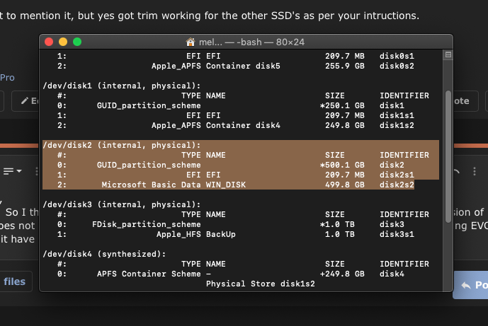

BTW: did you succeed in setting TRIM for the SATA SSD?

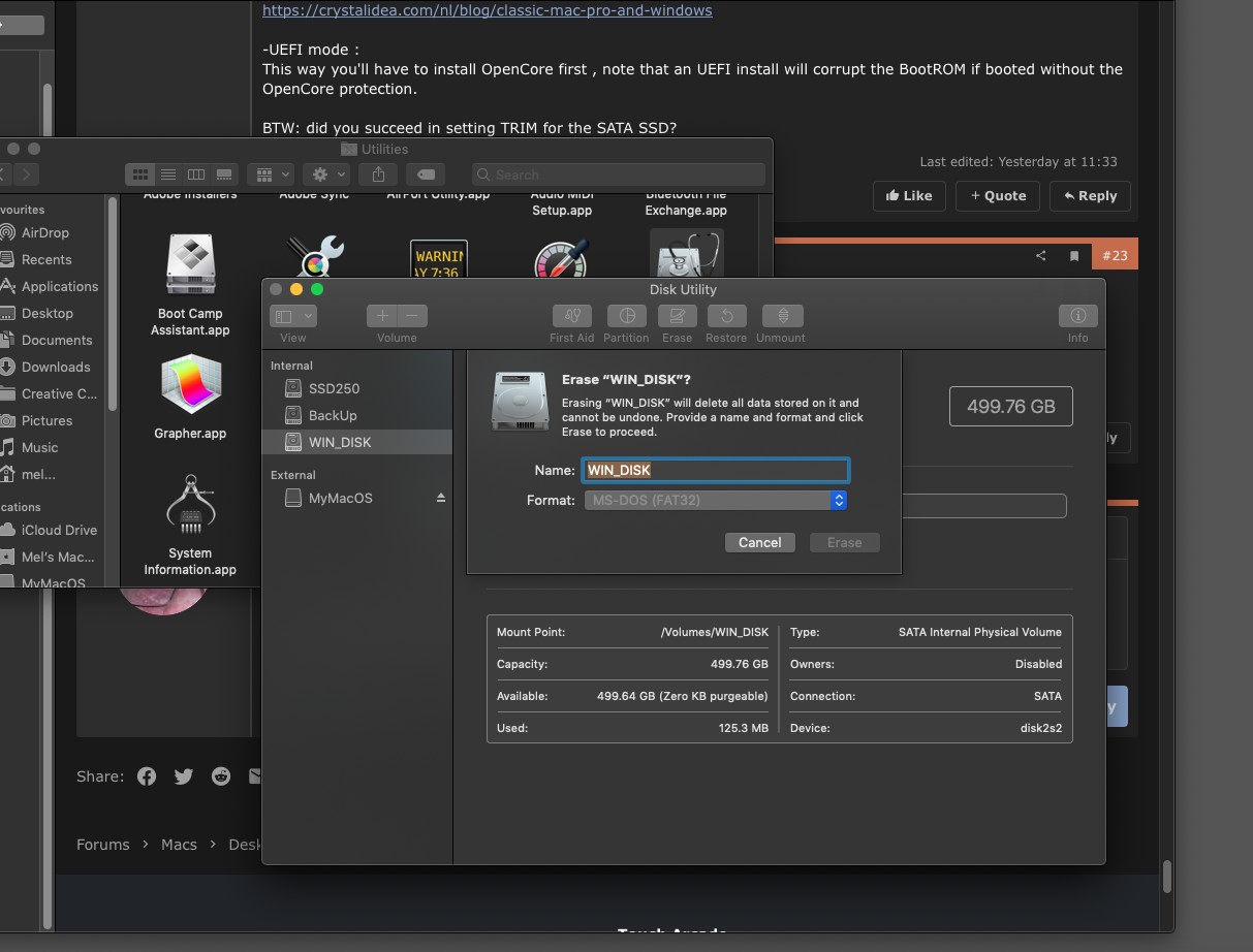

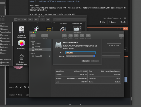

Hi Dayo,
So I thought I'd try your way of installing and running Windows, all OK so far but my version of Disk utility does not give me the choice of setting the System file type, and I end up with a GUID and not MBR
type, Screenshot 2021-08-23 at 19.32.29.pngScreenshot 2021-08-23 at 19.34.47.png
but I am hoping to use a Samsung EVO SSD, or does it have to be a HHD?
Any Help!!
Mel

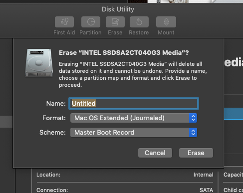

it's getting risky with GUID !
At least make a Firmware backup to get rid of the certificates.
Macschrauber's CMP Rom Dump.dmg
this is my tool for it, the plus is it probes the chip and do some analysing of the rom health.
for formatting mbr you should show all volumes in view - and use the button "erase", you stepped in the trap almost everyone steps.
