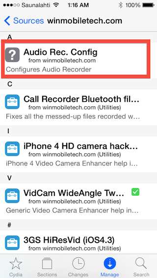

My app is in my Cydia repo at http://winmobiletech.com/cy/ :
After installation, the tweaker can just be started via its “ConfigAR” icon on the Springboard. The GUI:

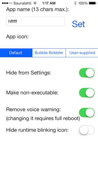

From top to bottom:
- in the uppermost textfield, you can supply a new appname, should you want to rename the file. NOTE: you can't use other “renamer” Cydia tools for this because the dylib file also need to be patched to point to the new file. Here, I've supplied the new name “hfffff”.
After entering a new name, tap “Go” on the right to patch the system and, then, before making any other call, reboot.
- the segmented control below lets for changing the app's icon. The leftmost uses (restores) the original icon, the center one an icon delivered with the DEB file (the (in)famous Bubble Bobbler disguise icon), while the third lets you upload and use your own icon. Just make sure you copy the icon named 'myicon.png' to /var/mobile/Documents/ConfigAR/ before using the latter option. If you don't, you can still safely switch between the first two options.
- Below that, you can hide the AR settings from the system-wide Settings. (See my earlier, specific version of AR at https://forums.macrumors.com/posts/18613120/ (see the entry on “Bubble Bobbler 3”), which did the same. Now, no separate version is needed as you can do the hiding and unhiding from my catch-up configurer.)
Make non-executable” makes the springboard app non-startable by the user. This also raises the “disguise” factor. Recording will still take place, of course.
Remove voice warning” is the most important feature – it removes voice warning implemented in the original AR. Just make sure you enable the switch and reboot – after that, no warnings will be played.
Finally, “Hide runtime blinking icon:” lets you hide the runtime blinking icon on the Phone screen (also see https://forums.macrumors.com/posts/18692104/ )
