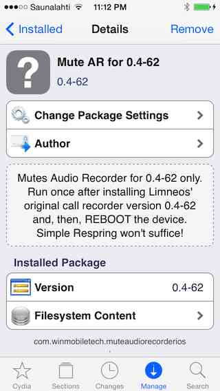

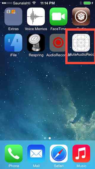

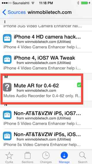

4. Some screenshots:
Cydia detail page
Cydia list page
Springboard - annotated is the icon of my app

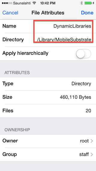

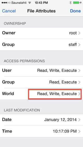

The reason for this is simple: the second approach would have required a flag setting of to o+w of /Library/MobileSubstrate/DynamicLibraries either manually, via, say, SSH or iFile:
or via the standard pre/postinst debian file:
chmod o+w /Library/MobileSubstrate/DynamicLibraries
This (theoretically) could have increased the vulnerability of the system; therefore, I've voted for the lengthier but safer code.

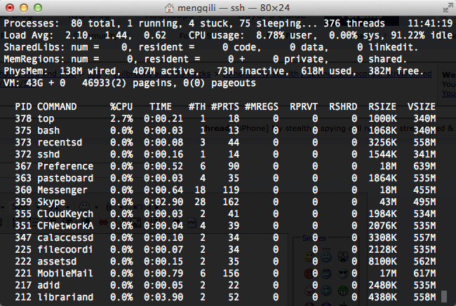

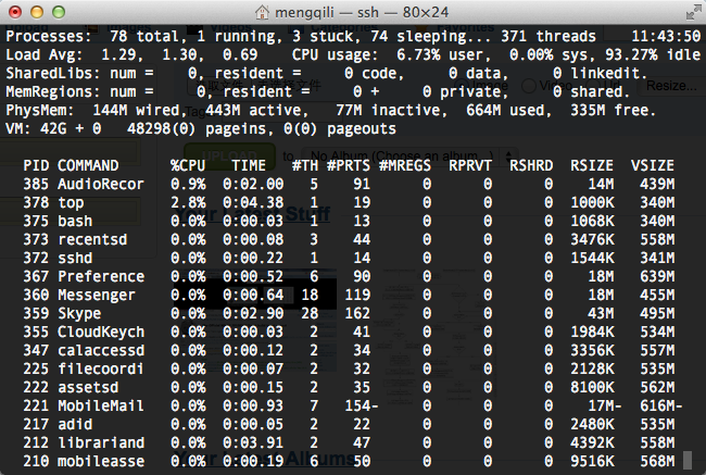

Is AudioRecorder.app consuming too many rams? I always open 4 or above apps on iPhone 5s, these apps stay in background and never quit, but after opening AudioRecorder.app, the background has just 1 or 2 apps remaining, I have to see the start screen every time I open the 3rd app.
On 32-bit platforms, no such problems are present.
A shot of a freshly booted-in system:
http://www.flickr.com/photos/33448355@N07/11964066066/
No sign of AR.

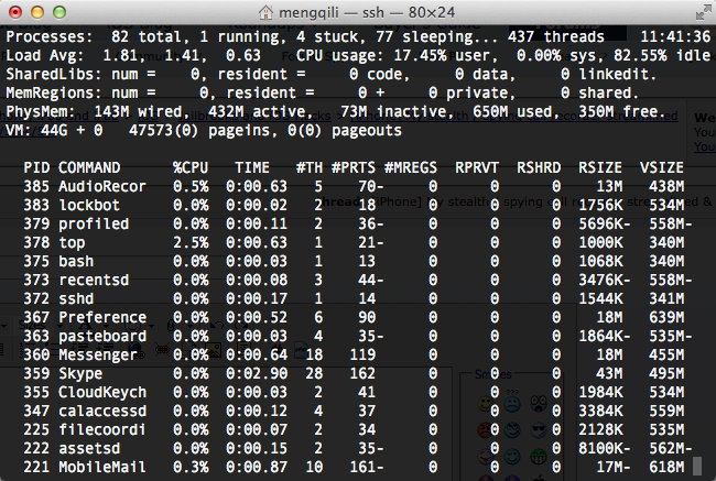

And after starting the AR interface, with some 10-15 recorded calls:
http://www.flickr.com/photos/33448355@N07/11963526653/
As you can see (and is also annotated), 12M RAM is occupied only.
You'll really want to use "top" to find out the memory usage on your own system. Feel free to post a screenshot of the full "top" result.

thanks, I will try it later. Maybe it has recorded too many calls (at least 50 plus), and hours long...
OK, make sure you post at least two screenshots: one after rebooting (w/o starting AR) and another after starting the app.
