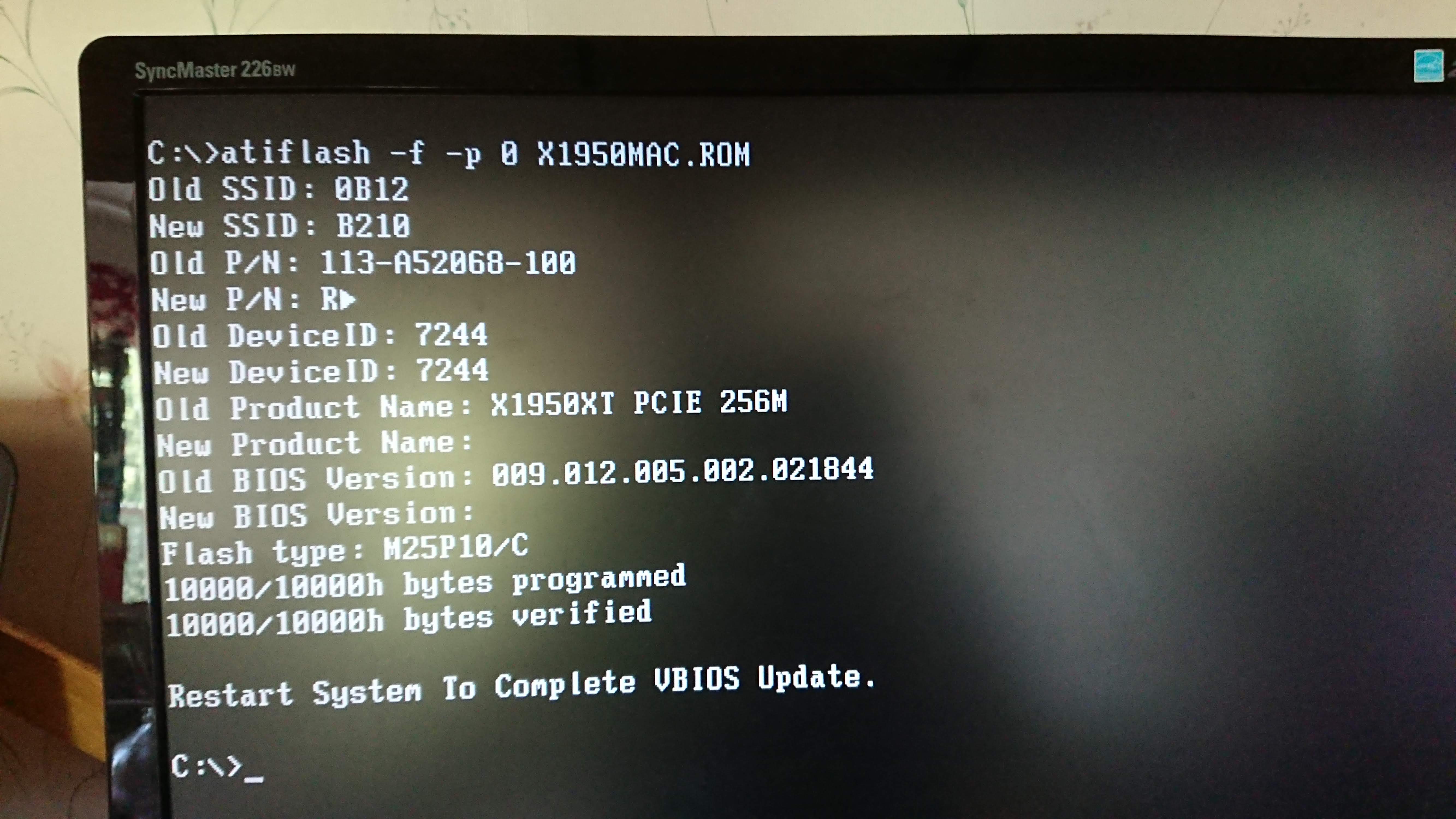

I'm trying to flash a Radeon X1950 XT for my DC 2.3GHz PMG5. As usual, this seemed very easy and straightforward in the beginning, but has now become a blackhole of suffering that has devoured about 8 hours of my time and a small chunk of my finger.
For starters, I'm using the PPC VBIOS I found on this macrumors thread: https://forums.macrumors.com/threads/flashing-a-fx4500-for-a-g5.1556317/#post-17066824

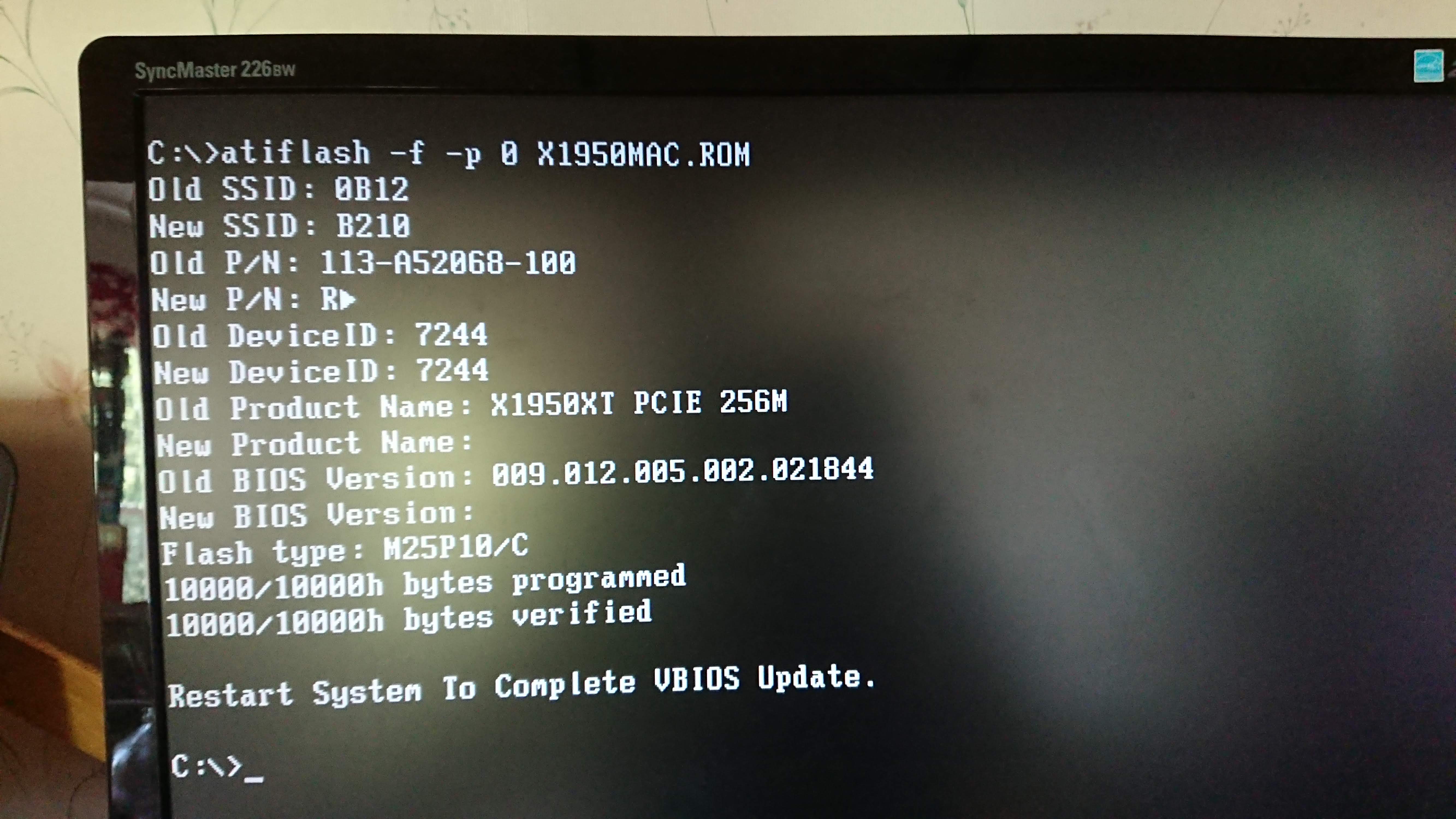

Initially I was using FreeDOS on a bootable USB and ATIFlash 3.99. I backed up my rom, and did a blind flash in a Dell Optiplex 7010. It didn't work, I put it in the G5 and the fans spin up to full speed without anything being displayed (it did bong though).
At this point it wouldn't display anything anymore in the Dell 7010, so I switched it to an old HP with onboard graphics. Tried flashing it again with the same result.
So then I thought "Hey, maybe I need MS DOS and not FreeDOS" so I formated my USB and installed MS DOS. Unfortunately, I (foolishly) forgot to copy over my backed up rom before doing that so there's no going back now.
I tried again, with MS DOS (IDK what version, I used Rufus which can automatically make a bootable DOS USB) and the result was the same. Here's a screenshot of what ATIFlash says after flashing, it would seem the flashes are successful so IDK what the issue is:
The reason it shows so many fields changing is because I had just successfully flashed a stock PC X1950 XT rom I found online.
I'm using ATIFlash 3.99 because anything newer gives me an error about insuficiant extended memory when I try to run it. I booted the G5 with the GeForce 6600 in Slot 1 to see what it would say about the Radeon, you can see the results of that below:
So, after about 8 hours of trial and error and filleting my finger pretty good on one of the dozens of times I moved that GPU out of the PC and in the G5 for testing, I gave up.
If anyone has some tips/advice I'd really appreciate it :)

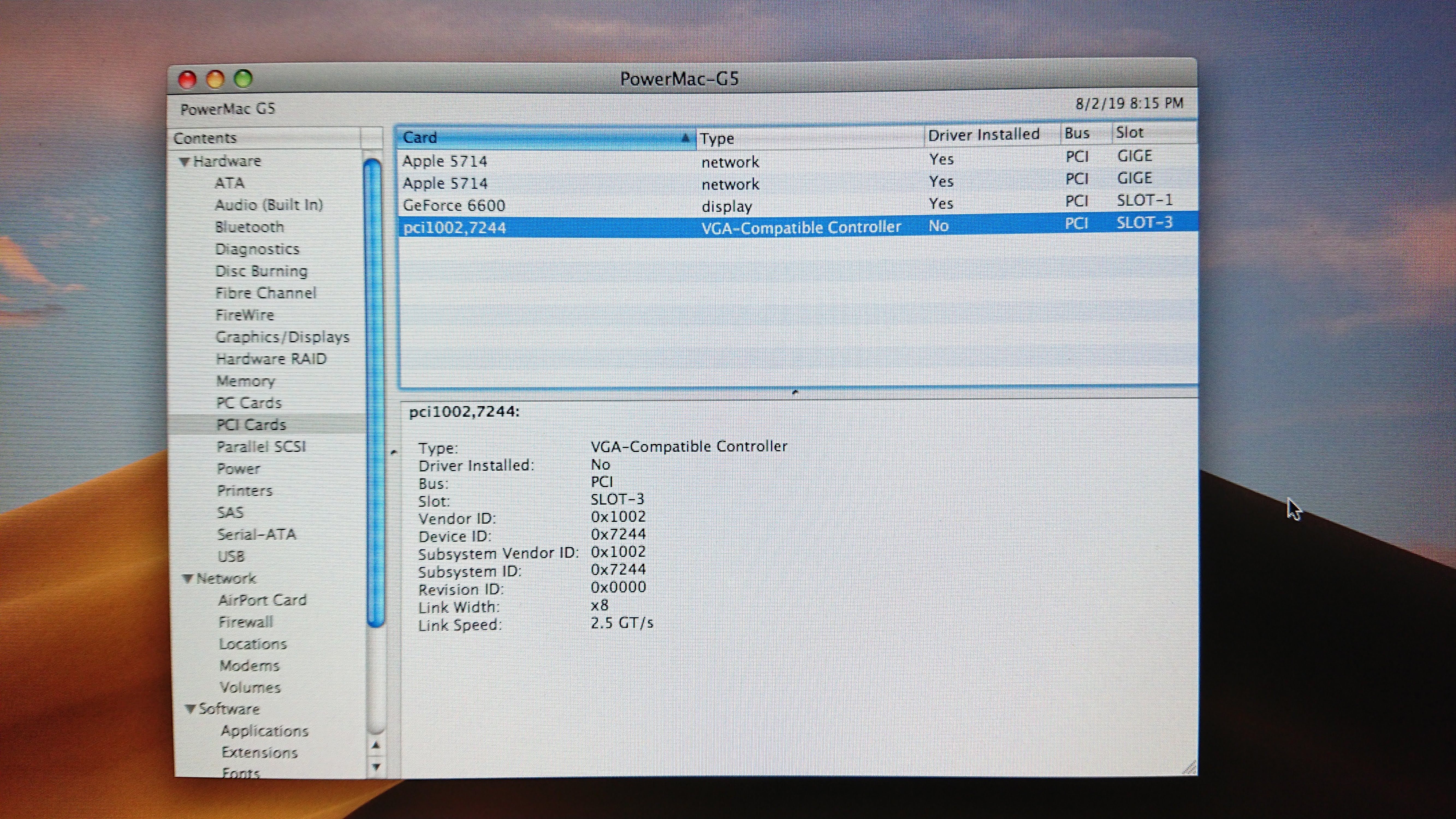

This just got more perplexing...
I don't know for sure, but try this rom.....
With this ROM flashed, the G5 doesn't bong and when it's in with the 6600 it doesn't even show up in the Graphics section of System Profiler. It's listed in PCI as a VGA-Compatible Controller.

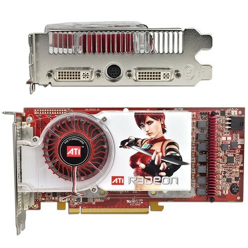

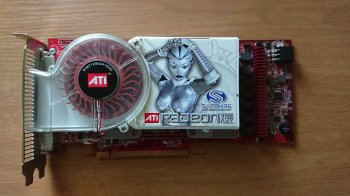

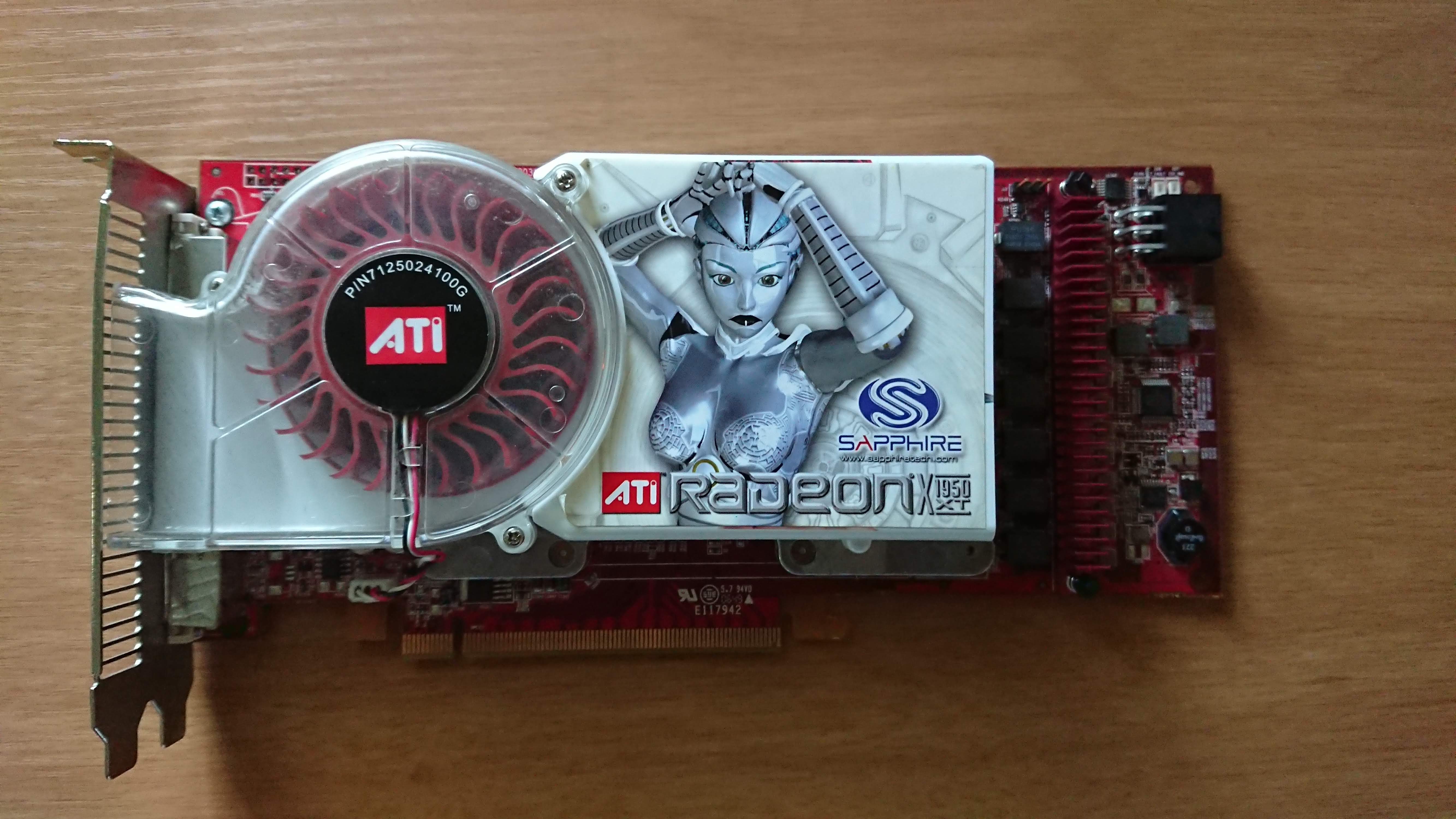

Is this what your card looked like? I'm pretty sure I read that the robot girl was the right card:
The Macintosh Garden copy of the ROM behaves exactly the same as the copy I get here with one exception: the G5 doesn't bong with that ROM flashed (it did with the macrumors ROM). I tried flashing in a PC with a PCI GPU (something from the Radeon 7000 series I had lying around) and that didn't change the behavior of ATIFlash or it's effects at all.
This has me absolutely stumped.
That's the right card. I rather suspect the MG has the Intel version of the ROM as some people used the X1950XT on their hackintoshes back in the day.
This is the card I flashed and still proudly have, no doubt. You got the right card!

THAT DID IT!
I used Rufus to make a FreeDOS USB, put a Radeon 7000 in the PCI slot, set the graphics to PCI in the BIOS of my old Athlon 64 based HP Pavilion, and used ATIFlash 3.89 to flash the ROM from MacRumors to the card. I actually didn't need HDPMI32.EXE since the versions of ATIFlash prior to 4.xx work without it.
Getting to the boot screen takes a bit longer now, but everything works perfectly and the card scores 16,040 in OpenMark. It was a long road, but I couldn't be happier with the result. Thank you to everyone for their help and suggestions! :)

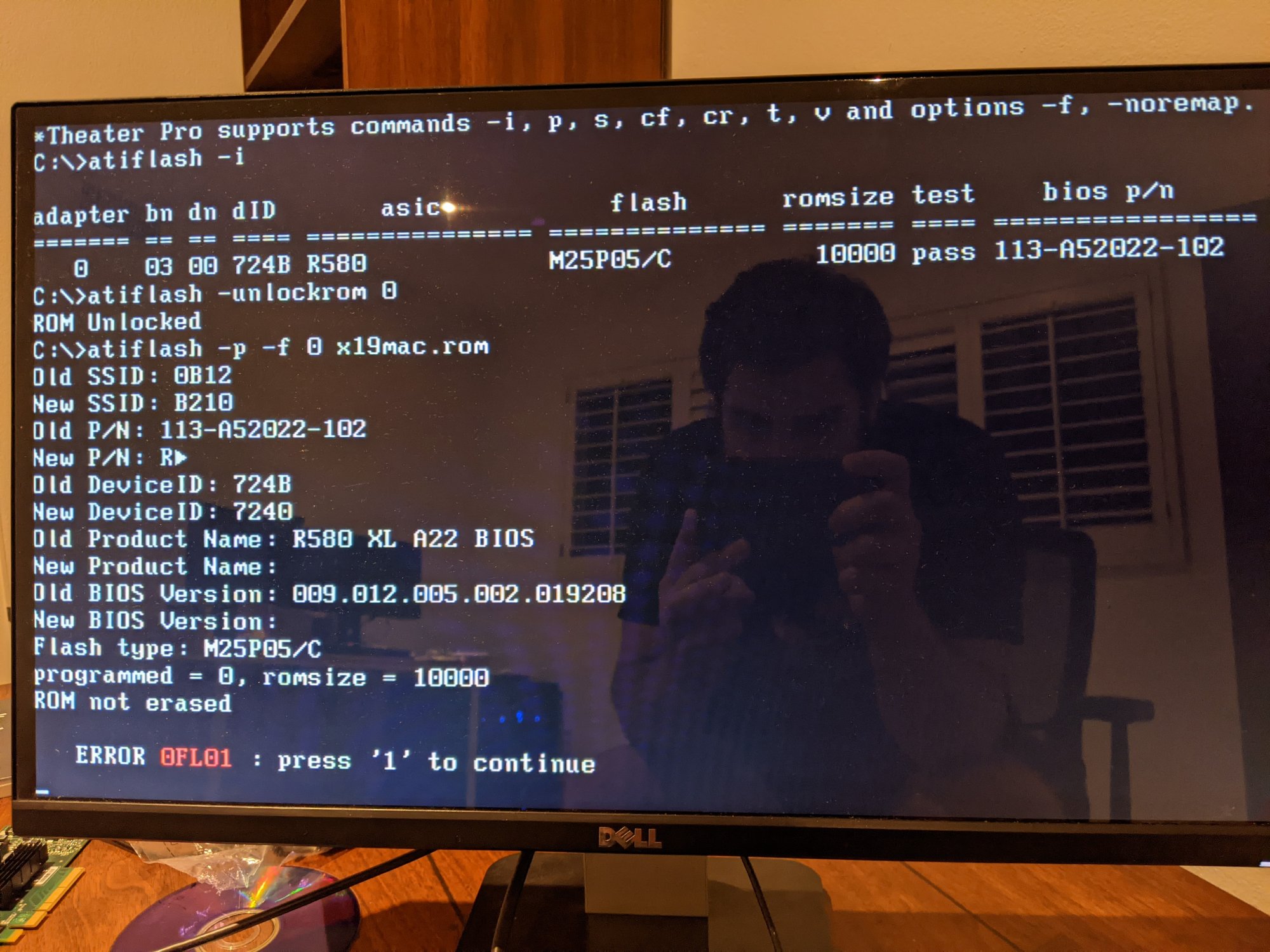

Hi everyone. I'm having a hell of a time flashing a Connect3d x1900gt with the MacElite x1900gt rom. Here are all of the things i've tried.
  1. Tried with dual PCIe video cards, single gpu. Using FreeDos as well as Win98boot.iso files to boot.
  2. Tried totally separate system with intel igpu and gpu.
  3. atiflash 3.15 - Won't recognize the card
  4. atiflash 3.99 - Sees the card but tried every flag I can think would make a difference just gives the error as seen in the screenshot.
  5. Tried a mix bag of versions of atiflash and the ones that can see the card gives the same error or variations on Invalid PC BIOS Image, Rom Not Erased, etc.
So I've never gotten it to flash at all. What the heck am I doing wrong here?? I've uploaded both the dumped rom as well at the EliteMac x1900gt rom for your reference.

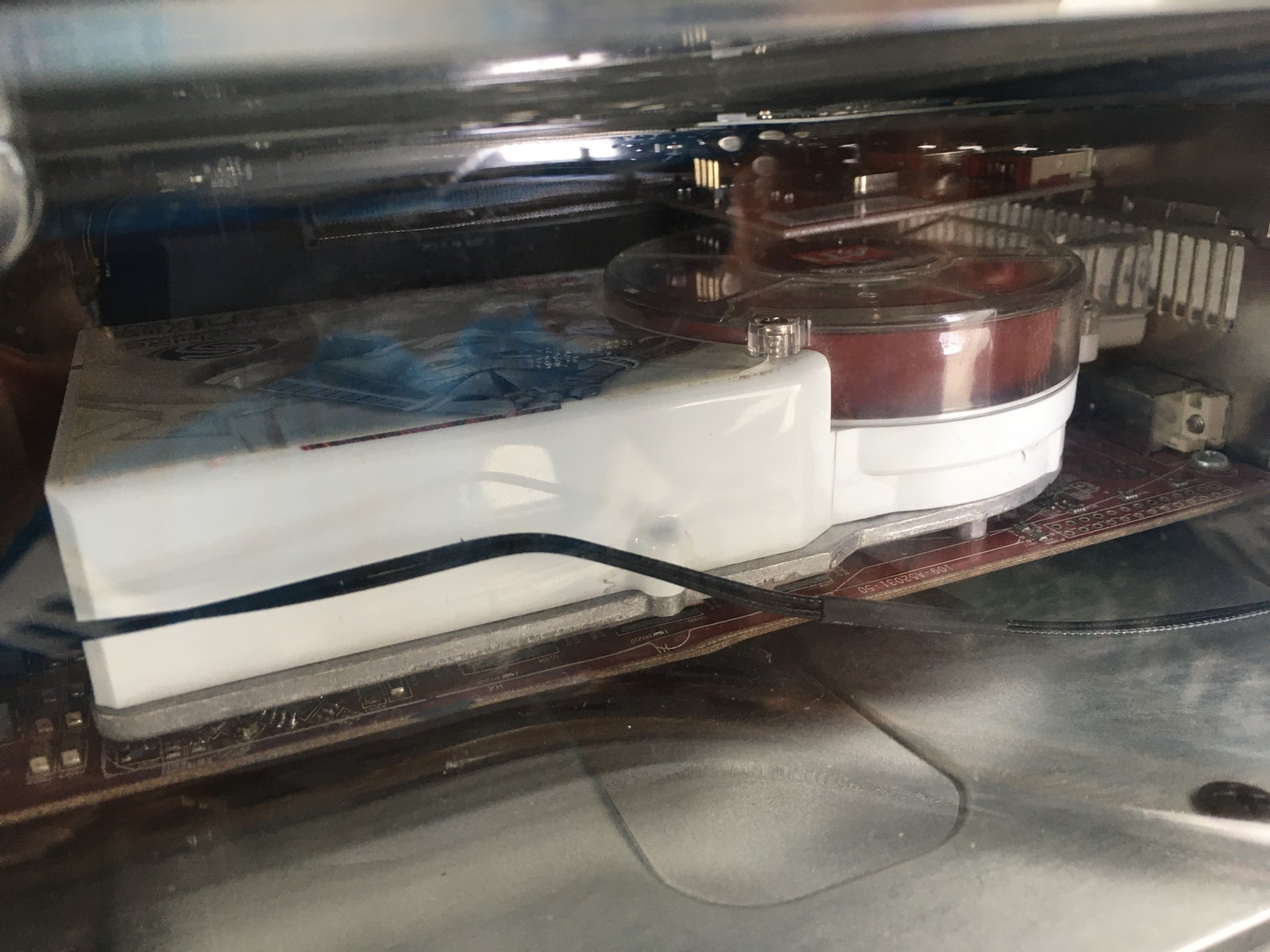

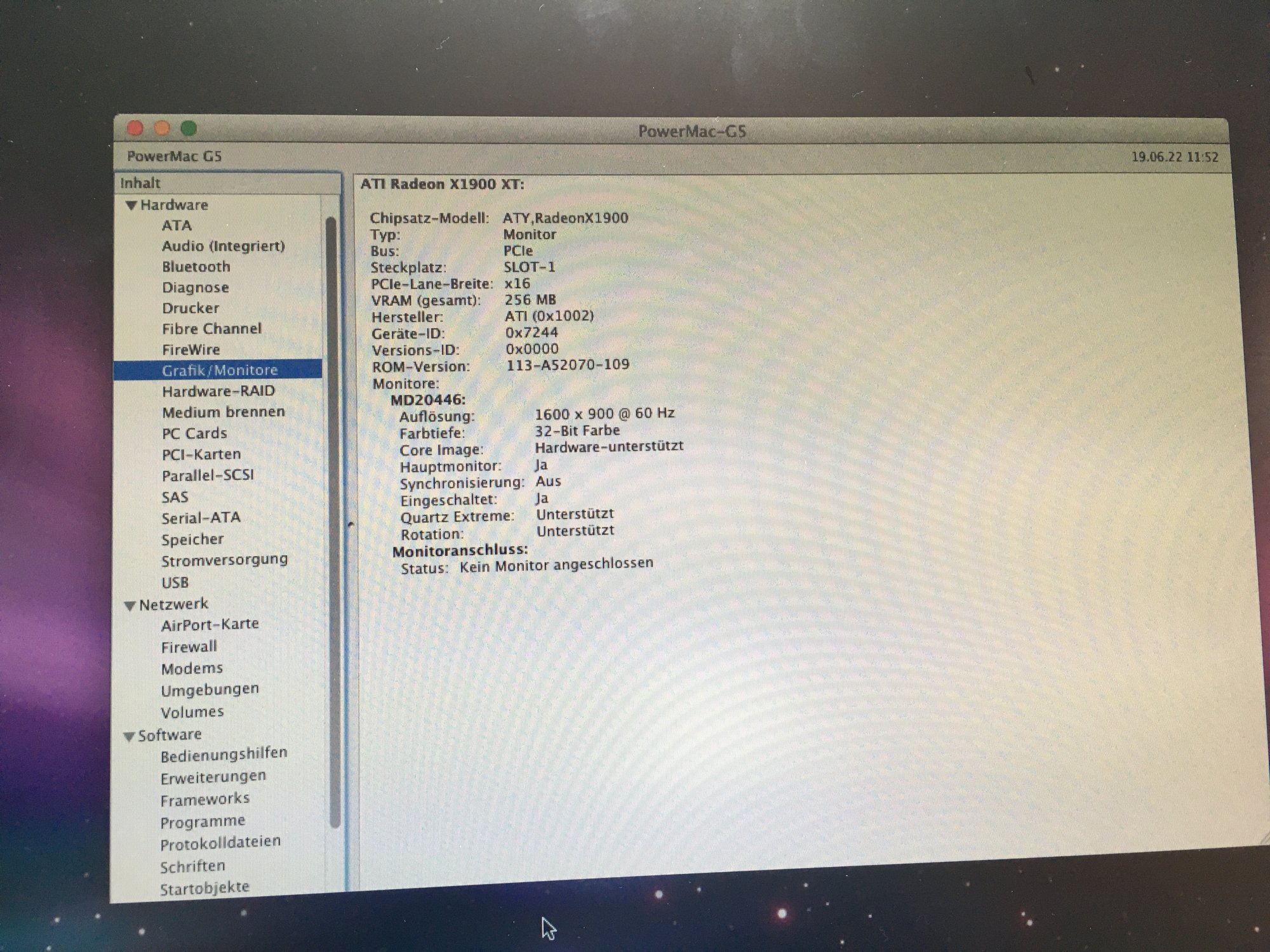

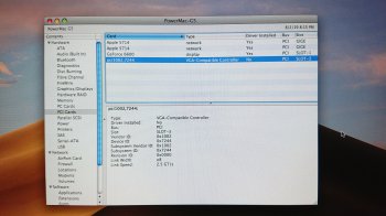

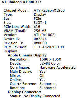

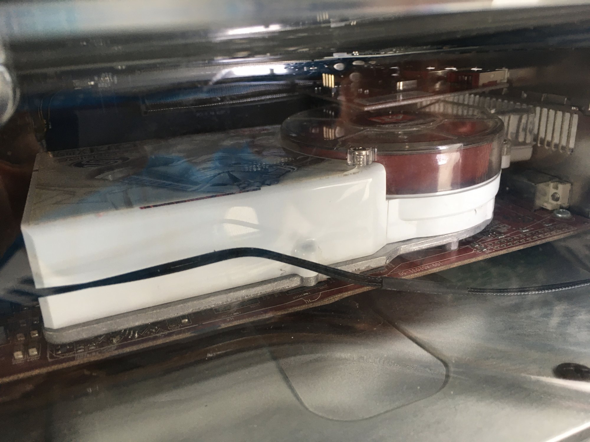

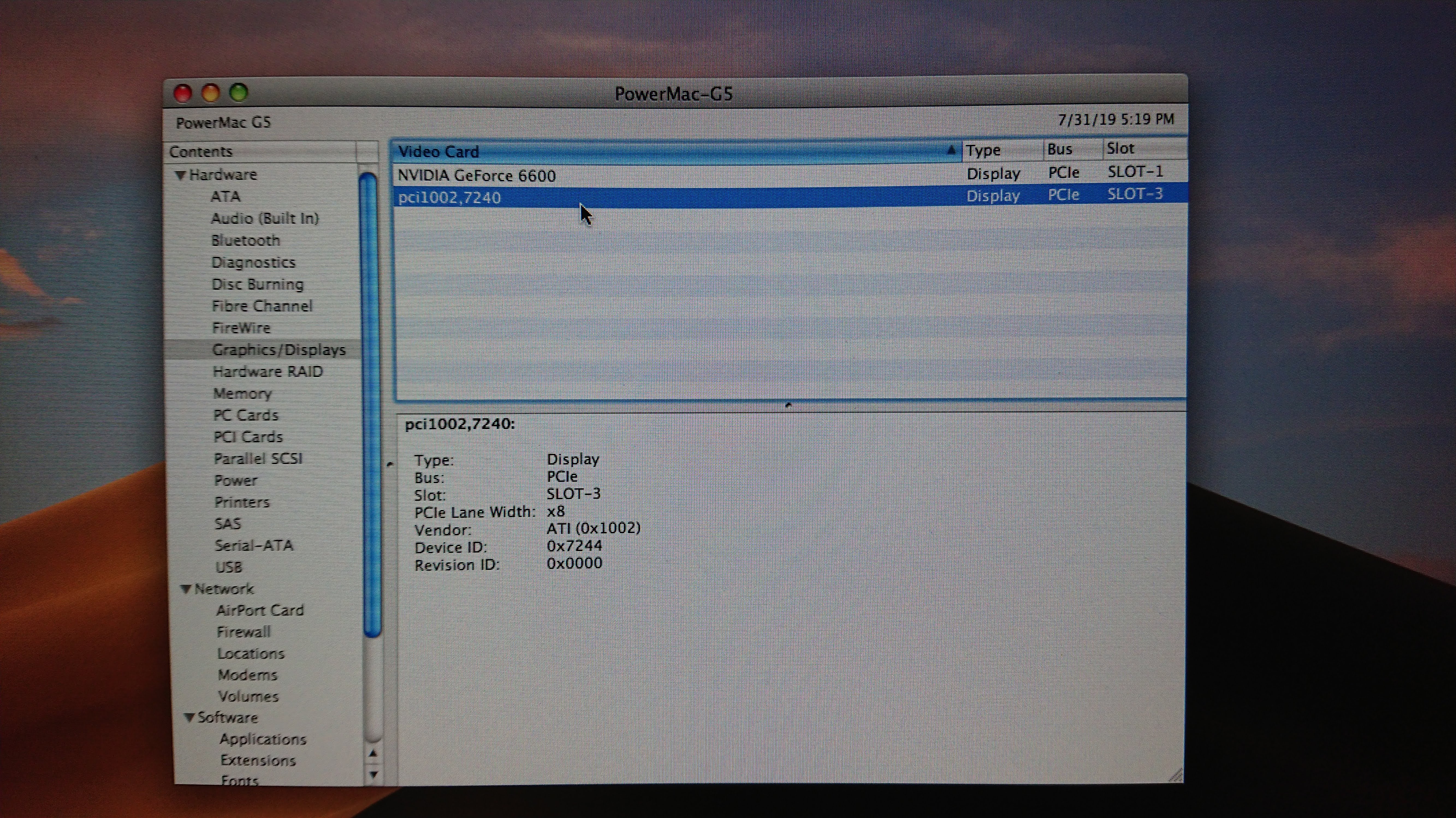

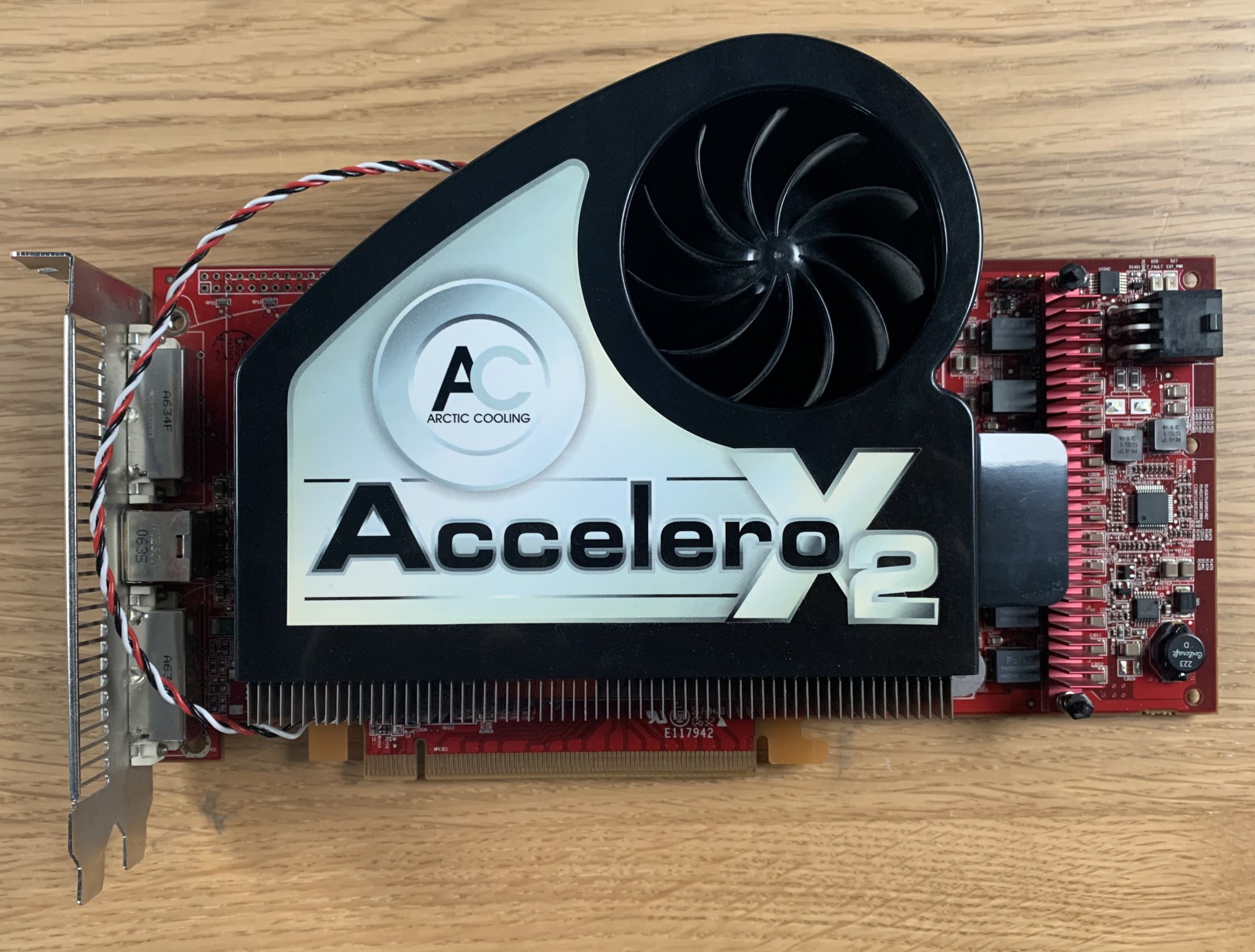

I'd like to share my success flashing an X1900 XT with the ROM from post #12 of this thread.
I'm not sure which vendor my card came from as it has an aftermarket cooler fitted but I'll post some pictures to possibly help anyone else on the hunt for a good G5 GPU.
This card absolutely destroys the GeForce 6600 I was using previously. It's unbelievable.

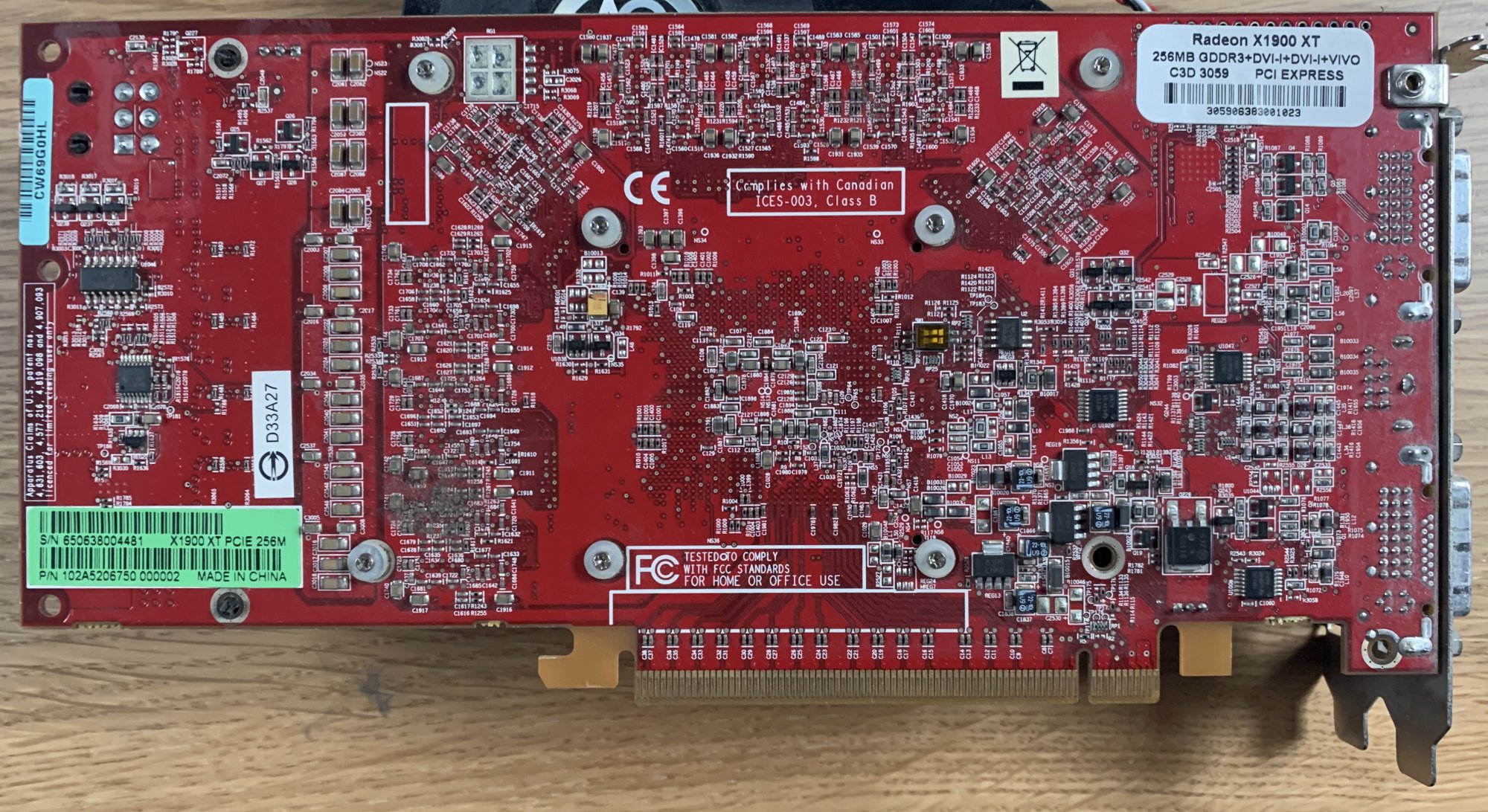

@thespecificocean The Connect3D X1900 GT was the first card that I successfully flashed for my Late '05 G5. I used the latest stable version of FreeDOS, ATIFlash 4.07, and the stock ROM from The Mac Elite (just as you are).
I would suggest using ATIFlash 4.07, if you haven't gotten it working already.

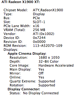

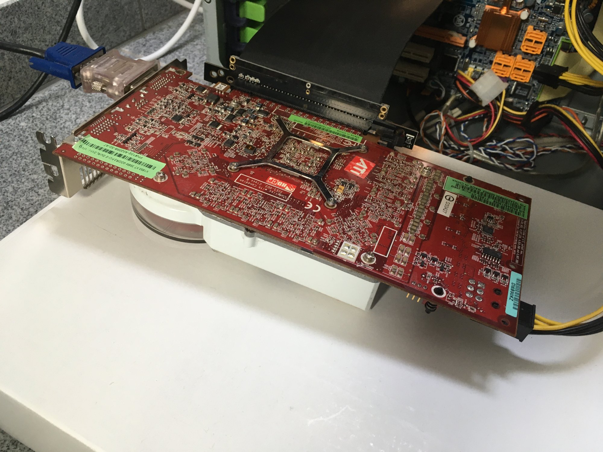

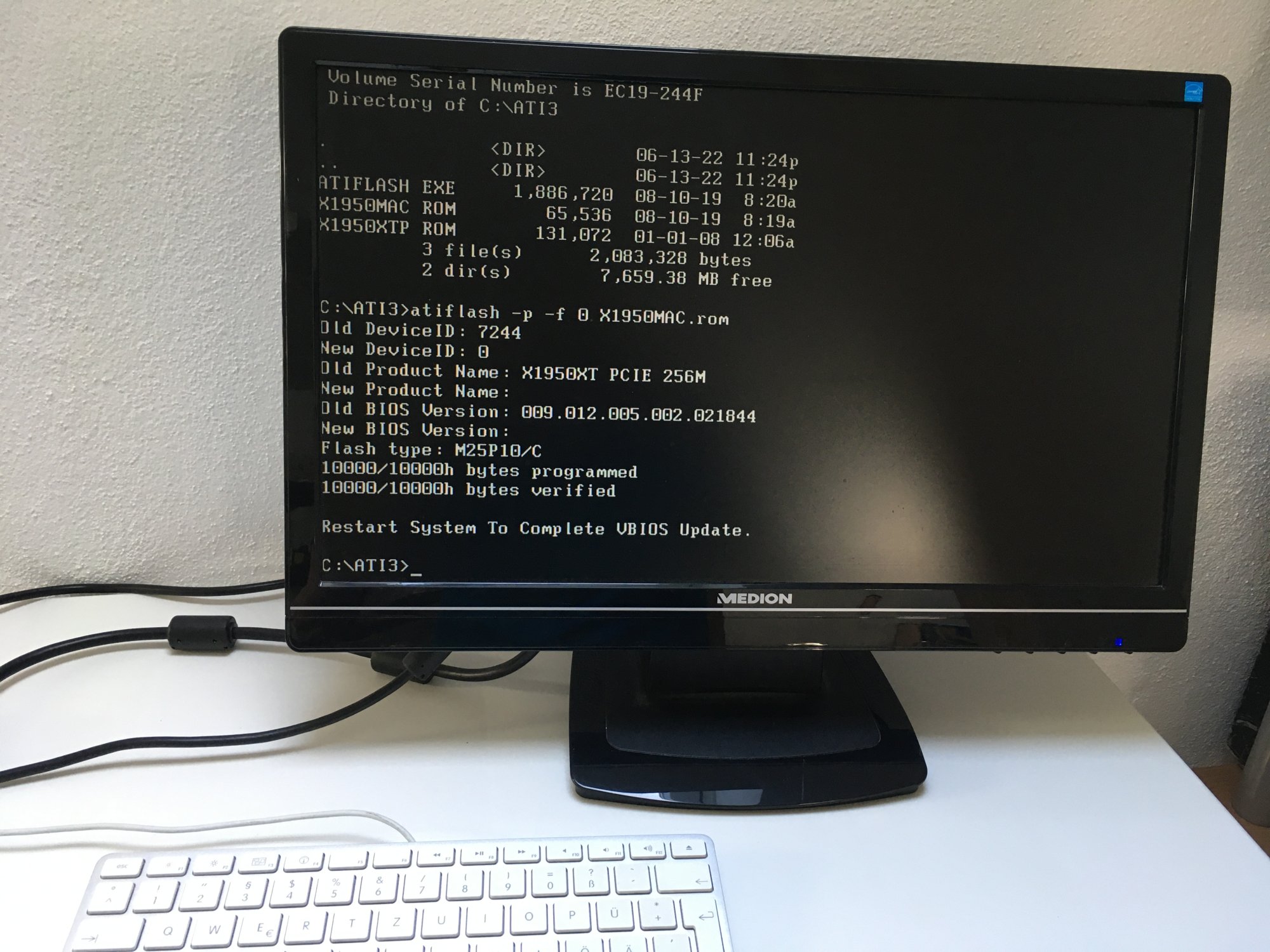

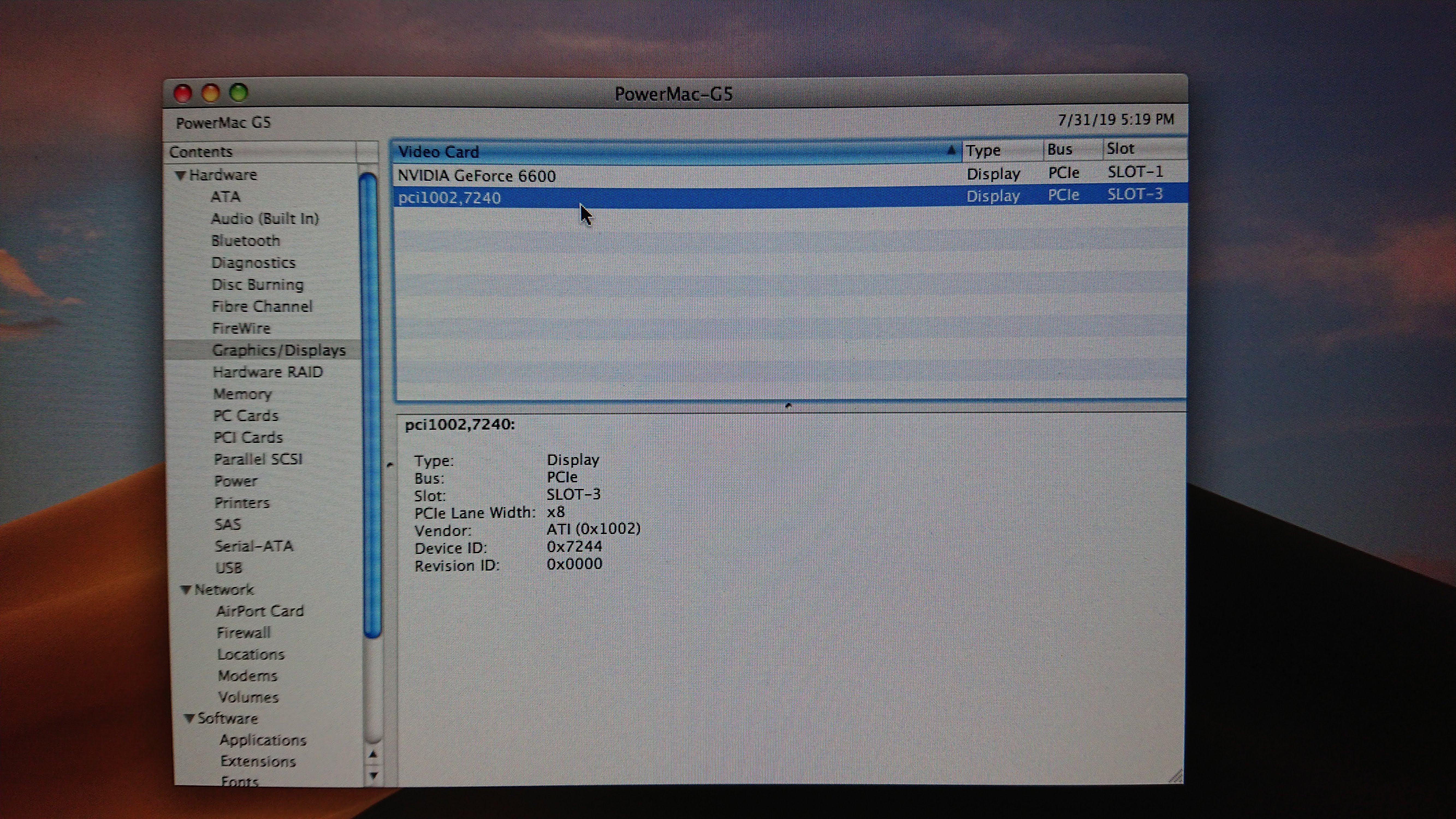

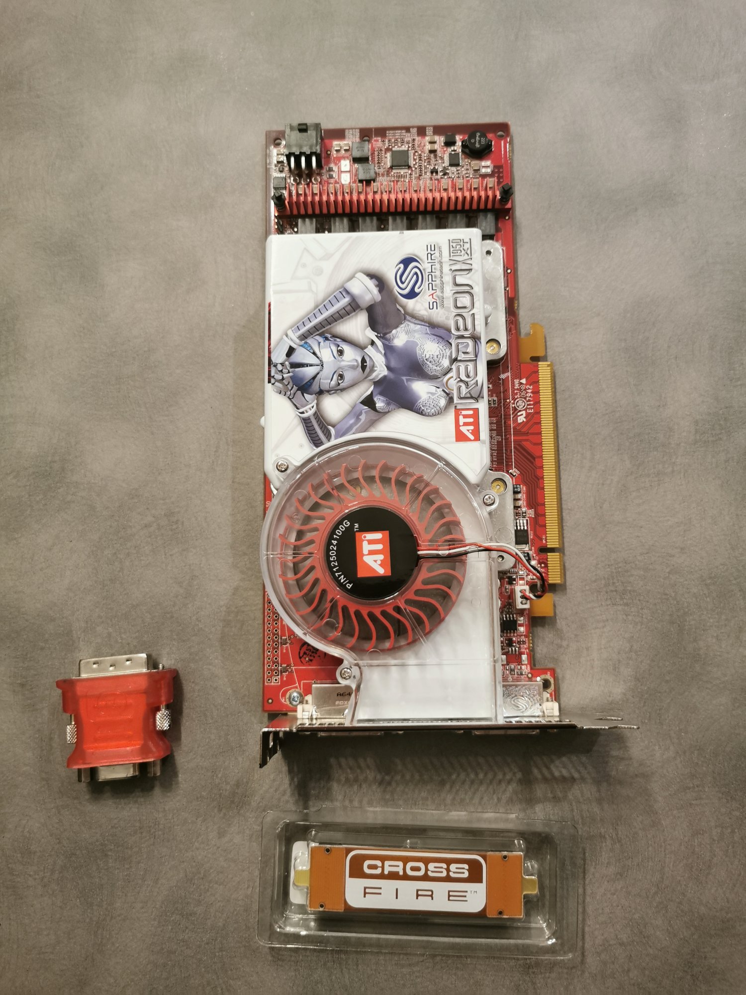

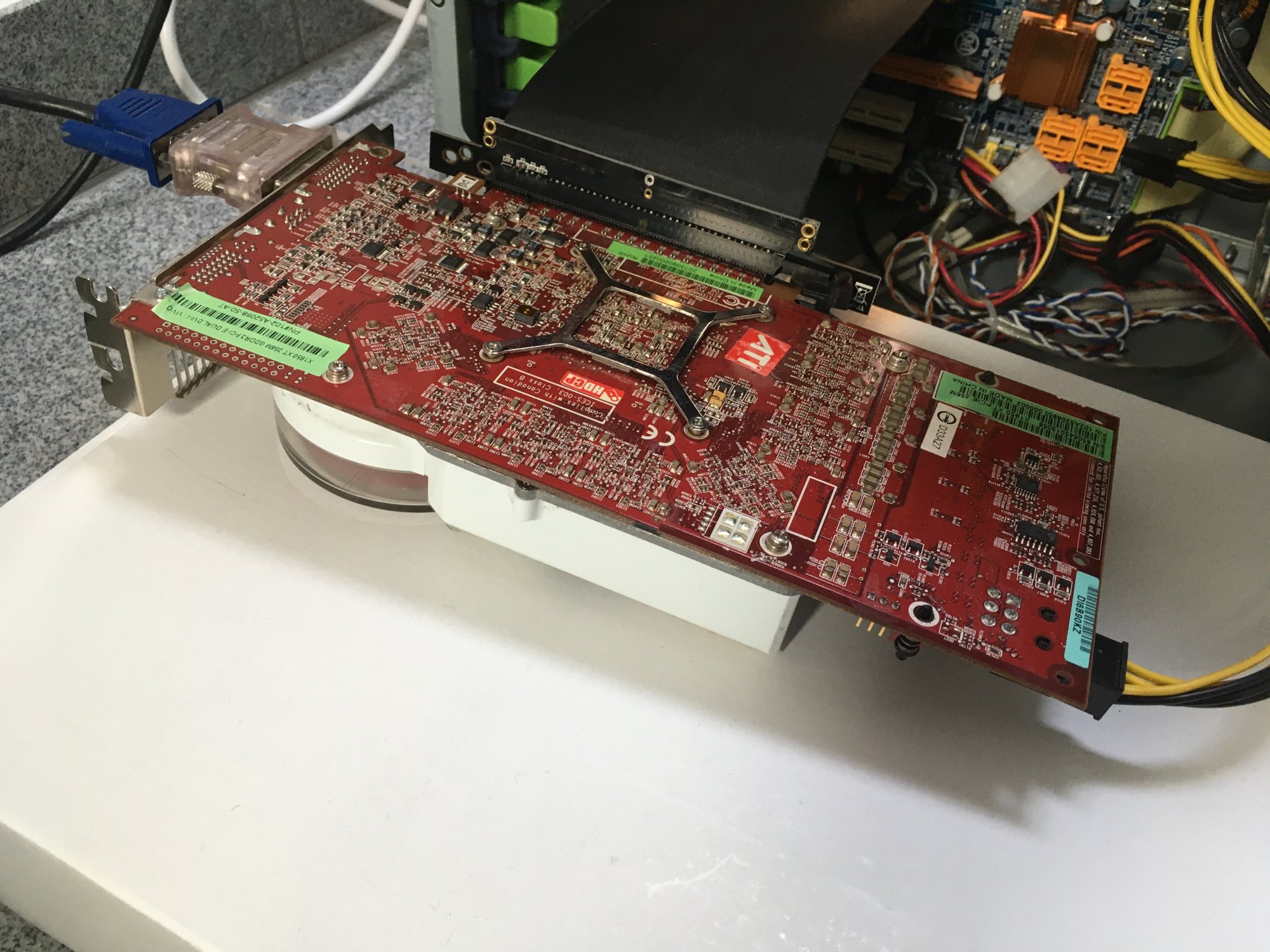

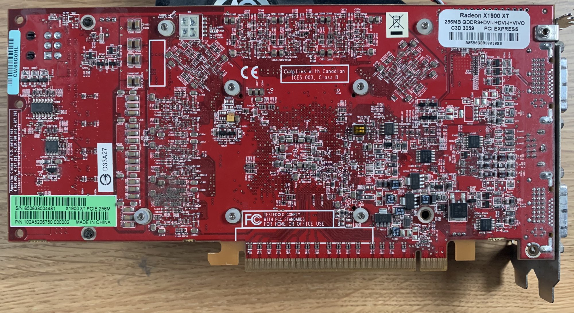

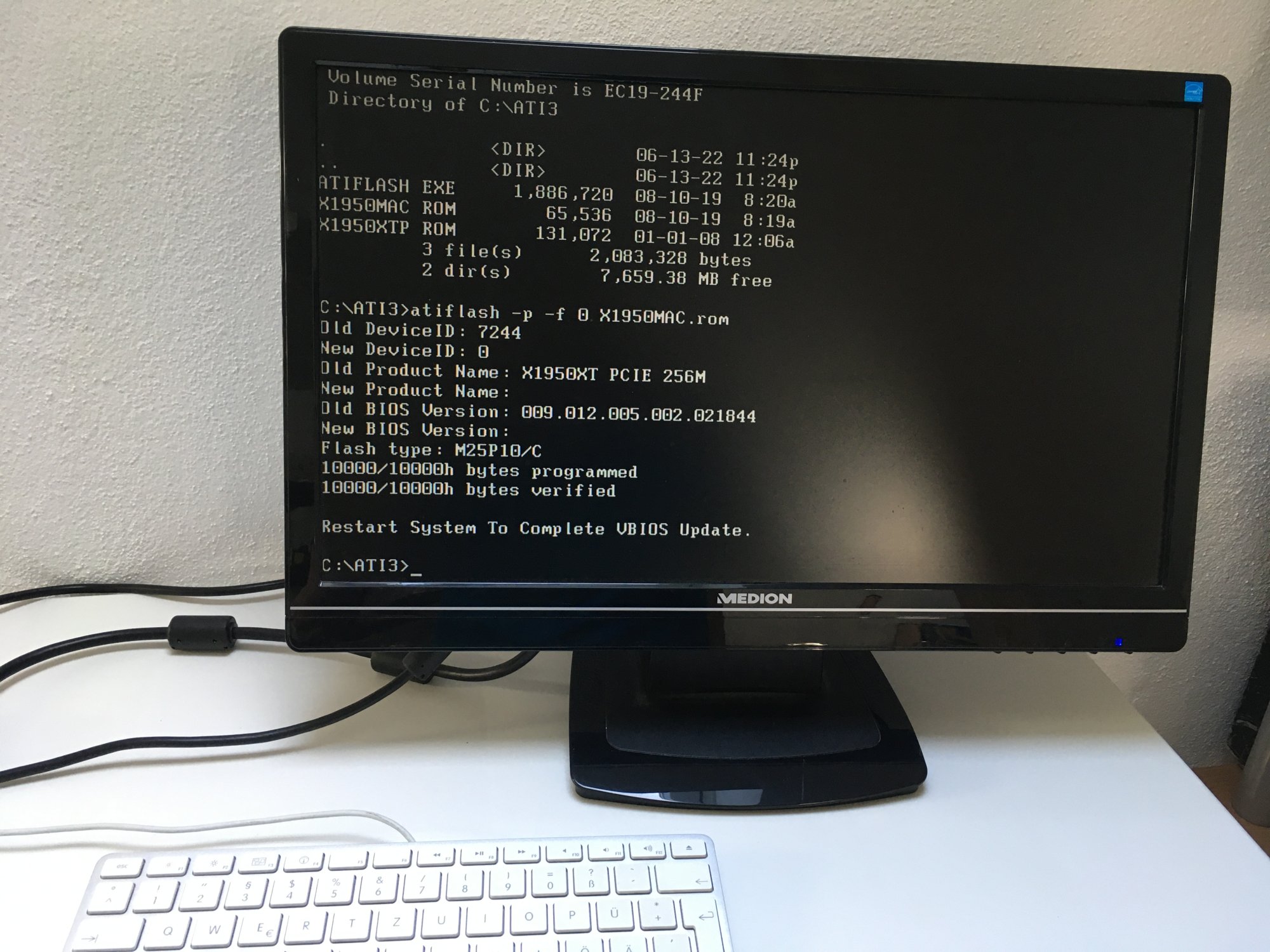

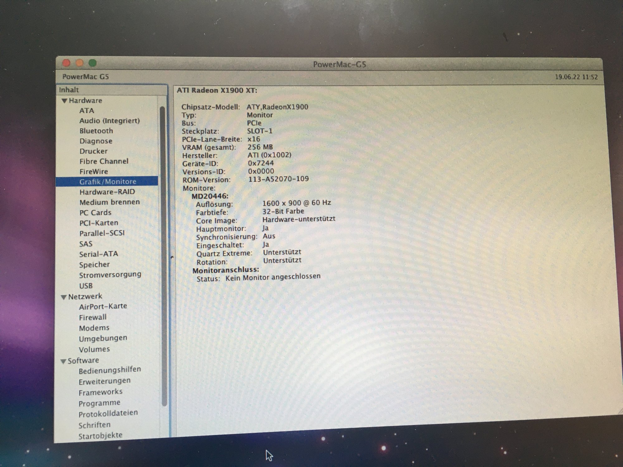

Worked great for me! Flashed my X1950XT for my G5 Quad with no issues. The card has to be the one in the attached photo (and the 256mb version).
ROM + latest version of Rufus attached. ATIFlash Commands here : https://www.techpowerup.com/forums/threads/how-to-use-atiflash.57750/
Thanks for sharing the .zip file. It worked for me too with the same card (the one with the humanoid robot). It is now in one of my PowerMac G5s where I previously had the FX4500 installed. According to an Xbench test I did the X1950XT is even faster than the FX4500 despite having half the RAM! I really love the card and I'm looking forward to playing around with it more in the future. I also flashed a similar card (X1900GT) but to a different ROM. While the X1900GT also works great, the X1950XT thankfully does not have its fan on full blast all the time. All in all, a great experience so far! :)
