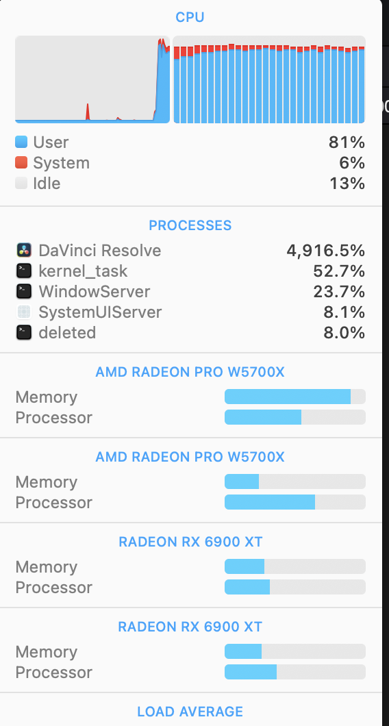

Here is the beauty of the 28 core cpu and 4 GPUs in action, dual W5700x and dual 6900XT connected via eGPU
