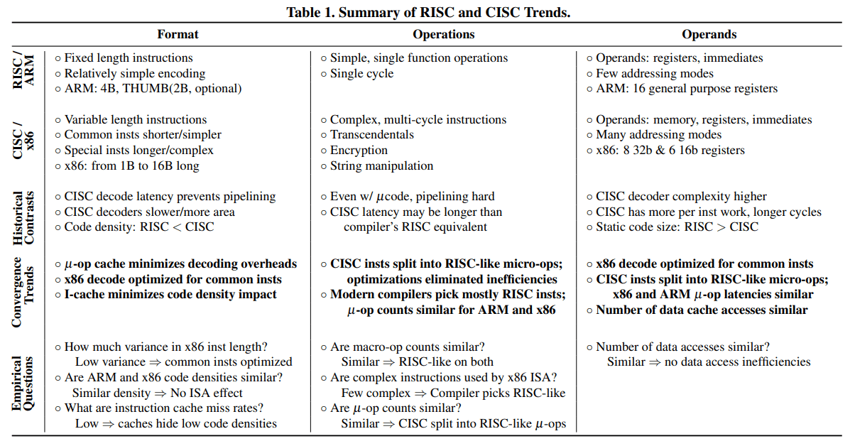

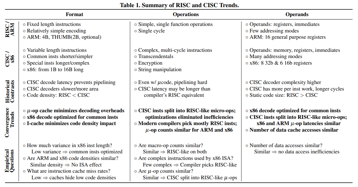

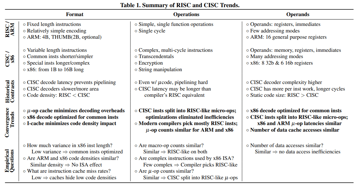

What are the real-world advantages of RISC?
It seems that ARM ISA is getting as complex as x64, so ARM ISA is losing some of its advantages over x64.
Source: https://chipsandcheese.com/2021/07/13/arm-or-x86-isa-doesnt-matter/

You are right. That summary table comes from a paper of 2013, and writers used a Beagleboard (Cortex-A8), a Pandaboard (Cortex-A9), and an Atom board to make the comparison. Those ARM boards are 32 bits.
Link to paper: https://research.cs.wisc.edu/vertical/papers/2013/hpca13-isa-power-struggles.pdf
I wonder if someone has made a similar comparison using modern ARM.
And in general there are a few issues I have with that article. For example, they nitpick on the implementation of individual chips (like A64FX, which is a narrow purpose throughtput-oriented CPU) and portray that as general weakness of ARM architecture. Or take this random note about LDADD violating the principles load-store architecture... sorry, but how do you implement atomic operations on a "purely" load-store architecture without stalling everything? What is even more bizarre that they single this out as a weakness of ARM while singing praises to RISC-V which contains the same exact kind of load-modify-store atomic instructions (amoadd and friends)! And who am I to argue with Jim Keller, but I also find it weird that the article praises RISC-V as the "new clean slate design" but at the same time completely forgets to mention that RISC-V suffers from verbose instruction encoding and has to rely on instruction compression to make the code density competitive with modern ARM and x86...
I would love to see an in-depth comprehensive study of the topic. We now have a lot of different designs, so it should be possible to collect enough data for fair comparisons. From my amateur perspective, few things seem particularly striking. First of all, all modern high-performance implementations offer more or less the same performance. To me at least it seems fairly clear that the performance of a CPU is not limited by its ISA, but by the amount of money, time and talent spend on microarchitectural optimisations. But there does seems to be a power tradeoff, as x86 designs generally use at least 2-3 times more power. And power-optimised designs (Atom and friends) perform significantly worse. What I would be most curious to know is whether this is because of the historical path and thus specific implementation details these companies took (x86 focusing on desktop applications and scaling down to mobile, or ARM/Apple focusing on mobile applications and scaling up to desktop), or whether there is something inherent to implementing x86 that requires more power (e.g. x86 decode can be done in constant time via data-parallel techniques, but maybe it can never be as power efficient as ARM decode). These are interesting question IMO, not bickering about abbreviations.
