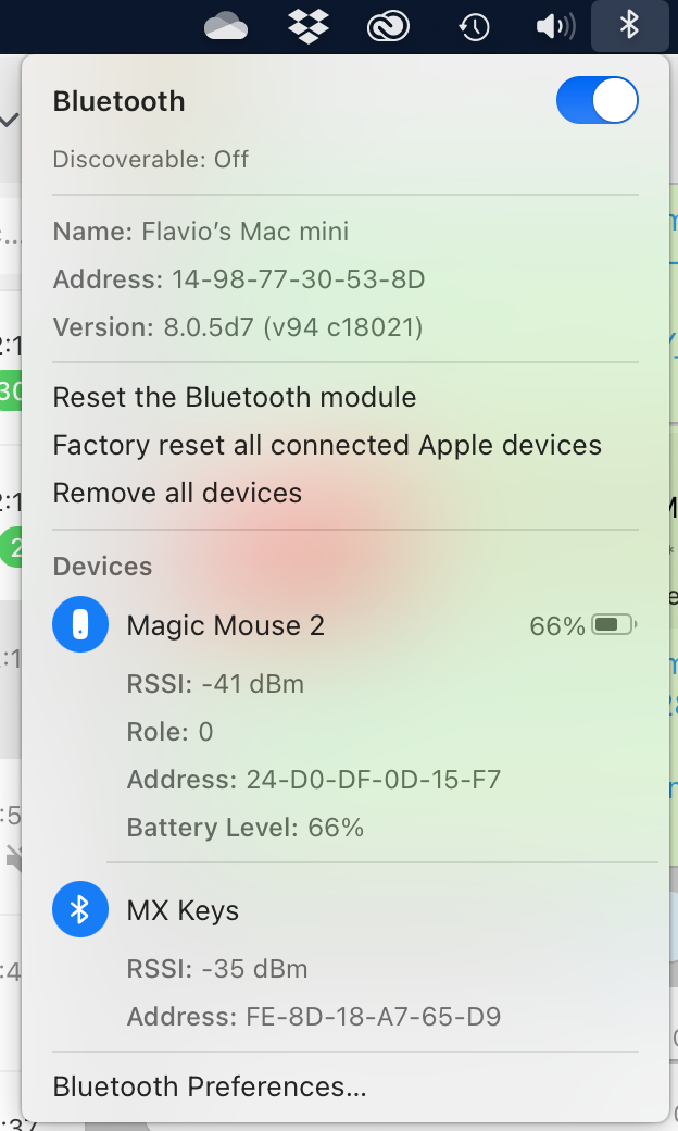

Try to reset the BT module.
Holding the option and shift key press the bluetooth icon on Menu Bar. Them select Reset the Bluetooth module.

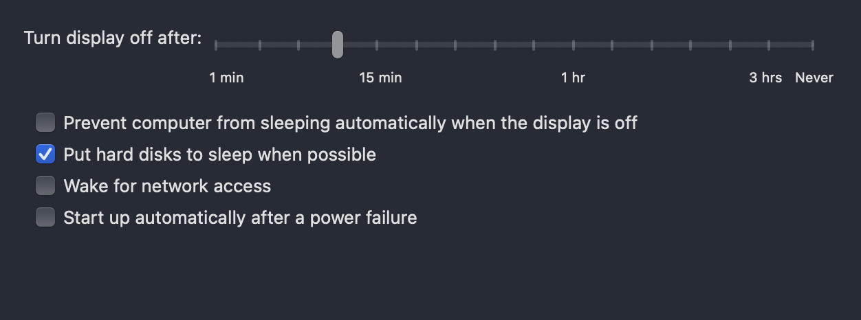

I was thinking about it, when I figured out that putting iMac to sleep and waking up fixed the issue with keyboard. I changed settings for energy saver. I will test it and see if that helps. BTW - no help from Apple Support so far.
I have a little update. My iMac has been working fine for 10 days with settings from message above. What's more, I have BNIB iMac at work and I decided to put it on test with "original settings" I had when my iMac was acting up. After 2 days keyboard started lagging the same way I experienced it at home. So - "putting unit to sleep when not used" and "turning off the HDD when possible "cures the issue.
Update after 30 days: iMac has been working fine since I changed settings as listed above. I have been also testing another iMac at work - it acted up twice, then I upgraded OS to Monterey (beta) and is's been running fine for 6 days already. It seems to be a glitch in Big Sur.
