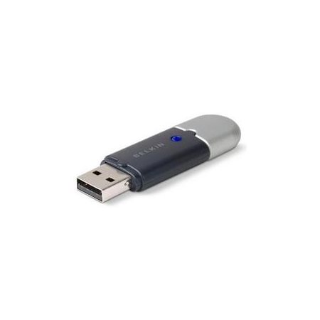

A cheap $5 usb bt dongle gives me blue tooth on my quicksilver power mac. Also, if you want a bit more zip & you're up for it, MDD dual 1Ghz cpu daughter cards are all over ebay for $25-35.00 - dual 1.25ghz a bit more. As already mentioned for leopard 10.5.8, core image enabled gpus are another good boost if your box doesnt already have one. Anyhow, I hope you choose to keep it. Old ppc powermacs are fun (addictive) projects to build up. Also, Eyoungren has a stickied thread for some TFF tweaks that help greatly with browser speed & performance making for a very usable 15 year old daily driver.

I also wanted to clarify that the bluetooth dongle that worked for me in both my MDD and QS running 10.5.8 was specifically the soundbot bt4.0 unit. It's not like any old bt dongle works.
http://www.ebay.com/itm/SoundBot-SB...920571?hash=item1ea860943b:g:HHAAAOSwrklVHHoJ
Does this dongle work as native for you?
Meaning does it treat your Mac as if it had a BT card installed (icon in menubar, etc)?
Just curious.
I'm using the Belkin F8T013. Was using it in my QS before as well. It seems there is some sort of interference which makes my stock Airport card in my Quad jumpy so I just continued to use my Belkin.
Belkin also makes the F8T012, which my son has used in the past (gave his TiBook native BT). The difference between the two products is range. 10 meters for the F8T012 and 100 meters for the F8T013.
eBay has these (F8T013) for the same price as the one in the link you posted. The F8T012 goes for $7.99.
Meaning does it treat your Mac as if it had a BT card installed (icon in menubar, etc)? Just curious. I'm using the Belkin F8T013. Was using it in my QS before as well. It seems there is some sort of interference which makes my stock Airport card in my Quad jumpy so I just continued to use my Belkin.
Belkin also makes the F8T012, which my son has used in the past (gave his TiBook native BT). The difference between the two products is range. 10 meters for the F8T012 and 100 meters for the F8T013. eBay has these (F8T013) for the same price as the one in the link you posted. The F8T012 goes for $7.99.
So I do absolutely get an icon etc. It does have one weird behavior with my QS specifically (not my MDD). when I boot up my QS, it finds my mighty mouse but then fails to connect, finds it again and then connects without problem - this process taking about 25-30 seconds. From there, everything bluetooth works great ie peripherals, file transfers etc. Again, this is specific to my QS only, the MDD connects right up without issue.
Strange behavior with the QS…
I was asking because I like to keep my options open in case I have to replace things like this. Nice to know there's another product out there that will function the same way if the one I currently have fails.
Thanks!
Yeah I can confirm it. Funny that I paid 10€ (almost 12$), it is from a European brand with boxes and warranty, on the box it's stated to be working on Mac OS X10.3+, but on my MDD it causes the system to freeze both on Linux and OS X. I guess these old macs are a bit selective xD
As regards Bluetooth I've tried every BT usb dongle I found in my house and they all work as native Bluetooth. It seems to be less selective than it is with PCI USB cards.
