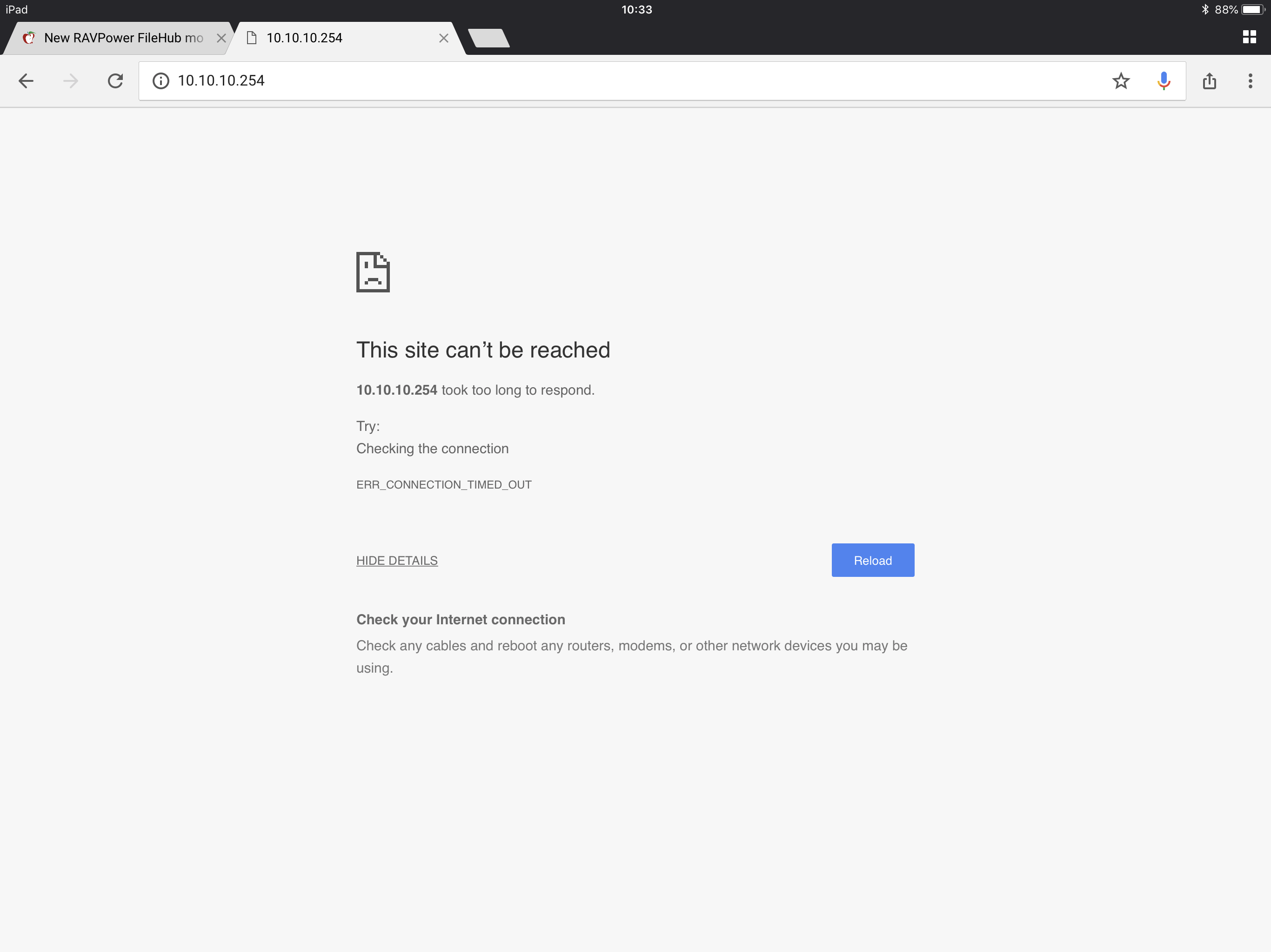

I don't know why I can't connect to that site. I'm using Safari or Google Chrome. This is what I keep getting but only from that site.

I found the problem with 10.10.10.254 site. I use Lookout Mobile Security app. I'm a beta tester. Part of it is "Safe Browsing" mode. I had that selected which for some reason was blocking that website. Turned off Safe Browsing and site opened up. Now it won't accept any passwords but I'm closer! I saw that setting in Lookout a dozen times but it never clicked that might be my problem. I'll get this figured out.
There's an old saying I heard many years ago "You can eat a whole elephant but you do it one bite at a time ".
Thanks for your help.

View attachment 772923 I don't know why I can't connect to that site. I'm using Safari or Google Chrome. This is what I keep getting but only from that site.
Looking at the User Guide on pp.18-19, when logging in to 10.10.10.254 for the first time, the user ID is admin and the password is empty ("Log in with default user name: admin, password: (leave it empty)"). So the default admin password is null - maybe that's why it's not connecting - wrong password.

You're right again. I'm eating that last big bite of elephant. Got logged in, redid my settings. I'm now going to see if there is a firmware update. Also able to read my external hard drive and SD cards.
Again, thank you
