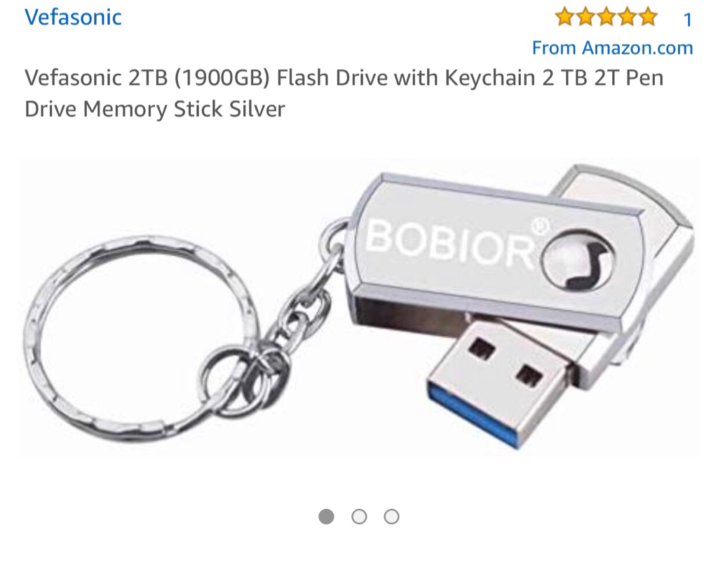

So Ravpower sent me a new Filehub plus for free since two died on me... maybe third time is a charm?
As a side note: I got hold of a 2 Tb USB stick... yes stick, not hard drive. For a whole whopping 30.00! And it’s much smaller and easier to carry than a hard drive and uses less power from the Filehub.
I was sceptical that first of all it was actually 2 Tb and second of all that it would not die because of being cheaply made (it’s from China and cost 30.00 for 2 Tb so anyone would be skeptic) The RAV power did find it! And it’s definitely 2 Tb! For anyone wishing to lug around less it almost doesn’t even stick out from the Filehub! Search Amazon for Vefasonic 2 Tb USB stick.
That stick however is USB 2.0
I thought Ravpower I know is USB 3.0
I also have several USB 3.1 sticks of smaller capacity and the RAV power won’t find them at all. I thought devices are supposed to still find them but just that the transfer speed would be the USB 3.0? But it can’t even see the sticks at all....

I think the USB on both the older and the new FileHub are 2.0. They definitely don't operate at 3.0 speeds. I have both but I'm using the older model - it doesn't get hot like the new one when in use.
Even if it’s UB 2.0 shouldn’t it still ‘see’ a USB 3.0 stick? It would just transfer at the slower speed wouldn’t it? Instead it’s not seeing it at all...
By the way this is the 2Tb one. Grab a few and they are perfect companion to the Ravpower!
Definitely should see them - I use a lot of USB 3 devices with mine. How are they formatted? Have you tried reformatting them?

One thing regarding that 2TB pendrive - have you actually tried writing 2TB data to it? That is the only way you can verify it's actual capacity - call me sceptical but I'd be amazed if it truly was 2TB!
