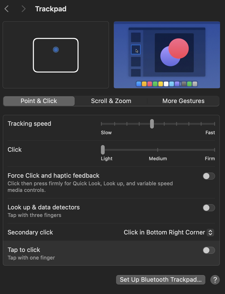

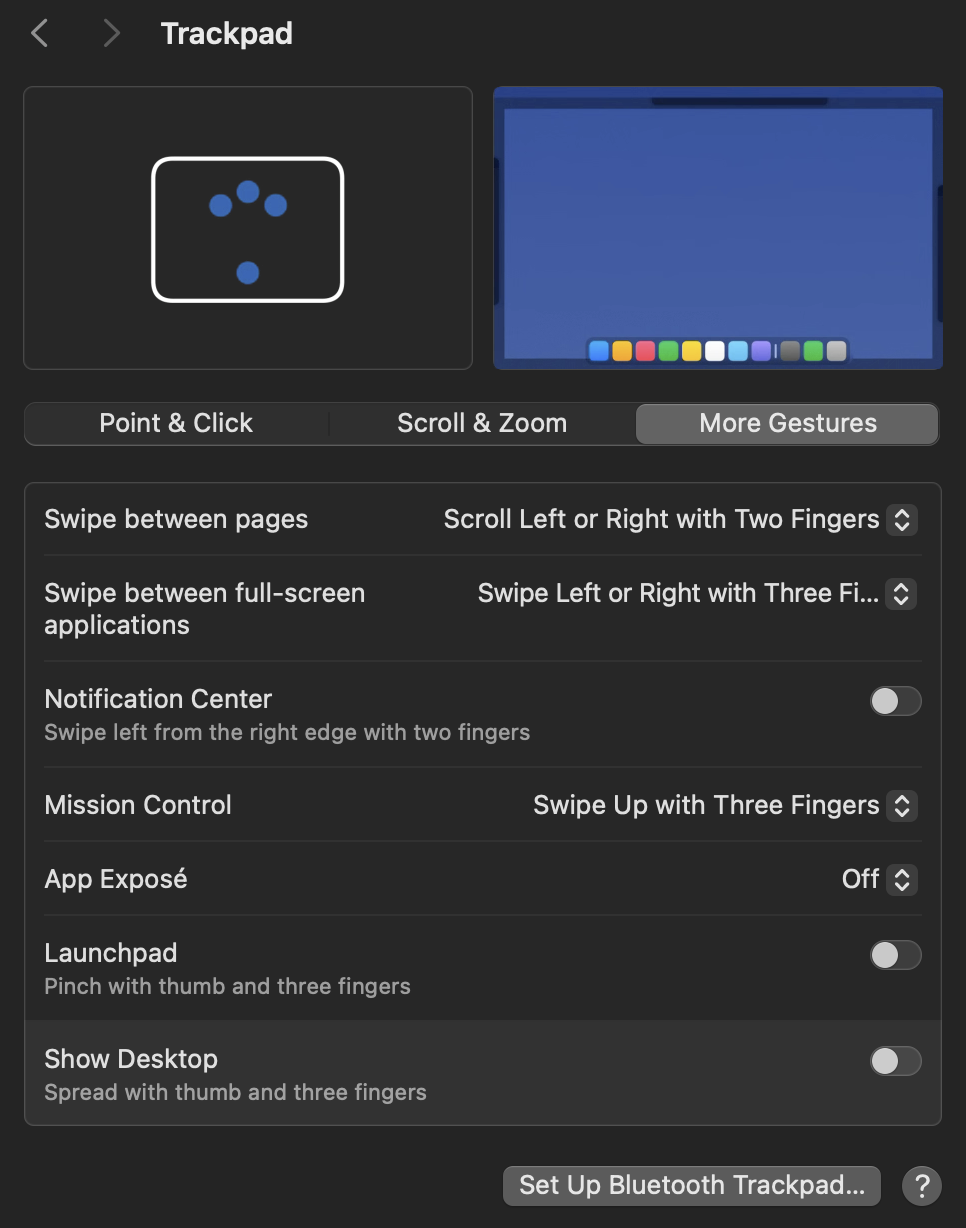

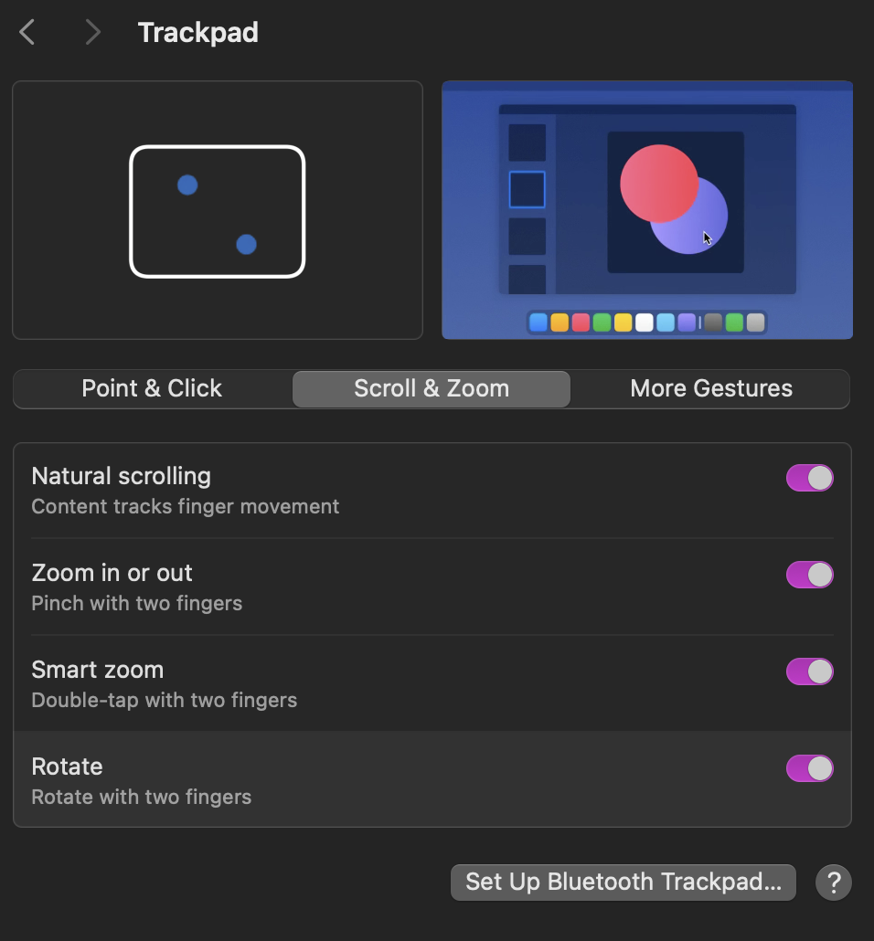

@TehBrian I was not able to reproduce your issue shown in your video. Can you please check if click by tapping is disabled?
Tap to click is definitely disabled. Here are my trackpad settings.
