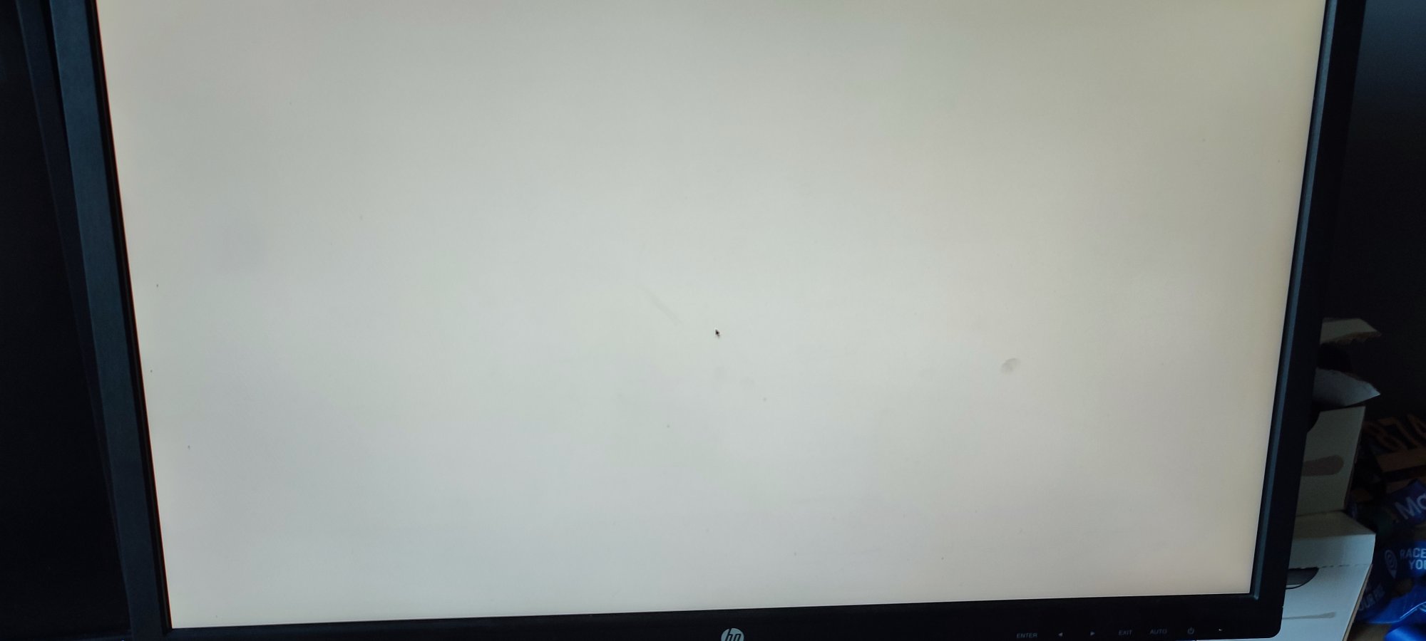

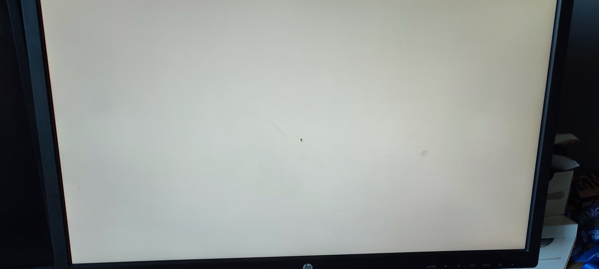

Today I created what I am sure is a boot usb for high Sierra, and tried to boot my Mac Pro. Pressed power button and on the chime, I pressed the option key (alt on my windows keyboard)
All I got was a grey screen with mouse cursor. Nothing else. Is my USB not working?
Remove all disks and see if you can boot to the createinstallmedia USB installer. Did you tested the createinstallmedia with the Mac you created? You could made it incorrectly.
thanks, unfortunately I do not have another Mac, and I am waiting for someone I know, to post me out an installer USB, but I tried today to create one on my windows PC using TRANSMAC and a HIGH SIERRA image file
so I cannot test this USB as I do not have another mac
Just to be clear boot/press option/ grey screen. No drive selection (where you select the USB)
Try to redo the USB
Is the USB Key USB3, not sure if the ports on MacPro are vr 2 or vr 3. and or if the USB 3 drive will work correctly with a USB vr 2 port.
Try another USB drive.
yes, I did a CLEAR boot, waited for the BOOT bing, then pressed OPTION and just a grey screen with mouse pointer, no drives showing, I have a 480GB SSD installed, and the USB
the USB is a USB 2.0 using a USB2.0 port on the mac
Hmm interesting. Well try what @tsialex mentioned and disconnect the internal drive and only try to boot with the USB media. Try another port etc.
Lastly I guess you didn't get the install CD media. If you can download it and burn it to CD this might be another method. You could boot off the CD media and try and install that way or at least see if the Mac will boot.
