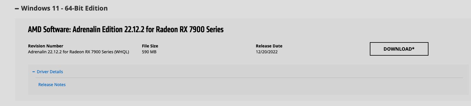

There is no need at all for Apple add the NAVI 3x drivers to BootCamp, you can yourself install AMD provided drivers.
Btw, Windows Update will probably install it in half hour or so automatically and then the screen will work, if you are connected to the net.

I dont understand why you would switch from a 6900 to 5700x and back, the 6900 is supported in ventura and windows, why even have the 5700x in the machine?
If you download the latest AMD drivers in windows they have support for the 6900 and 7900 gpu's, so when you swap out the 6900 to 7900 it will load from the latest drivers.
The only issue is if you have boot camp loaded with boot camp drivers which support both the 5700x and 6900 then they will be old drivers which dont have 7900 support.
I would remove the 5700x from machine, only leave the 6900 and boot into windows, then remove the boot camp AMD drivers with DDU and download and install the latest AMD drivers. after installing the latest AMD drivers if you install your 7900 it will work in windows with the new drivers.
I had this exact issue. bootcamp drivers are old and not upto date. also the way i switch from 6900xt in OSX to windows with a 4090 installed along with my 6900xt is to use a 8k DP switch. so from switch to monitor is one cable. to switch i have 2 cables, one from 4090 and one from 6900xt. which ever OS i am using i switch to that card via switch. you can even see boot loader with 4090 with option key, then select windows. same with 6900xt just select OSX its that simple.

How many GPU's you have installed? If you have more than one connect a display to the working one and inspect the drivers in device manager.
Not a bad idea, but the 9700 is recognized under Windows as a basic display adapter.
And no drivers are found. The 6900 has the latest driver installed under WIN 11.

Go to website guru 3d , download DDU and run it, read the instructions and follow. have the new AMD drivers downloaded already to install. after running DDU you can install the new AMD drivers. DDU will also remove all the 5700x drivers also.
I had to do the same thing when installing my 6900xt into windows 11 as bootcamp uses old drivers which will be useless for a new 7900xt or xtx. after installation do not use bootcamp update or it will install the older drivers again.
