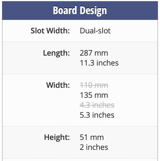

I am confused. The card you've provided a link to lists a length of 14.5 inches. According to BareFeats, the longest card that will fit into the 7.1 Mac is 12.2 inches. Did you link the wrong card, or did you actually fit a 14.5 inch card in your 7.1 Mac? Incidentally, I purchased an RX 6900 XT video card from Amazon a while ago that lists a length of 11.26 inches, and it did appear that that 12.2 inch maximum size was accurate.
He's using a Reference RX-7900 XTX made by Sapphire.

You really should learn the difference between the reference cards and the overclocked ones. The OC cards generally have better specs but they are larger (with Gigabyte usually being the exception though not always), as they have different cooler designs to accommodate for being OC'd, etc....
Really - I should learn the difference between the reference cards and the overclocked ones? All I did was click on the Amazon link he provided to the person who asked what make and model card his was. The card in that link is 14.5 inches long. I already know how to read the length of video cards and find one that will fit. I was attempting to prevent someone who doesn't know from buying a card that will not fit in their 7.1 Mac.

No need to get mad, your condescension is absolutely unnecessary -- I wasn't trying to be flippant, just meant you should learn that there are several types of GPUs other than just reference, as per your original comment, you seem to believe all GPUs are the same.
Also, the card he linked on Amazon is literally the exact same one that I linked you above from Techpowerup (21322-01-20G).
I don't know how old you are, but amazon isn't always a trustworthy source, especially when it comes to device specs -- however, Techpowerup is always spot on with their data, so one last bit of advice -- don't always trust spec info listed on amazon. This goes for any device you are looking at on there.
The specs on Amazon are wrong, the Sapphire card from the link I provided is the card you see on the picture in post #52

It would be great if the 7900xtx is supported, but the size of most models are just to big to fit inside the 7.1 mac pro. Only the reference card fits so far which is a shame as they are no longer produced so only available 2nd hand and you dont know if you will be buying an early one with the cooling fault on the heatsink. Unless a manufacturer comes out with a shorter version to fit inside the 7.1 mac pro it will become hard to obtain one which will drive up the price.

Just FYI, Gigabyte already have a card that will fit the 2019 Mac Pro:
Card size
L=287 W=123 H=51 mm
