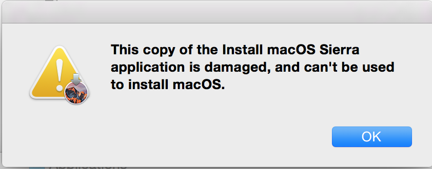

You can't copy the "Install macOS Sierra" app from the HDD to the SSD because of new Sierra install app bug. If you try to launch it from SSD you will see:
You must run the "Install macOS Sierra" app from the Applications folder that InstallOS.dmg (downloaded in Step 4) and InstallOS.pkg (Step 5) was run on to create the "Install macOS Sierra" app in the Applications folder (I would recommend NOT rebooting before running the "Install macOS Sierra" app). You can select the disk to install Sierra on once you launch the the "Install macOS Sierra" app and see the window shown in Step 6 and click Continue.
If you want to do a clean install, that is more complicated because of the buggy new Sierra installer.
I would recommend booting from an El Capitan USB installer. Erase the drive you want to do the clean install, install El Capitan to the wiped drive, create your login account, boot from the new account on the freshly installed drive, then run the Sierra InstallOS.dmg (downloaded in Step 4) and InstallOS.pkg (Step 5) to create the "Install macOS Sierra" app in the Applications folder. Launch the "Install macOS Sierra" app to install Sierra. That is as close to a clean install that I can think of because the bug in the Sierra installer.
You could create a working Sierra USB installer IF you had the old Sierra installer before the certificate expired, but Apple does not provide that for download any longer.

I've solved the reissued Sierra installer issue. The original installer's version is 12.6.03, while the reissued installer is version 12.6.06. It turns out that to get the reissued installer working, all you have to do is open its Info.plist file and change the value for CFBundleShortVersionString from 12.6.06 to 12.6.03. This can be done with a single command using plutil:
Code:
sudo plutil -replace CFBundleShortVersionString -string "12.6.03" /Applications/Install\ macOS\ Sierra.app/Contents/Info.plist
I found this while building an installer drive with DiskMaker X; see my site for the original post.

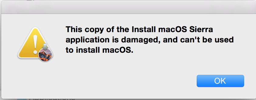

I realise this thread has been running for ages, but it seems relevant to my dilemma.
Im fully aware of the certificate issue and have working Catalina, Mojave, High Sierra sticks, but try as I might I cannot get Sierra or El Cap to install. Side issue is that suddenly I can't create a Sierra stick, which is how I found this thread.
I have downloaded the new Sierra installer and still cannot create a bootable stick as I get this error "Untitled is not a valid volume mount point", and also Install Disk Creator comes up with an error.
I can create an El Cap stick (terminal or Install Disk Creator) but the ElCap stick comes up with the "may have been tampered with" error and won't run.
The most recent Sierra installer I downloaded is from the link above in the this thread. I extracted it on a machine running Sierra as you cant right click and "Show Package Contents" (anyone know how to sort that too please?) Tried to run
sudo /Applications/Install\ macOS\ Sierra.app/Contents/Resources/createinstallmedia --volume /Volumes/Untitled --applicationpath /Applications/Install\ macOS\ Sierra.app
and of course that failed with "Untitled is not a valid volume mount point" again.

Thanks dude, ill report back if it works.
I ran the command and that part of the puzzle seems resolved as its now merrily making the stick. Now I wonder if it will actually run as an installer???
