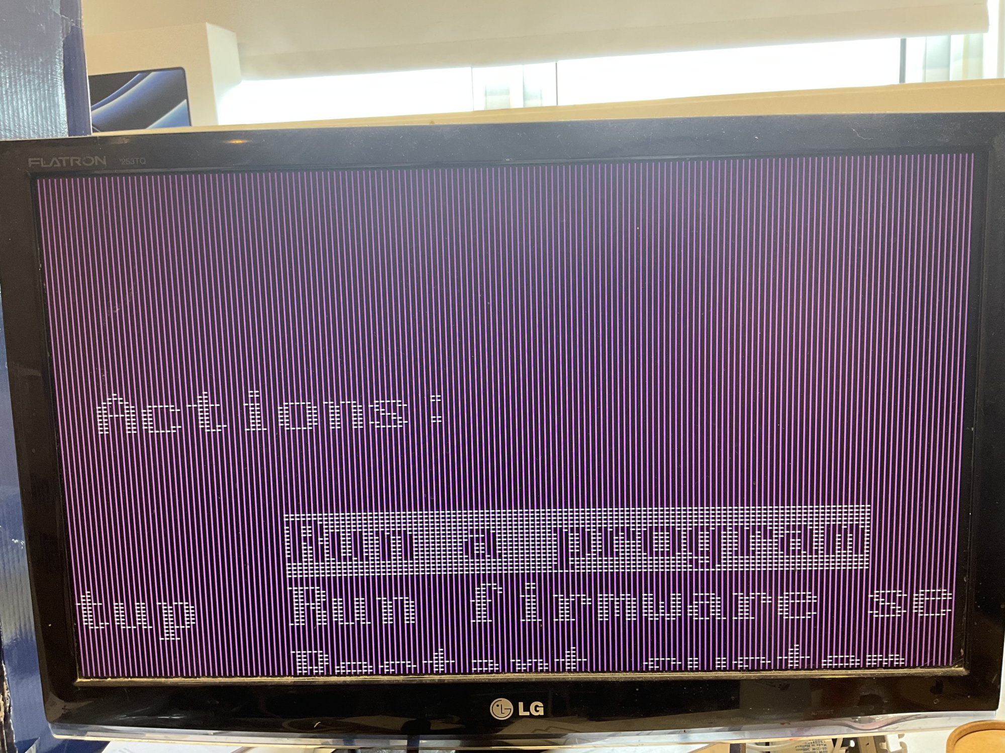

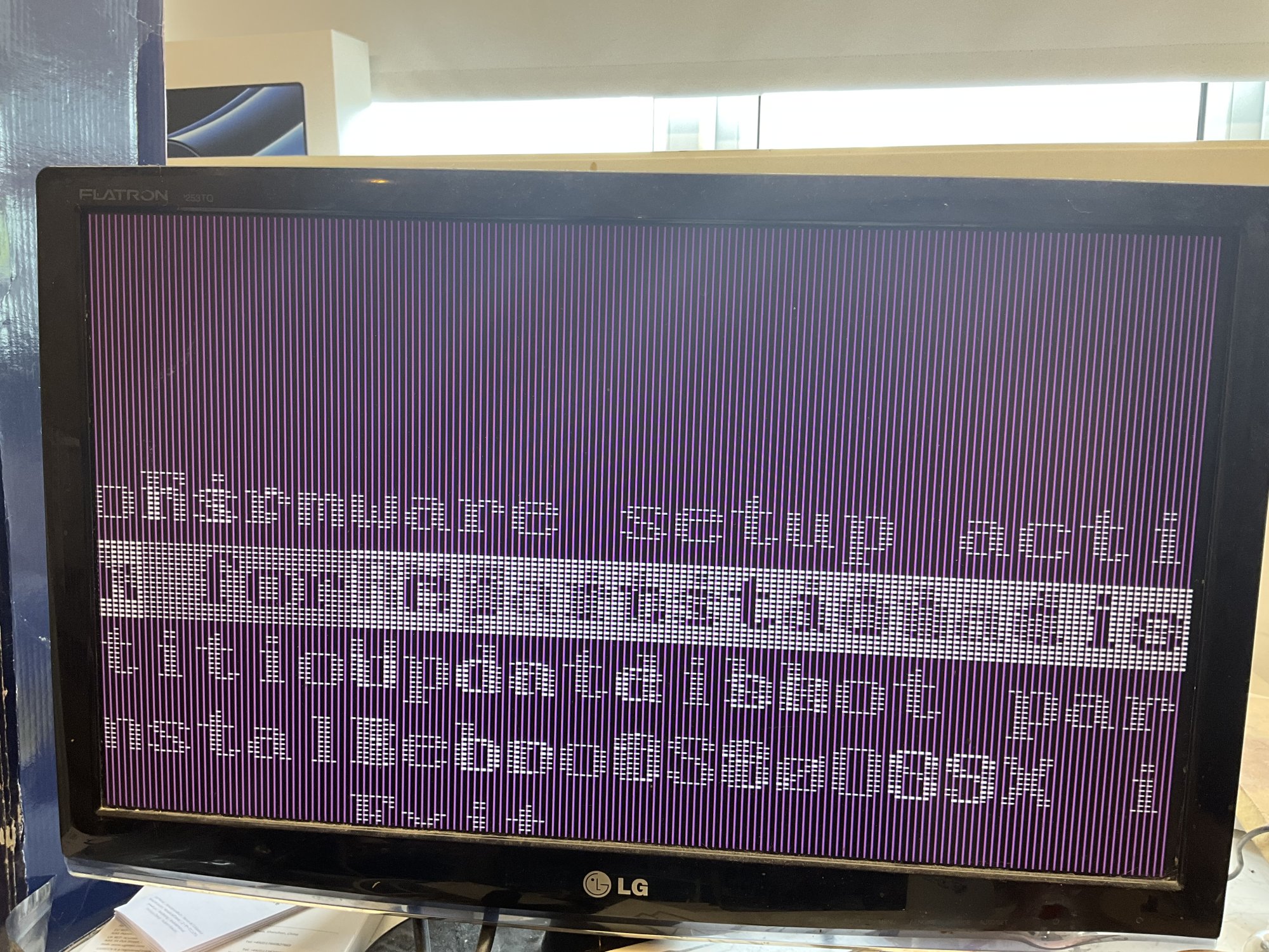

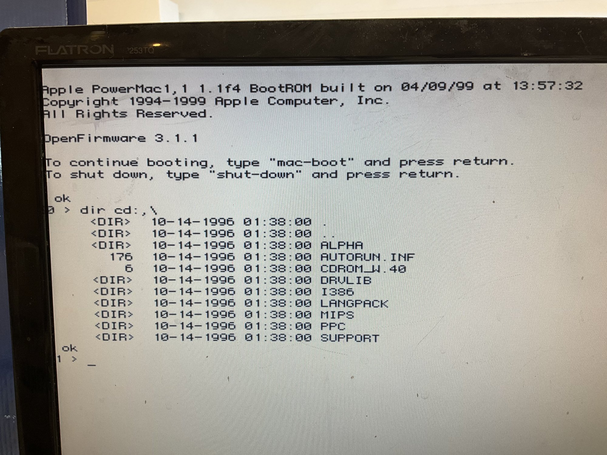

alright very primilarinary results with a G3 Blue and White Rev A, G4 7400, 1GB SDRAM, Rage 128 setup
sadly the display is all messed up on the Rage 128, (on both versions I have)
so the menu is not very navigable

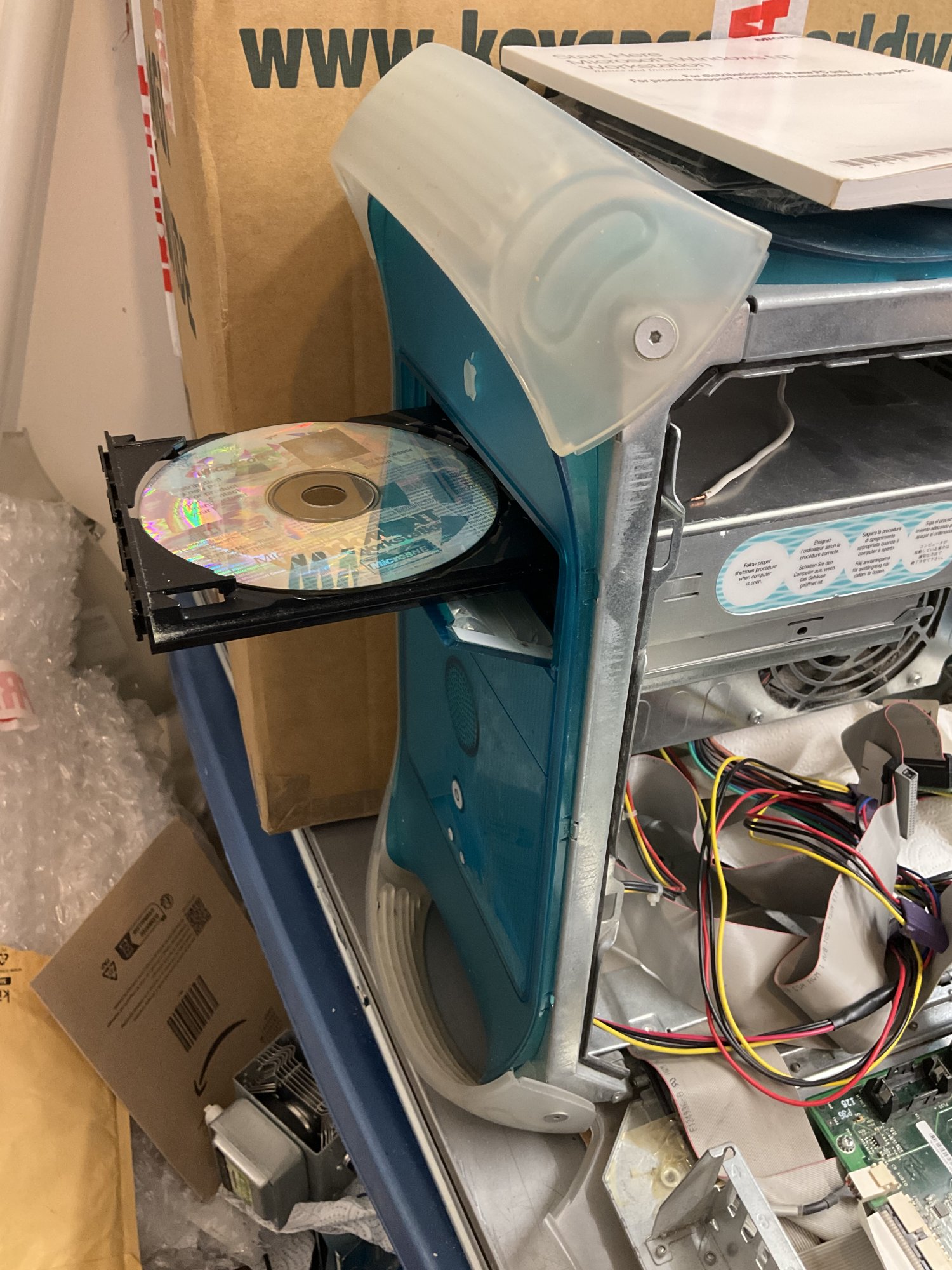

but I still thought for giggles, it would be rude not to :) I unwraped my sill shrink wrapped OEM copy of NT4 Workstation, popped the disc in the ODD
actually verfied the disc was universal version, so was not unwrapped in vain LOL
and I pointed the boot loader towards the CD's setupldr as per the instructions and I actually got the Windows NT setup screen :)
not got any further, because I have not tried to format any drive, I am not sure if I would be able to with the messed up menus? but its pretty cool to see none the less!
sadly I dont have any ATI Rage Pro based PCI card to try or I would :)

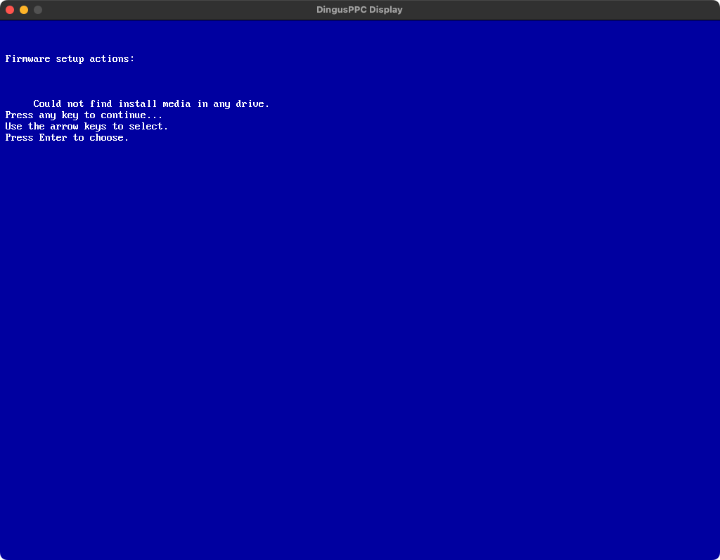

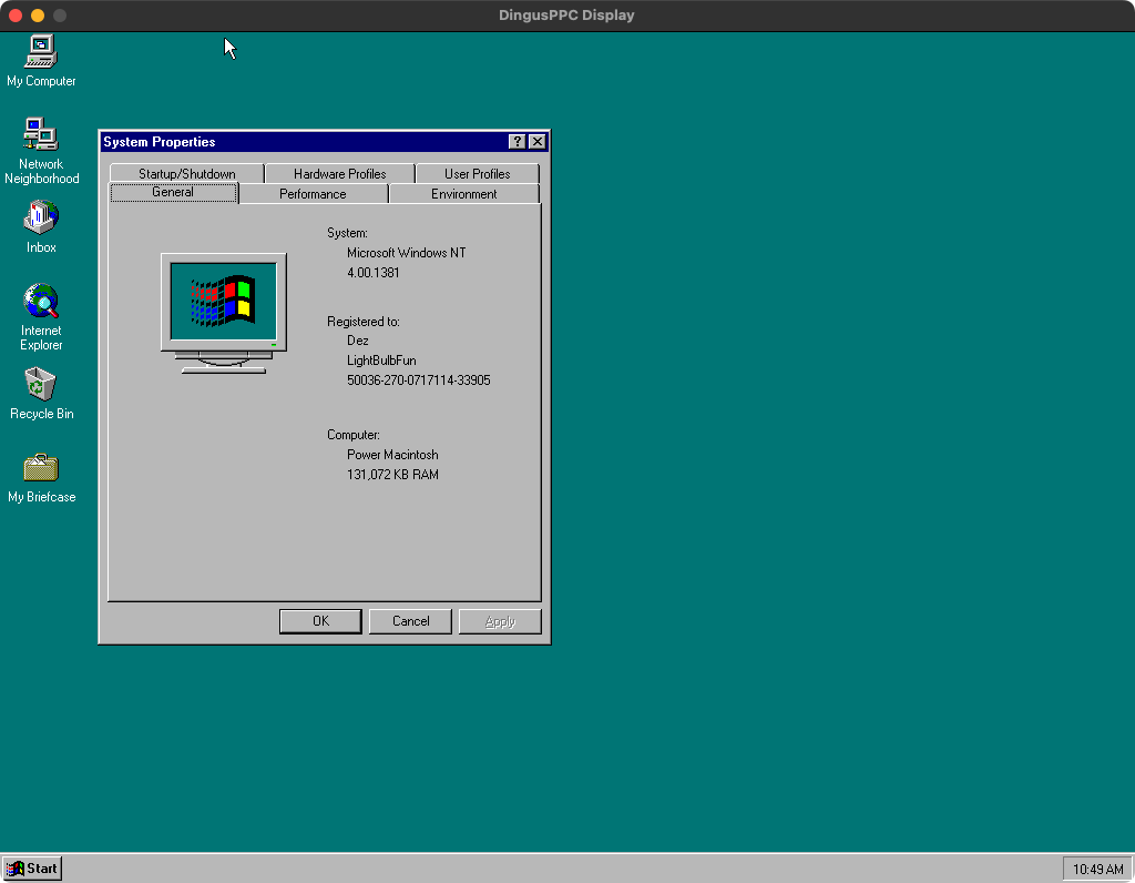

@Rairii trying it in your custom build of dingusppc I cant seem to get any further then this when I go to try and format the drive, I have tried to create the custom installer image a few different ways but it seems it cant find itself (although it does see both the cdrom and hdd on the previous page) this was with release 0.02, should I try one of the nightly builds, or am I doing something wrong? :)

maybe try neozeed's pre-built installer image? it can be found in his blog-post:
Sweet! I was able to use this to make a working image in @Rairii's port dingusppc

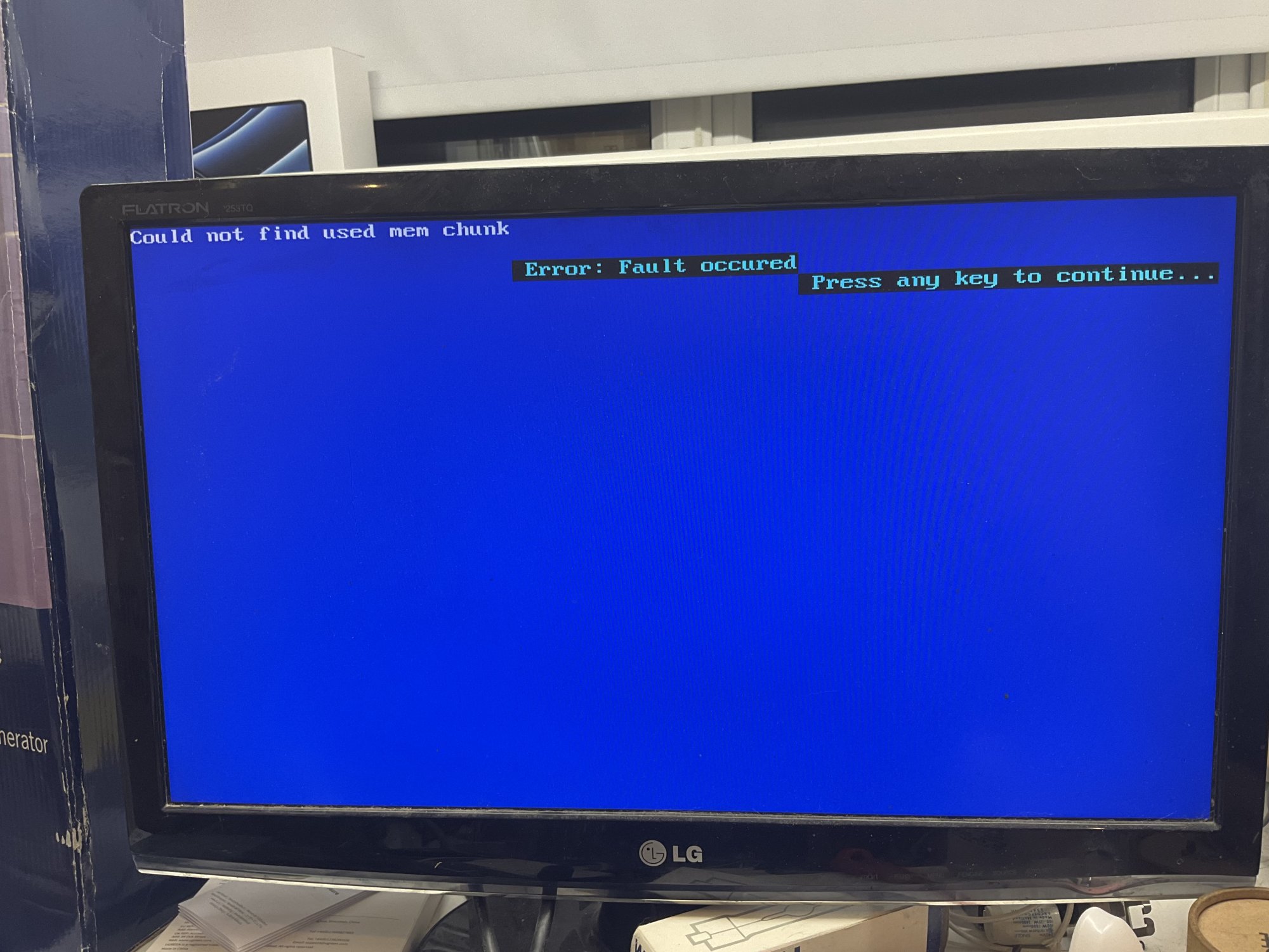

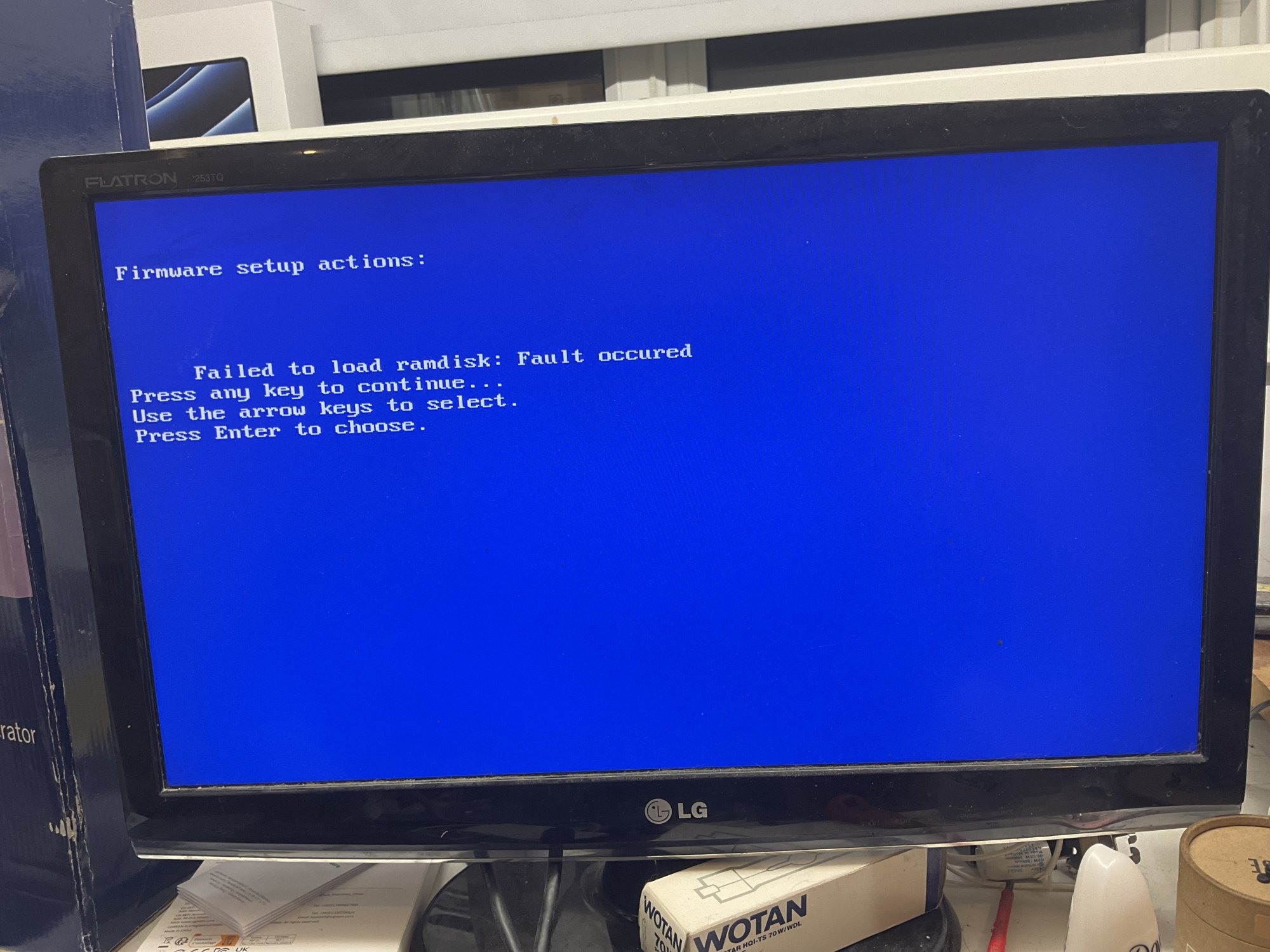

but even after updating the image to the latest 0.03 release I seem to be unable to boot it on my G3 blue and white, although I am just taking the 1GB image I made and DDing it to a larger CF card so I dont know if thats upsetting things, the the ARC firmware does still see the drive etc but actually trying to boot gives me errors

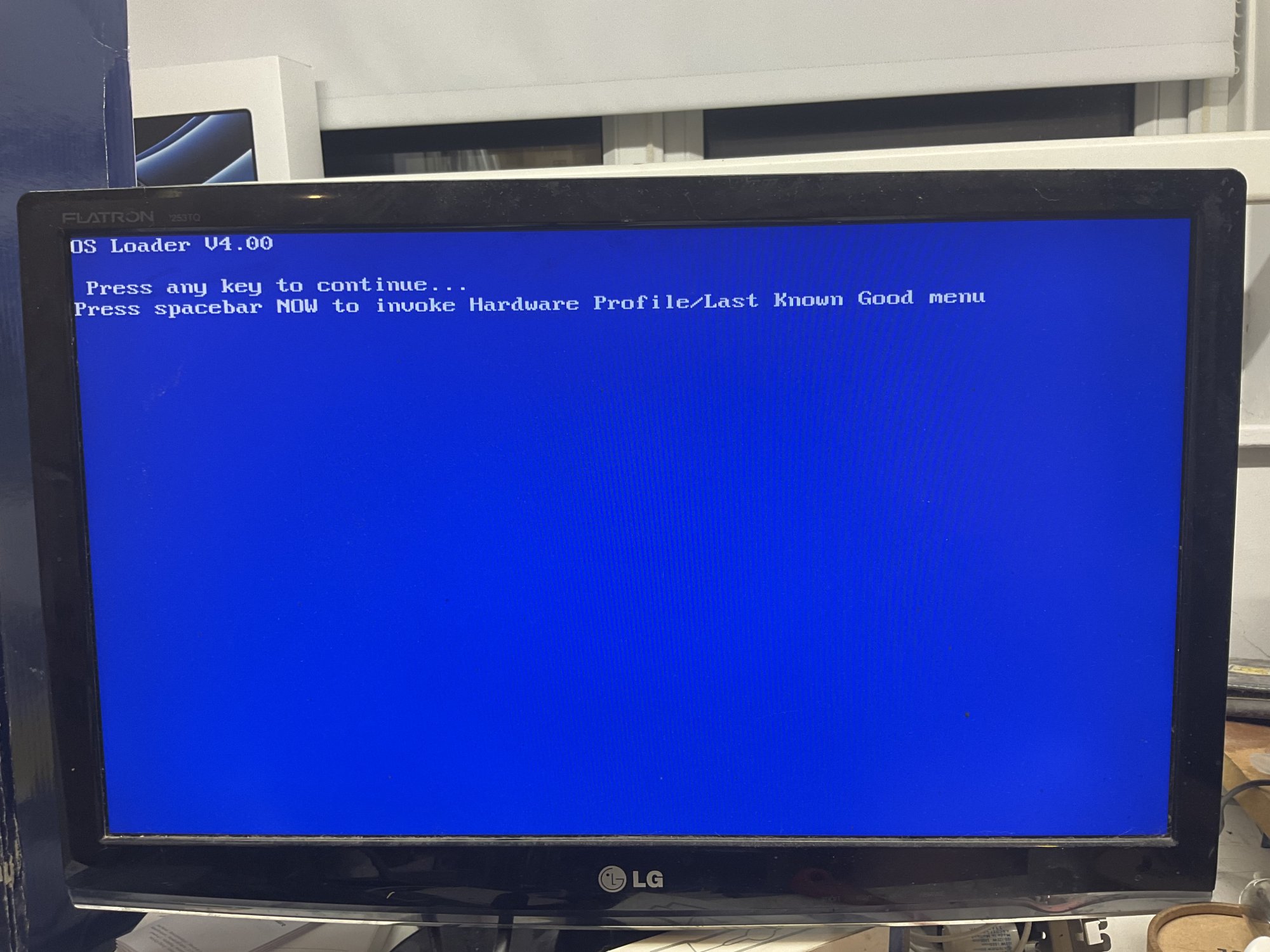

at this point hitting any key, kicks me back to the main menu and trying Start windows again gets me
and trying the load the RAM disk option gives me the above
forgive me if this is just a case of one cannot simply DD an emulator.img to a physical drive, and one has to actually run through the setup on the real hardware with the real disk, but just thought I would mention it just incase :)
(or so that other people know what they can and cannot get away with LOL)

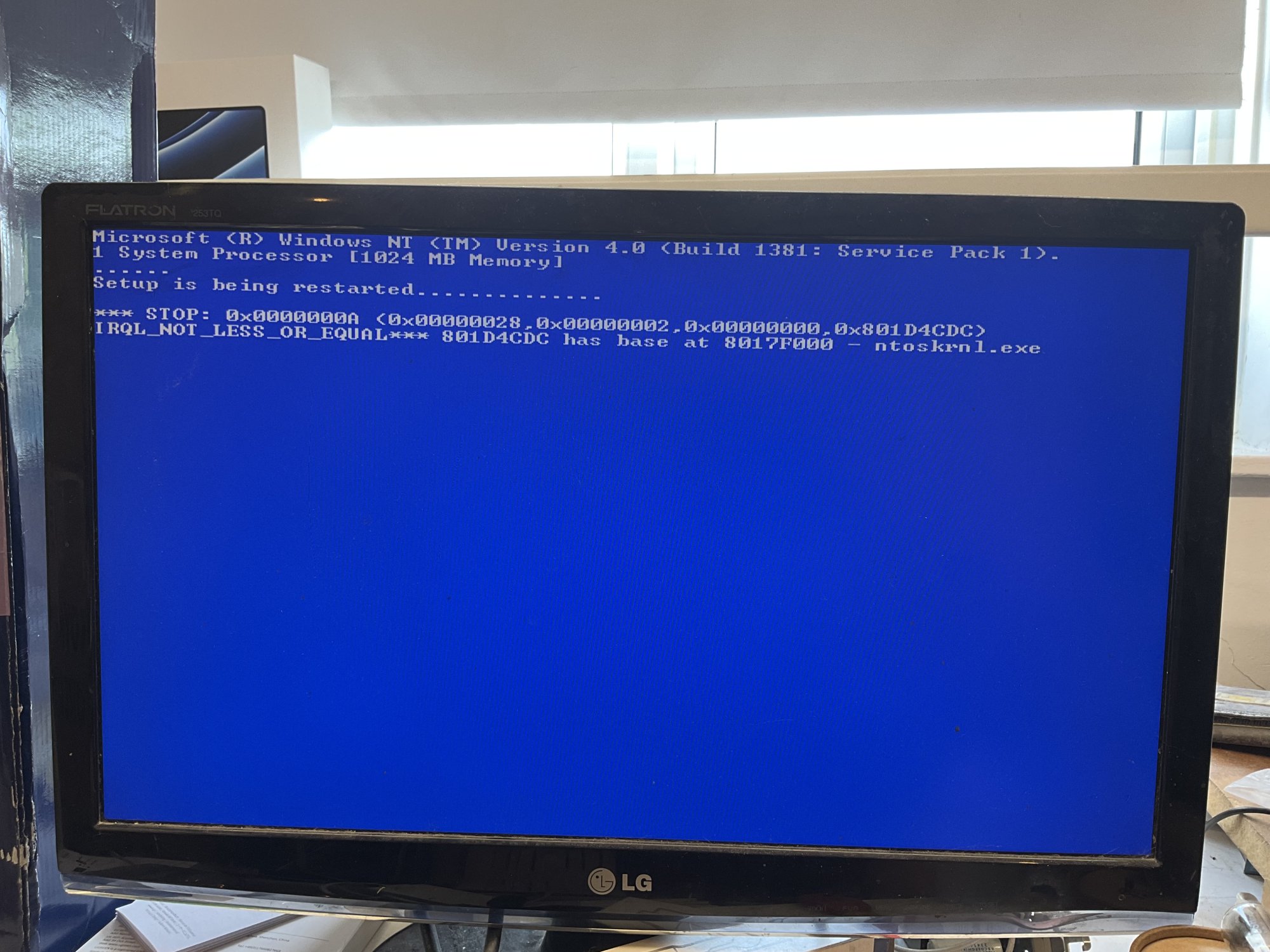

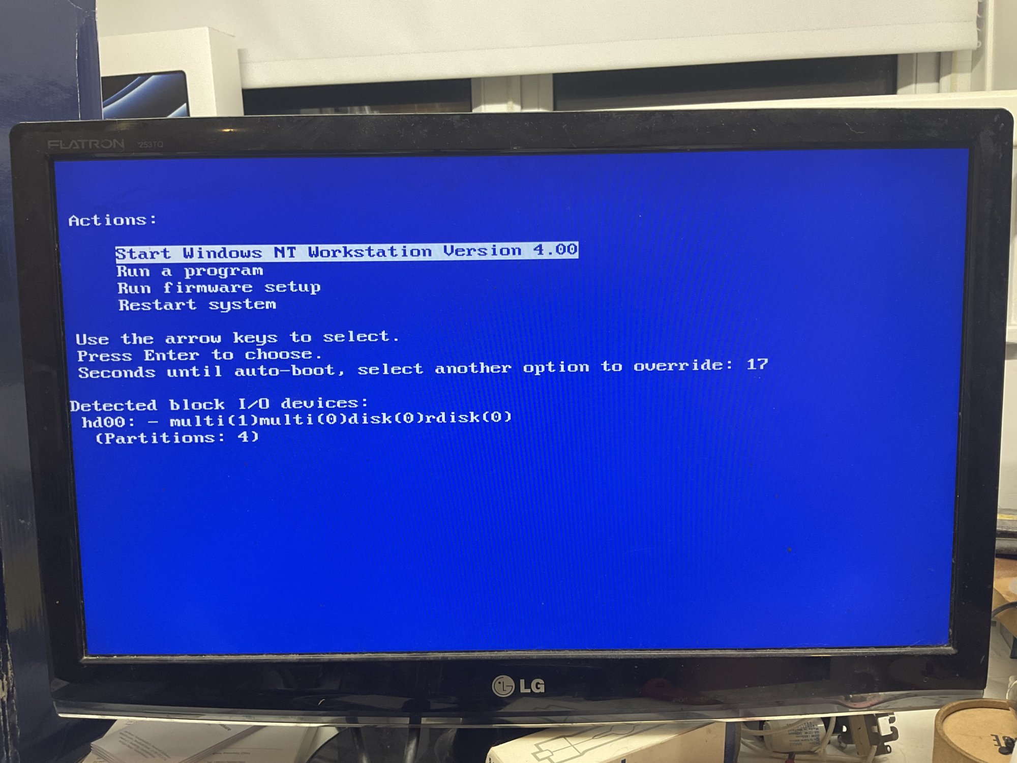

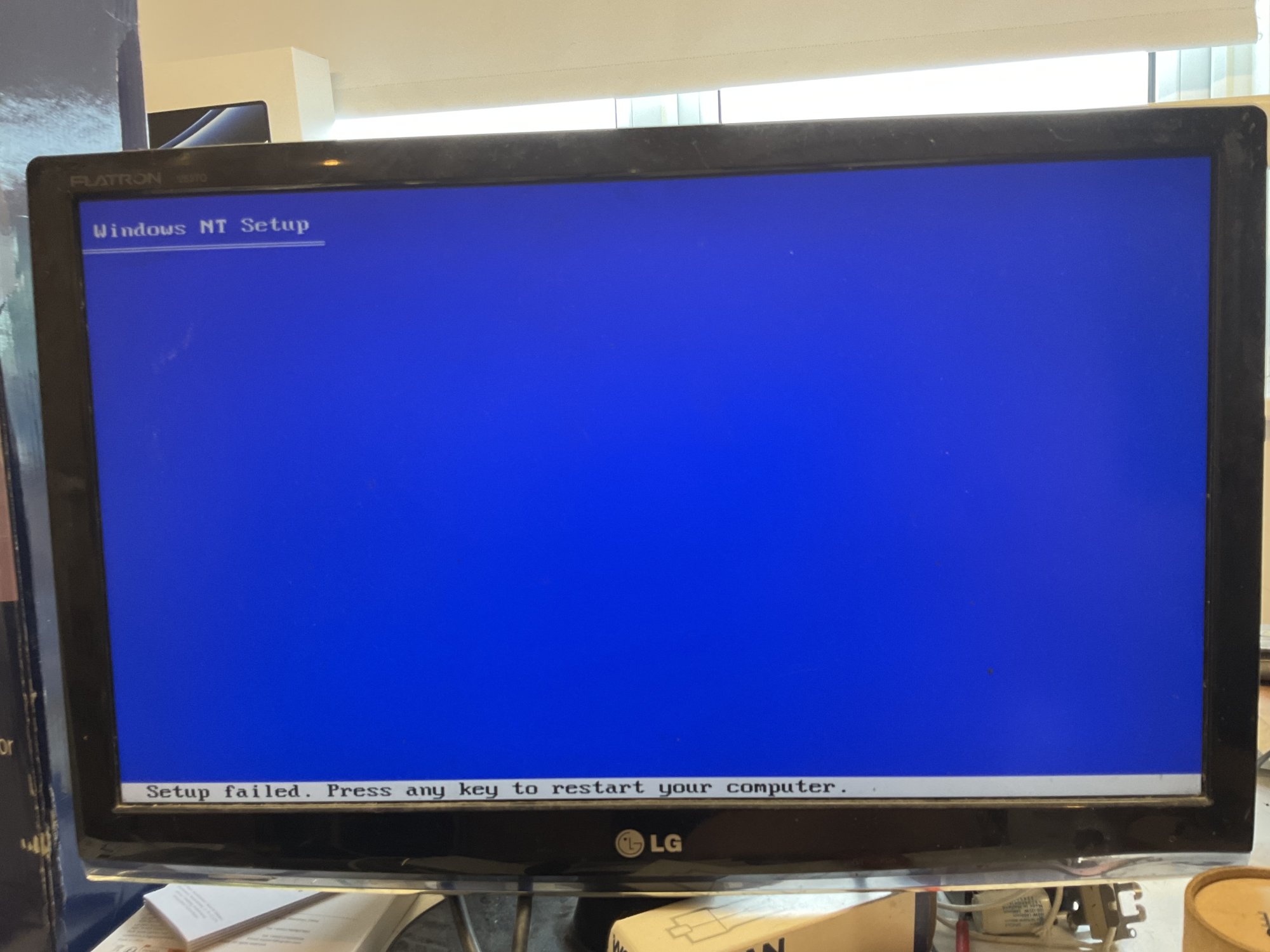

alright further messing around, this time I tried installing with bare metal, I dug up out my CD-R's burnt a 0.03 release loader which itself seems to work :) i can load the RAM disks no problems and parition the hard drive alright (this is with the HDD as master ODD as slave so im booting the ODD via the zip alias zip:,\\:tbxi) but sadly I cannot seem to launch the NT setup itself it just fails right away after doing run a program cd:\ppc\setupldr step, not sure what to try at this point, I did with a minimal amount of RAM still got the same error, I wonder if it does not like the G4 7400 CPU I have installed? sadly I dont have a G3 ZIF to hand to try that, but yeah thought again I would post for information sake :)
Reactions: mikeboss
Someone else has had a go on a B/W.
yeah turns out NT4 actually has PVR check and bails if its not one it likes! who knew NT4 PPC of all things has a CPU check like that!
there is meant to be a patch in the ARC firmware to stop NT from bailing but it seems to not be working atm sadly, hopefully its fixed before not long :)

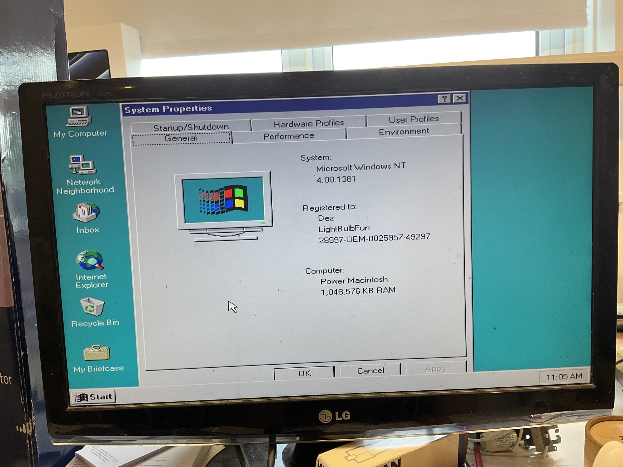

Woop! took a bit of finagling with general G3 Blue and white Rev A general cantankerousness, had a point where just after installing it would not boot the graphical setup until I went down to 512MB of RAM but dont know if thats a bug or my G3 blue and white just being itself
but I finally got NT4 SP1 running on it, using @Rairii's 0.04 release :) (this is onto a 10GB Segate drive as the master device on the Paddington ATA bus)
tis seriously awesome :)
