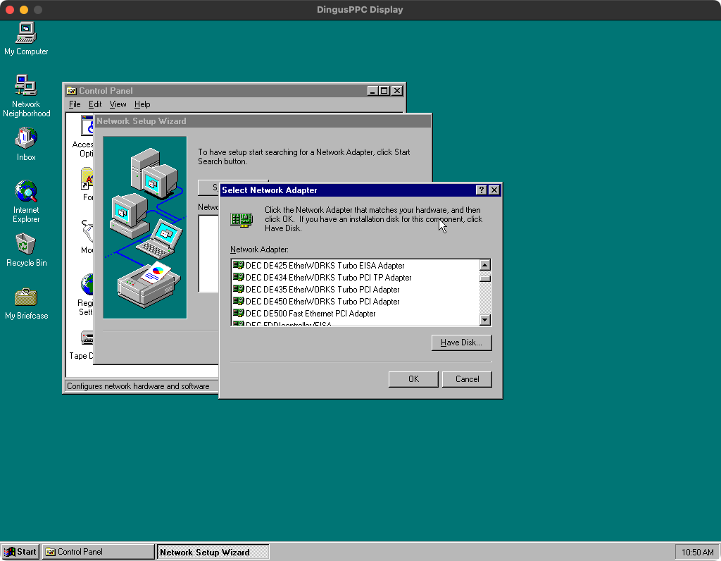

could you try: Control Panel -> Network -> Yes -> Next -> Select from list...
I have NT4 SP6 (Service Pack 6a) running on MiSTer/AO486. the most promising ethernet adapters in the list of available drivers would be (found some adapters offered on ebay):
DEC DE 434 EtherwORKS Turbo PCI TP Adapter
DEC DE 435 EtherWORKS Turbo PCI Adapter
DEC DE 450 EtherWORKS Turbo PCI Adapter
DEC DE 500 Fast Ethernet PCI Adapter
are these drivers also offered on NT4 PPC? I was looking all over the internet for 3Com-NT4-PPC (3C905-TX) drivers. so far no luck...
EDIT
according to this document, drivers for the 3Com 3C595-TX should exist:

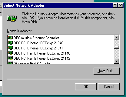

I also notice that the DEC 21041 is on the list, I actually have one of these that came in my PowerMac 4400 so ima try that in my G3 BW see what happens

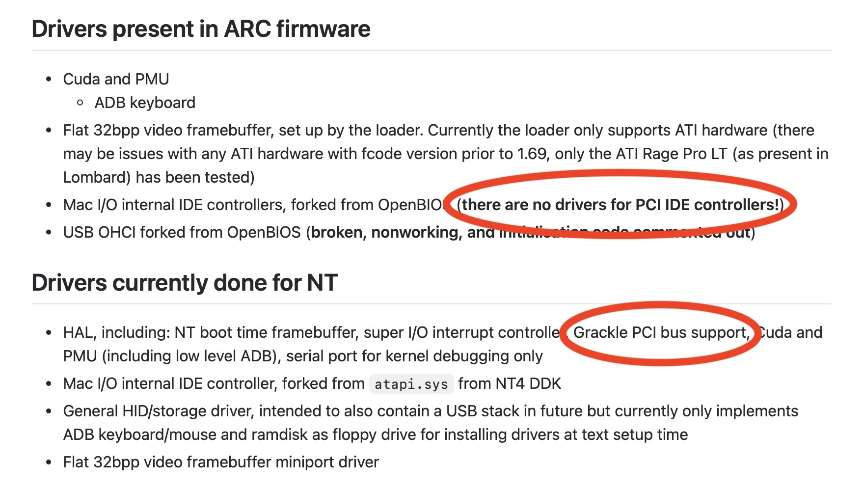

The easy way to test is if PCI IDE controllers work fine in NT (not in ARC). atapi.sys should detect those fine, I'm just not sure about the PCI interrupt code in the HAL yet...

A different question: is it possible for the nt to see any physical PCI card at all, f.e.an Ethernet card or a PCMCIA controller?
The HAL can enumerate the PCI bus fine, the main issue is that I'm not sure if the PCI interrupts are working. I tried to implement them but haven't actually checked if the implementation works yet; if it does, then the PCI IDE controller on Yosemite should work under NT (not ARC firmware), but I don't think anybody's checked yet.

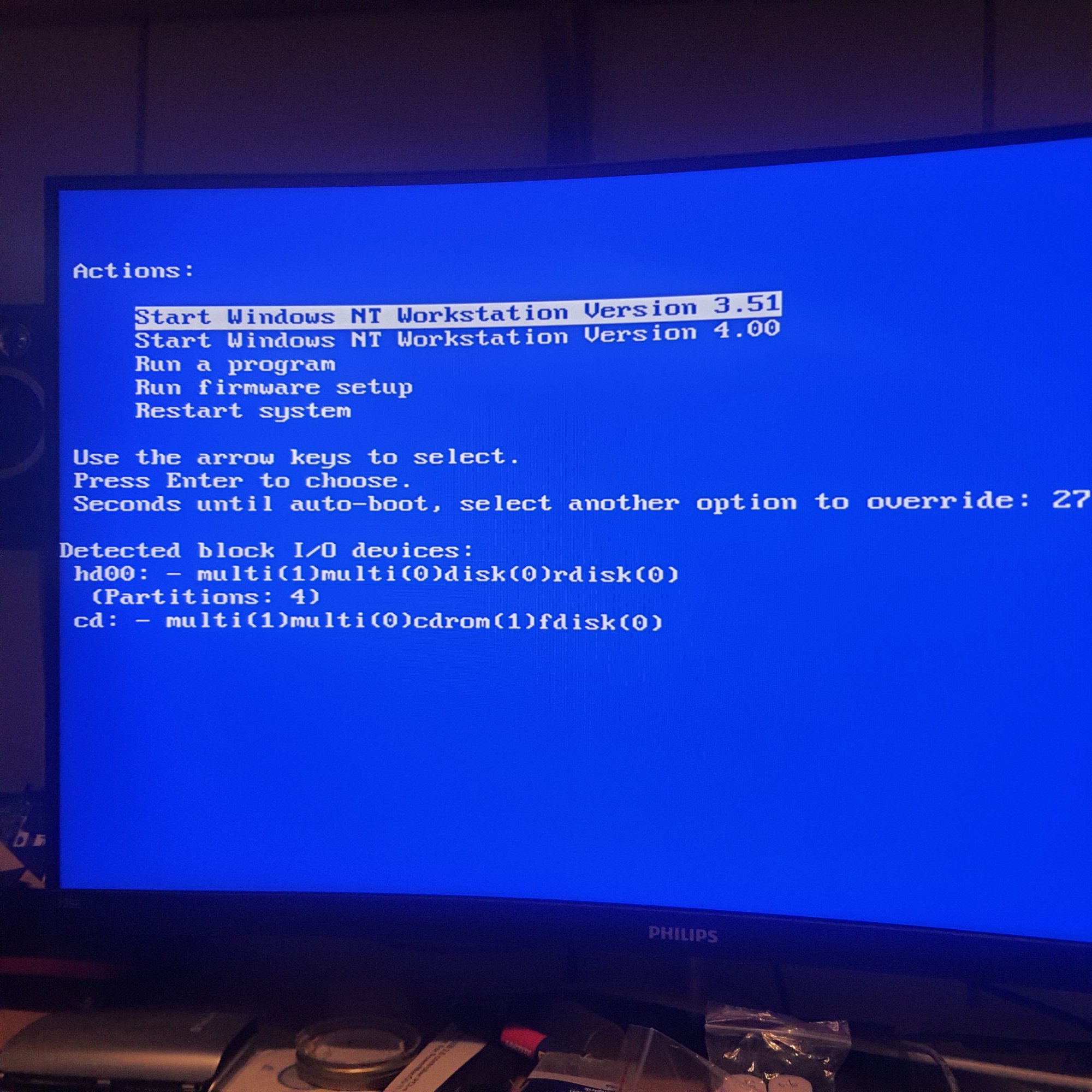

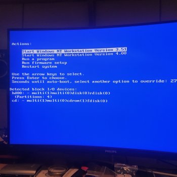

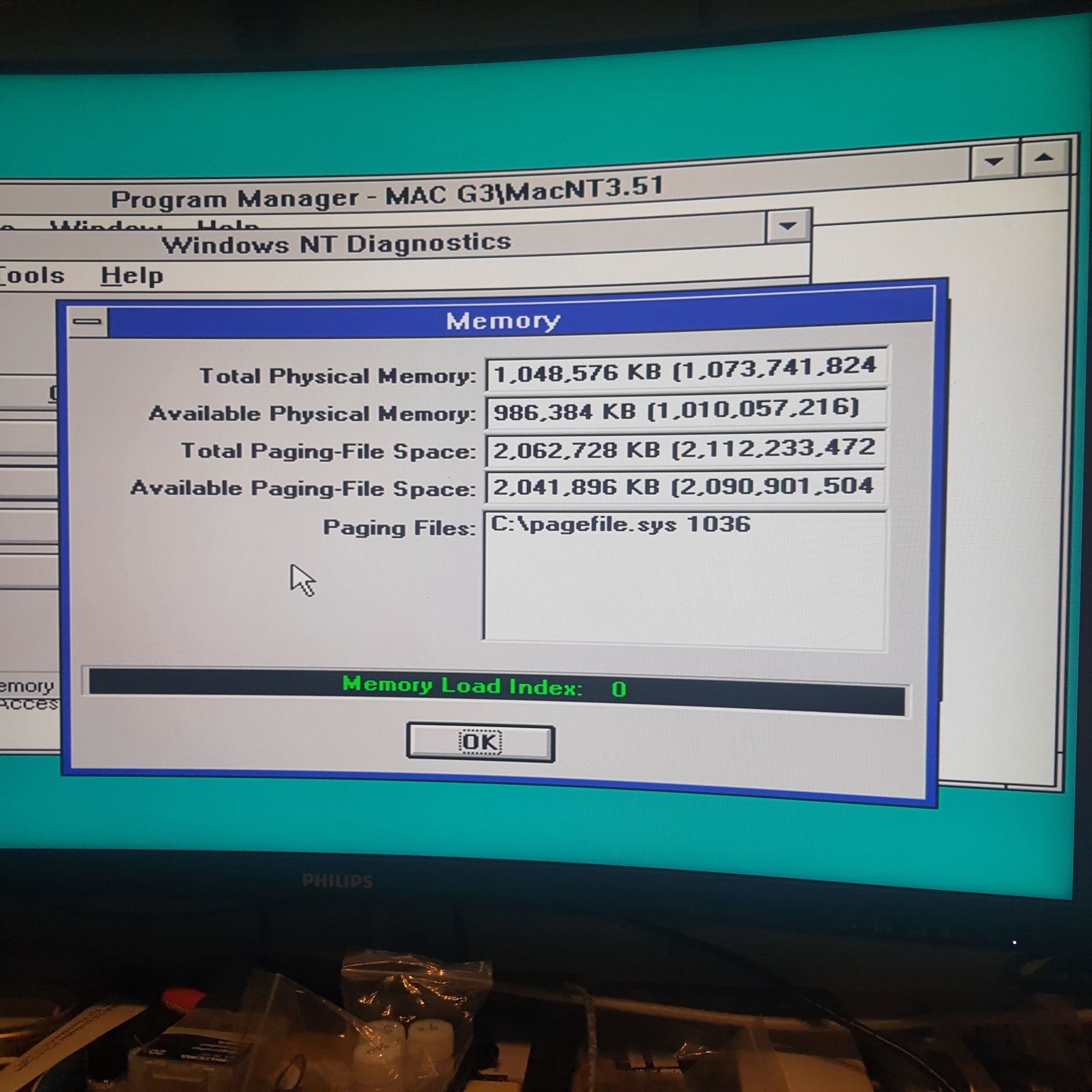

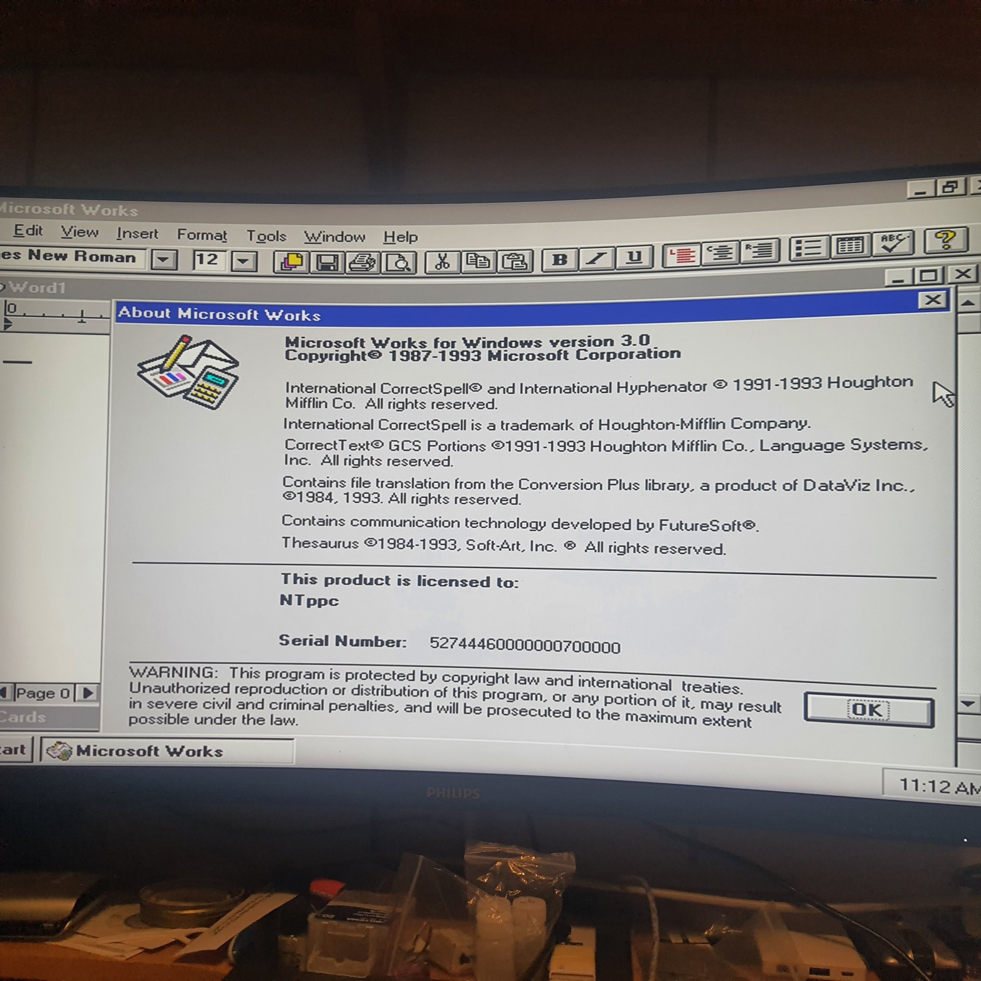

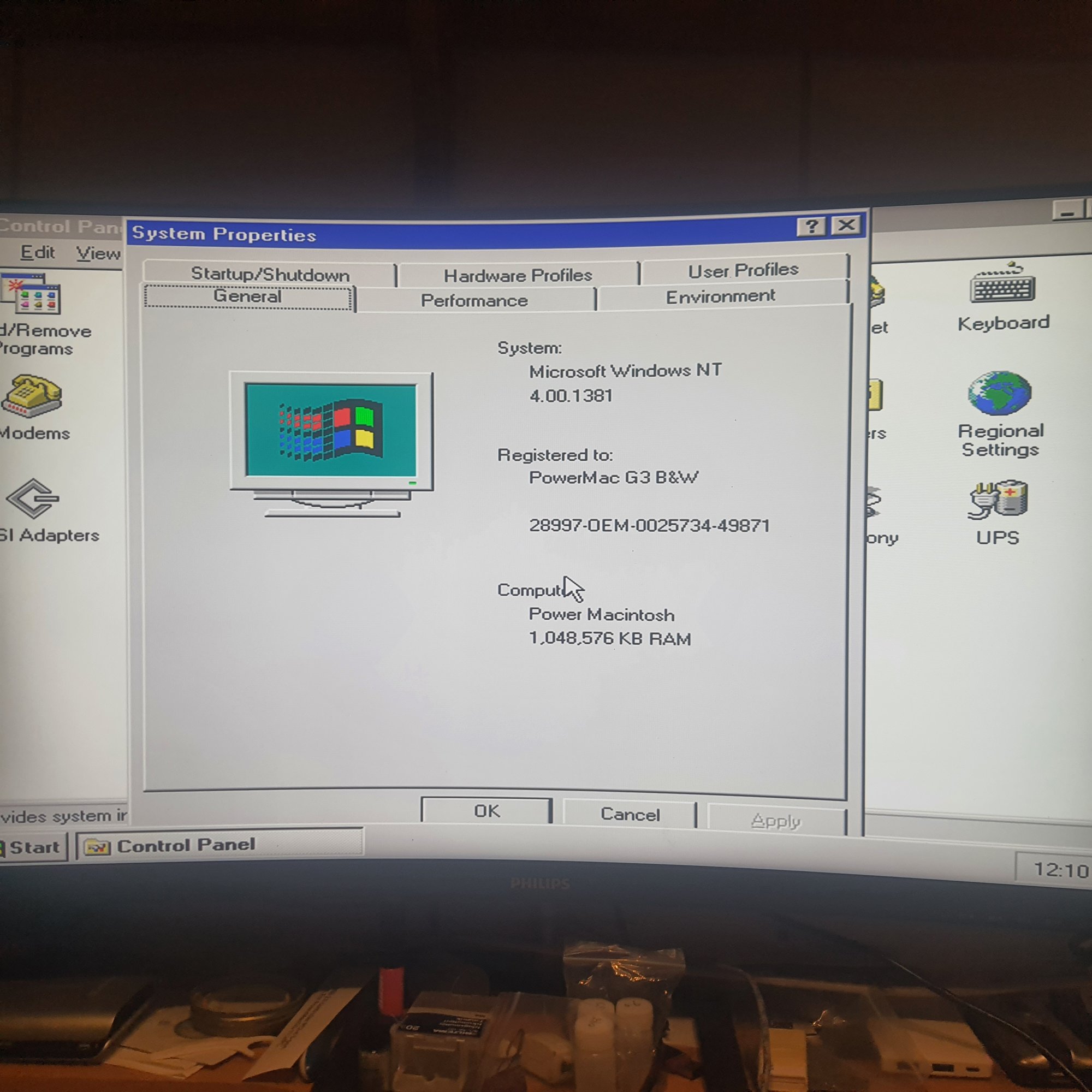

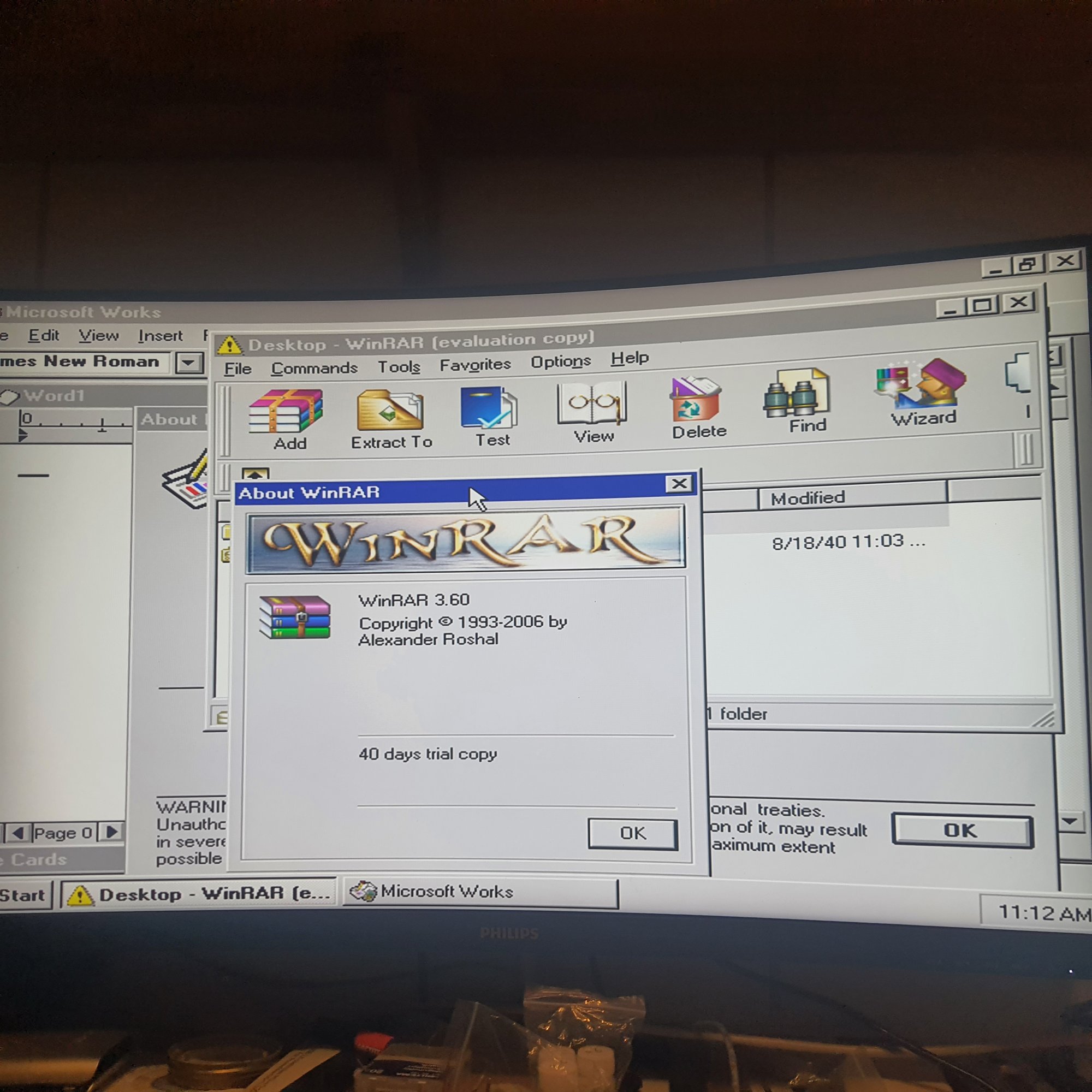

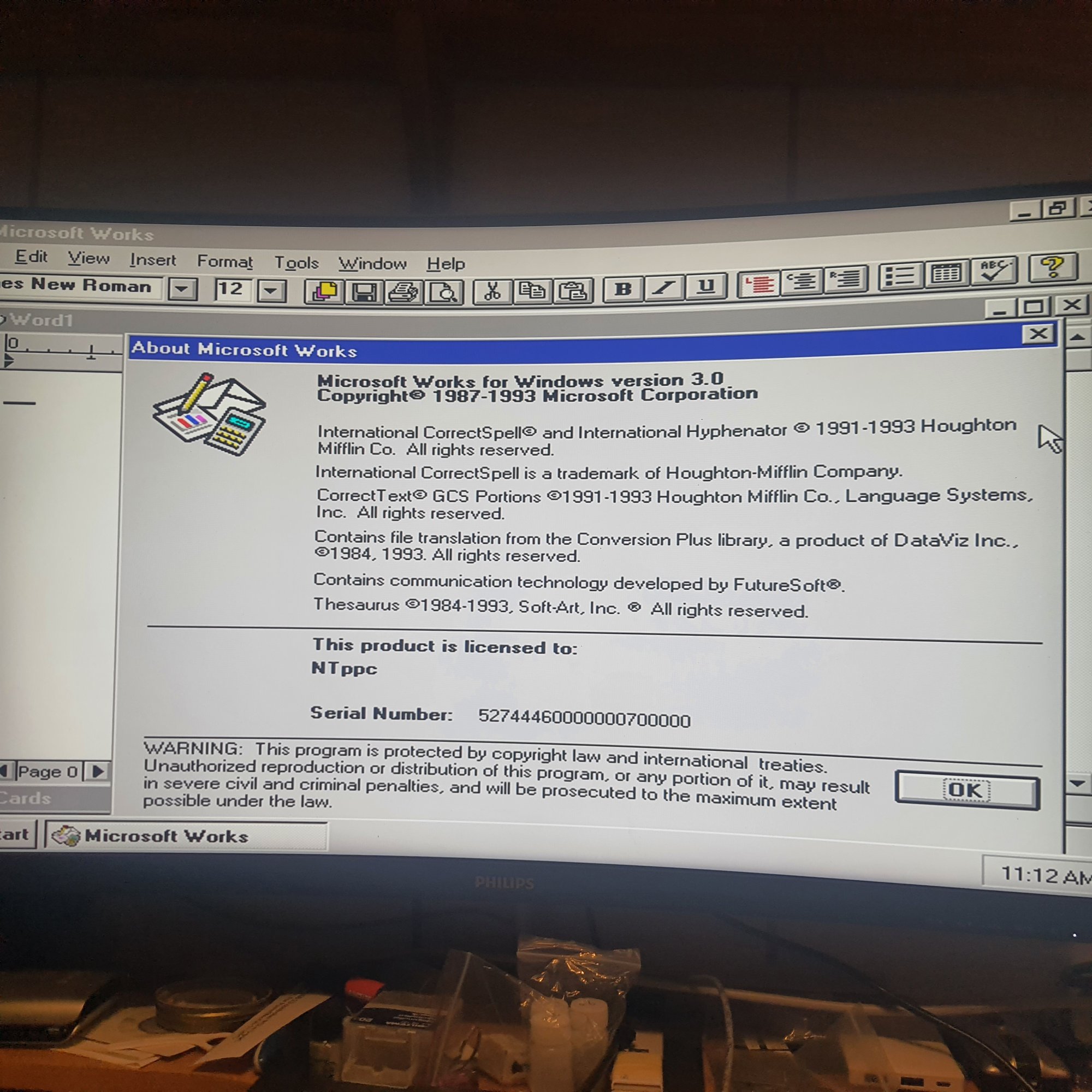

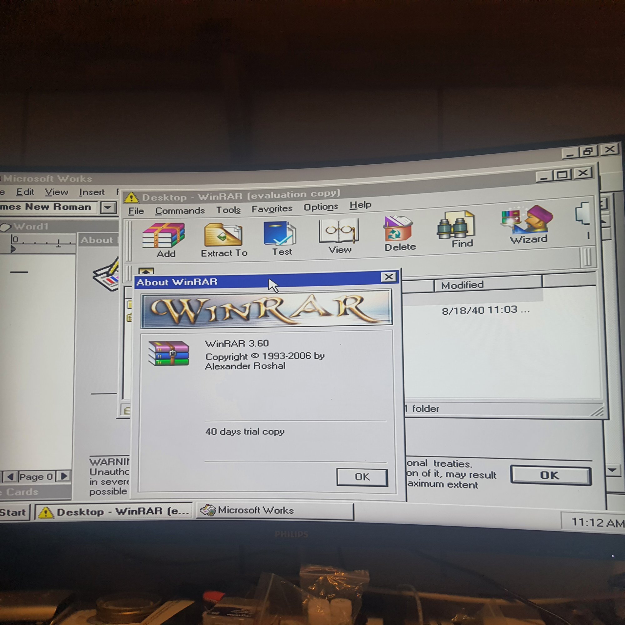

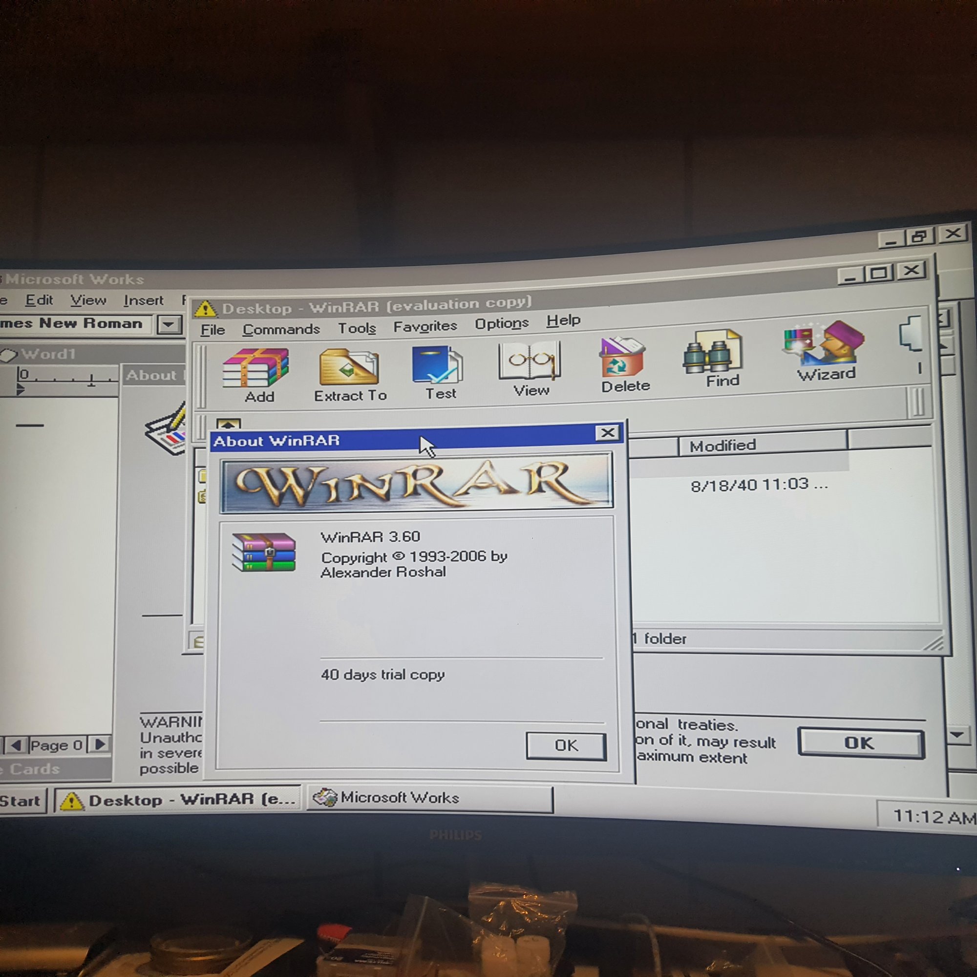

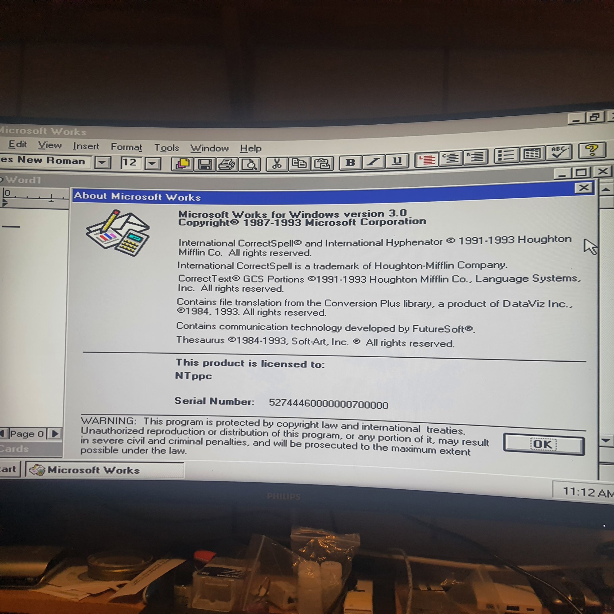

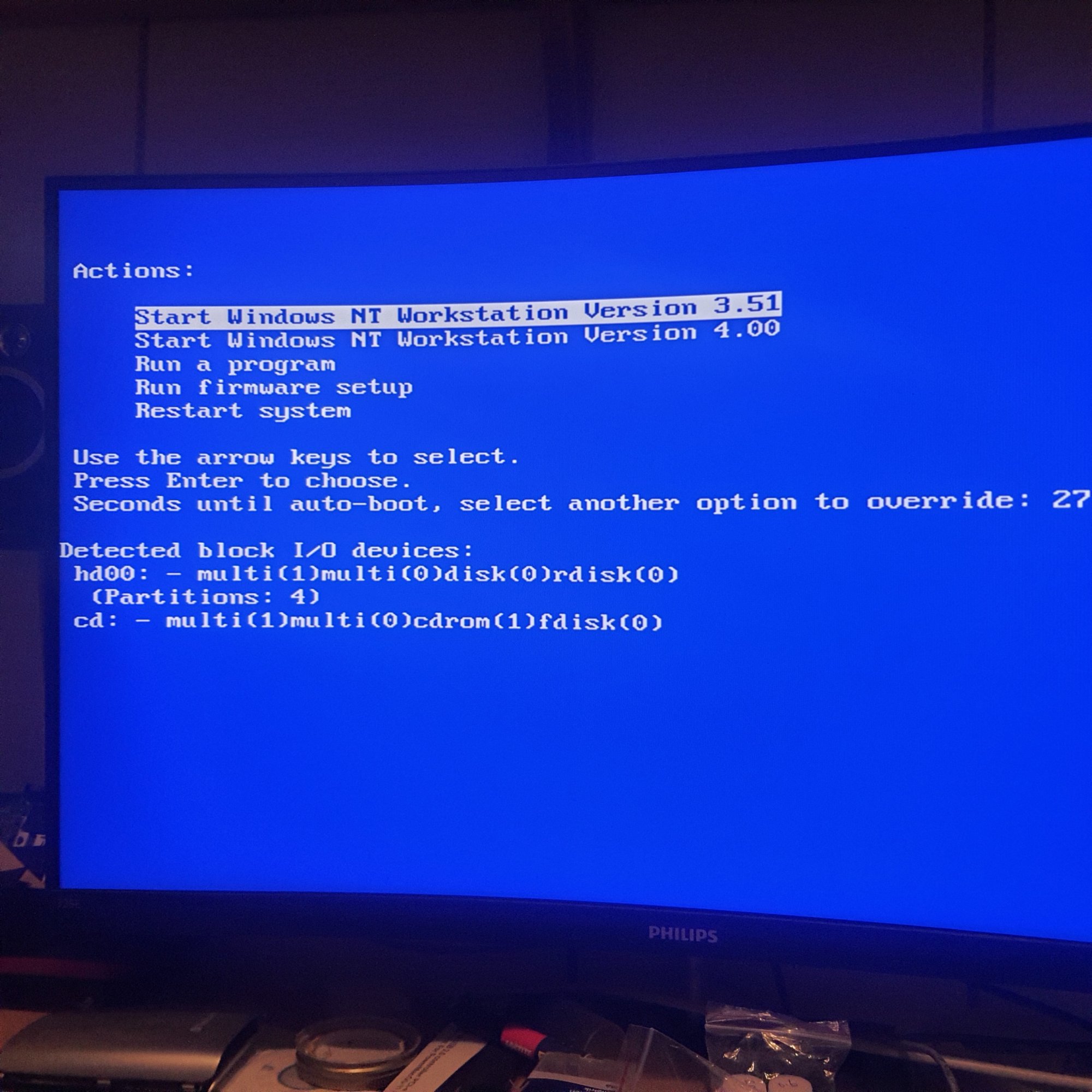

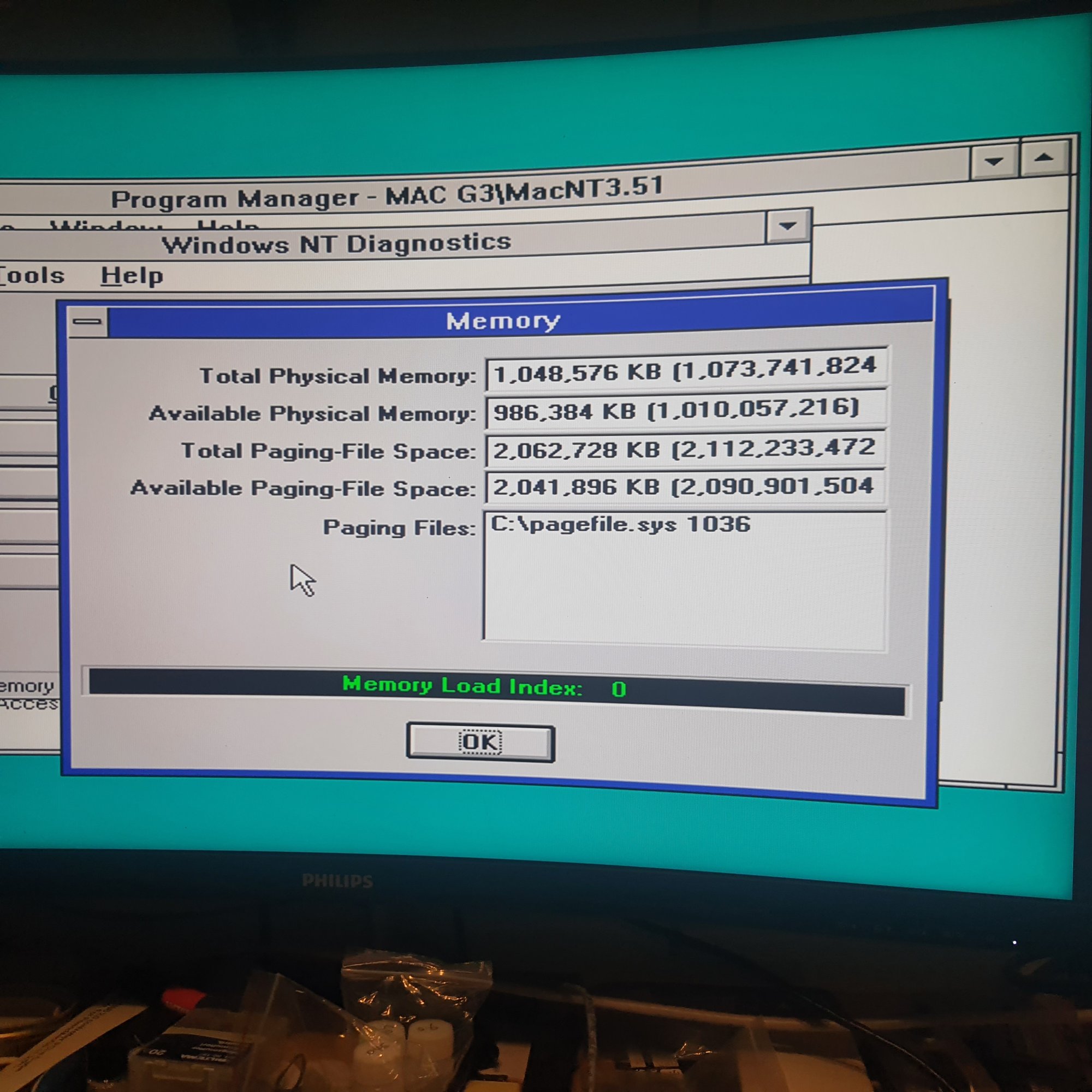

I did it again 🙂
This time in dual boot with 0.05 loader. Everything seems to be fine Atm.
