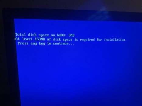

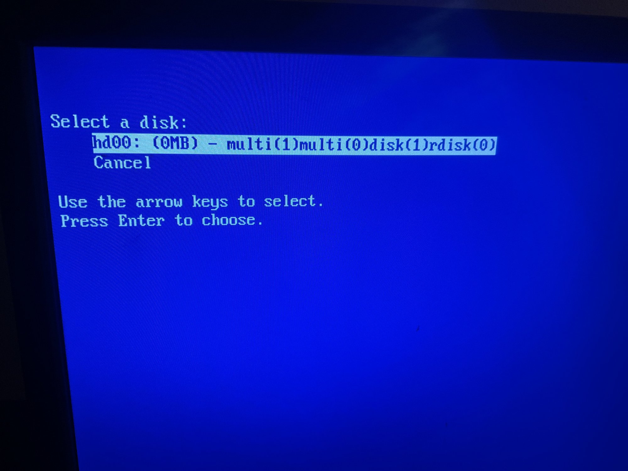

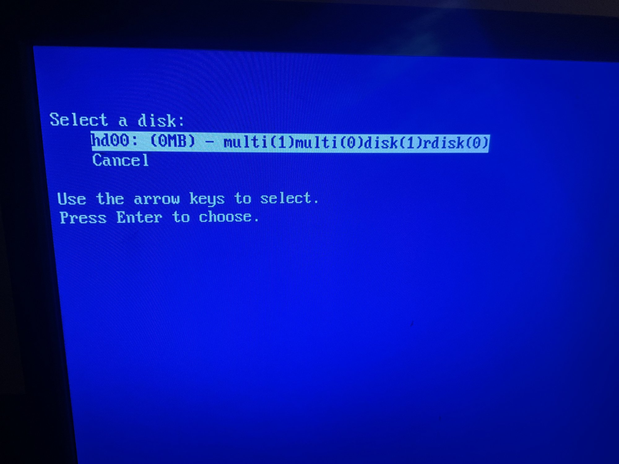

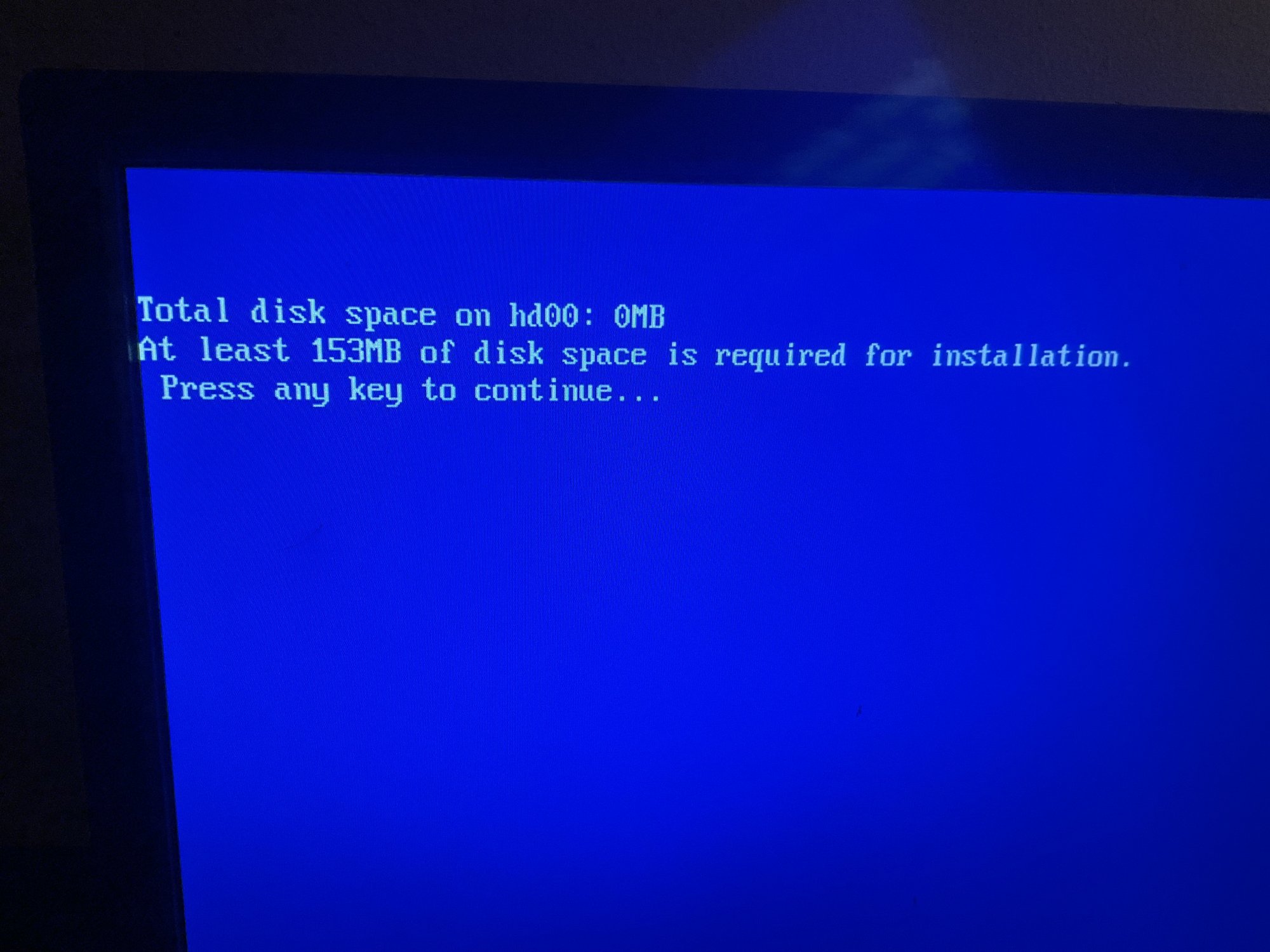

I set up my B&W since it’s the only real compatible Mac I have (I have two tray loaders but soldering an ADB port is beyond my current abilities).
Anyway, I just removed my OS9 drive and found a random IDE disk to use for NT.
It’s detecting it as 0MB and won’t let me continue.
Here’s some more details, maybe someone has some insight on whether or not I have something that would be causing this.
I do have an ATA133 PCI card installed, but the disk in question is on the built in bus. I only use the PCI card for OS X, which is all usually use on here as it normally has A Geforce FX 5200 in it. I replaced it with a Rage 128 for the sake of this project.
The disk I plugged into the onboard IDE bus is an “80GB” drive. I made sure it was recognized by OS X before booting the ARC CD.
The B&W also has an ethernet card installed, and a factory ZIP drive slaved to the optical drive.
Is there something wrong with this configuration that would be causing this problem? Having the ATA card installed at all maybe? I was under the assumption it just wouldn’t be recognized.

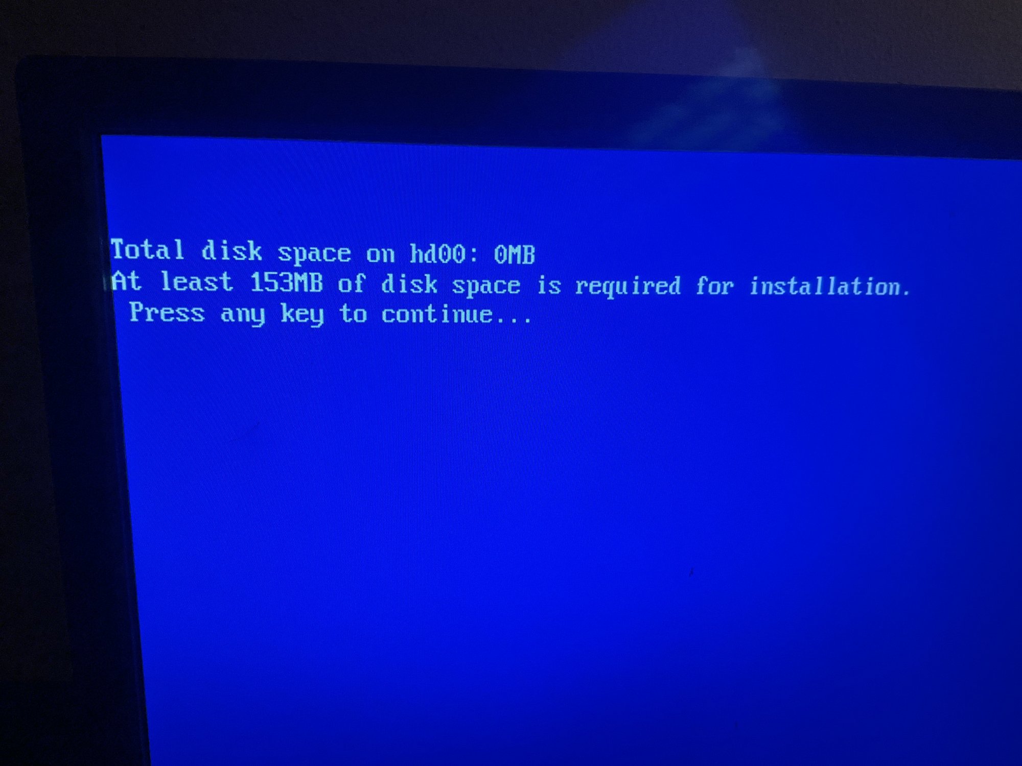

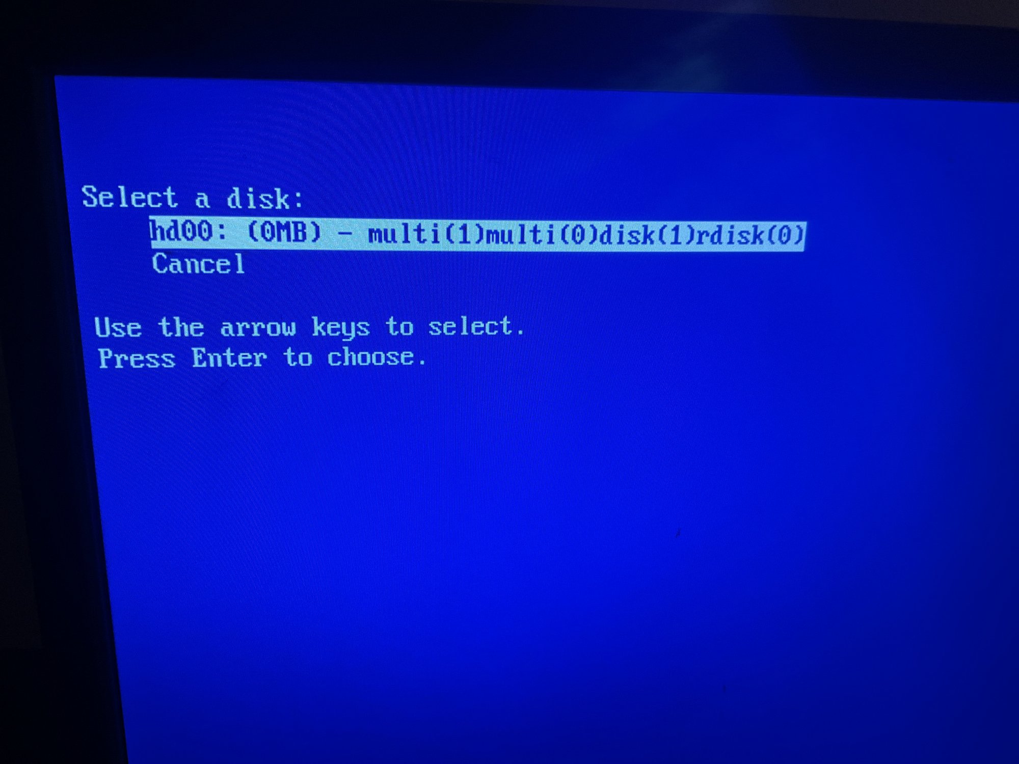

View attachment 2400018View attachment 2400017
The primary ATA bus isn’t supported. You’ll need to disconnect your Zip drive and put the hard drive in its place. Set the HD as master and the CD-ROM as slave.
