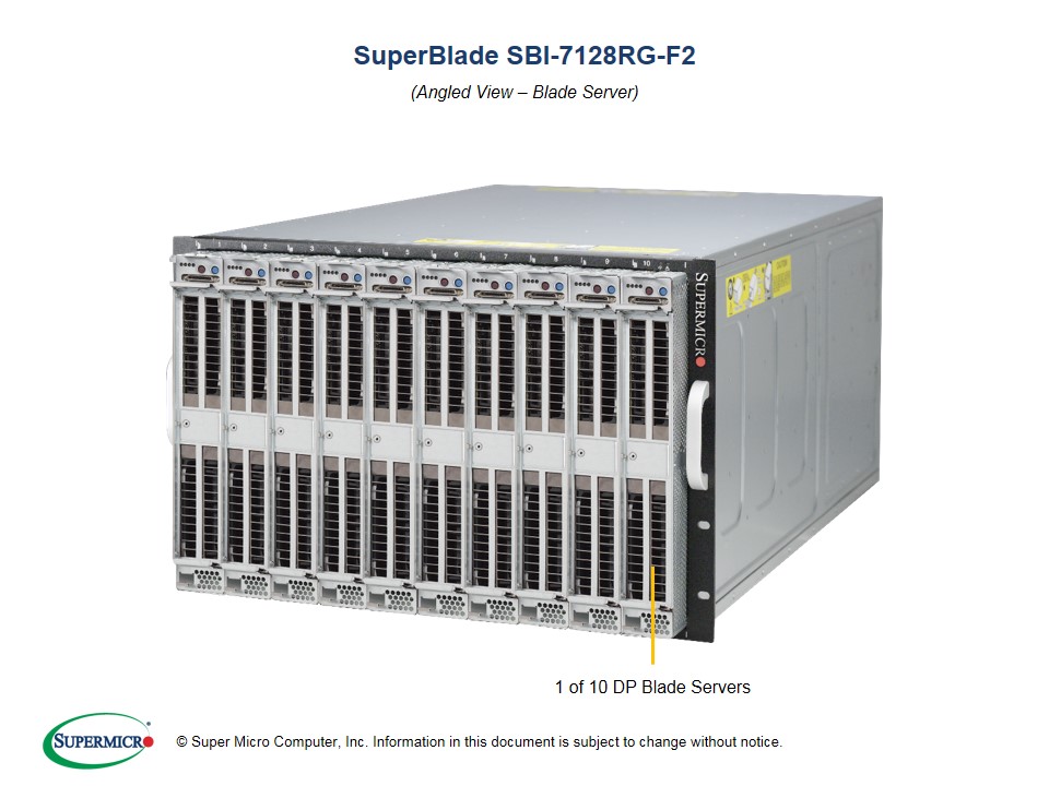

The blade has an intake at the bottom on the front.
Another question is what would happen if you have both intakes and exhausts on the same side.
Exactly
You see the vent openings for 20 Tesla cards.
I am not saying it would probably work, just that there are 3 additional vents and powerful fans.
I understand that the two at the rear probably can't work as intakes, because from the manual it would seem the PSUs pull from this area.

There's no intake fan. If you add a blower it would be perpendicular to the rear fans.
Where this loses is if the rear bay area flows directly into the PSU, and that even if the three small intakes if this was not the case the openings are probably not big enough.
Then there's the problem of the intakes being next to the exhausts.
After that there's the problem of stacking in a rack, and opposing racks.
Maybe the last problems would be solvable with a floor-ceiling push-pull room.

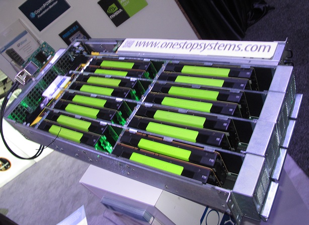

I saw lots of 3U boxes at GPUtech today, with up to 16 dual-slot GPUs. (One is the "16 eGPU" image I posted a few back https://forums.macrumors.com/thread...rence-second-day.2043059/page-4#post-24564043.)
All fanless/blowerless. The was one 16 GPU 3U system that had an option for a 4U version - they added extra height so that GTX cards with the top-mounted aux PCIe connectors could be used.

Just as a reference point, today at GPUtech I was talking to the people selling this eGPU box:
About $20K without GPUs.
And it's a eGPU expander without CPUs, RAM, or networking.
(and if I'd posted the full resolution image - you'd see that it has three Tesla P100 cards and seventeen K80s)
