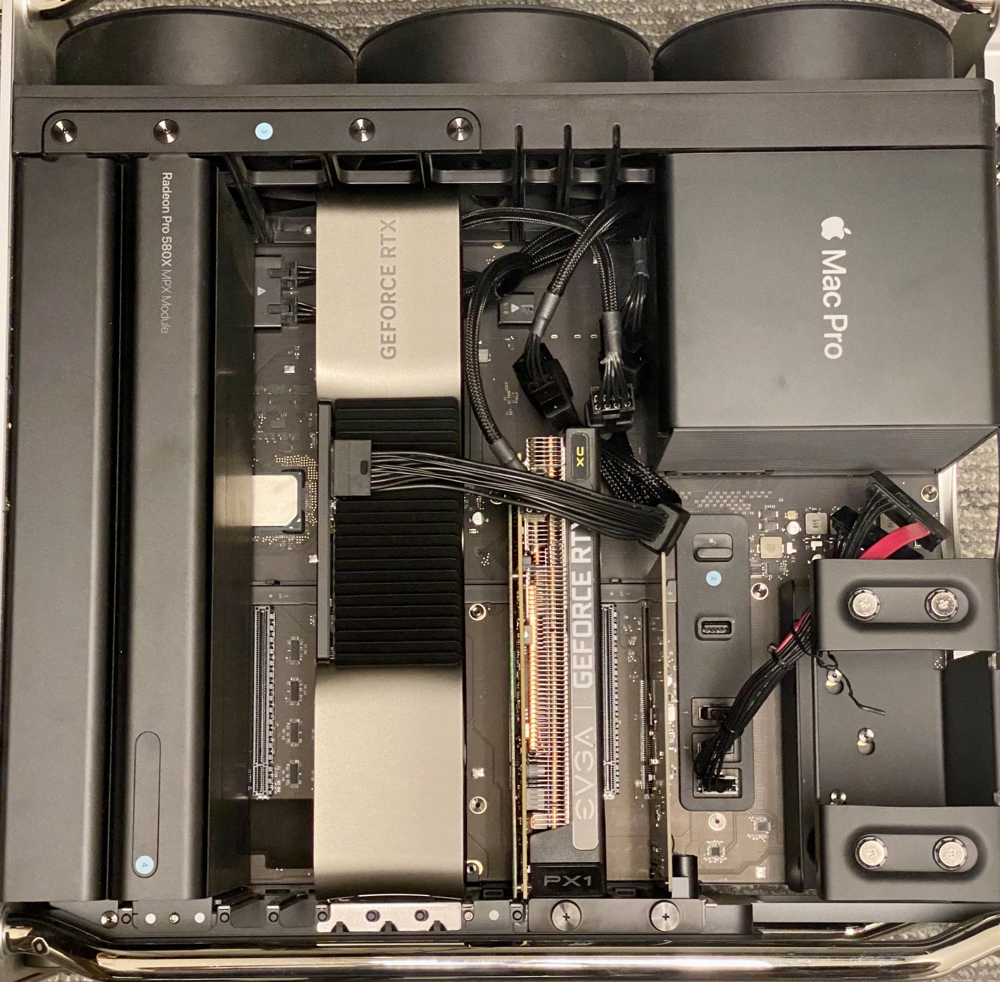

I finally nabbed a 4090FE and put it in my 7,1 2019 Intel Max Pro. In the picture, I have a 3 pcie power plugs going to the 4090 and one going to a 3060. I removed some pcie slot covers so the hot air from the GPU can be pushed out. Works quite well in windows (obviously). I haven’t gone back to MacOS yet though. For that I usually just use my laptop.

I finally nabbed a 4090FE and put it in my 7,1 2019 Intel Max Pro. In the picture, I have a 3 pcie power plugs going to the 4090 and one going to a 3060. I removed some pcie slot covers so the hot air from the GPU can be pushed out. Works quite well in windows (obviously). I haven’t gone back to MacOS yet though. For that I usually just use my laptop. View attachment 2244105View attachment 2244104
I have both 3090FE and 4090FE and I'm glad I changed it to 4090FE because it now fits perfectly without needing to push my Mac Pro fans out a bit, as 3090FE was a bit longer than the allowed length on Mac Pro inside.

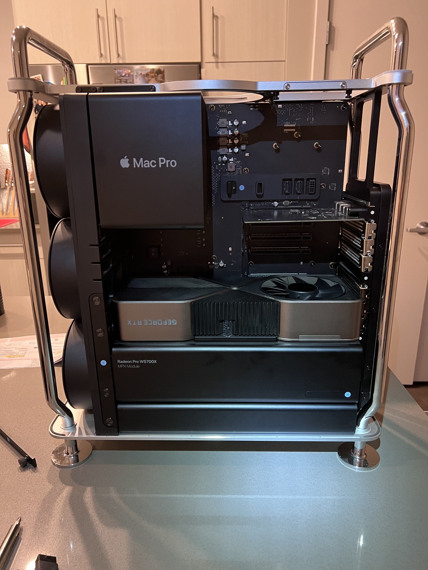

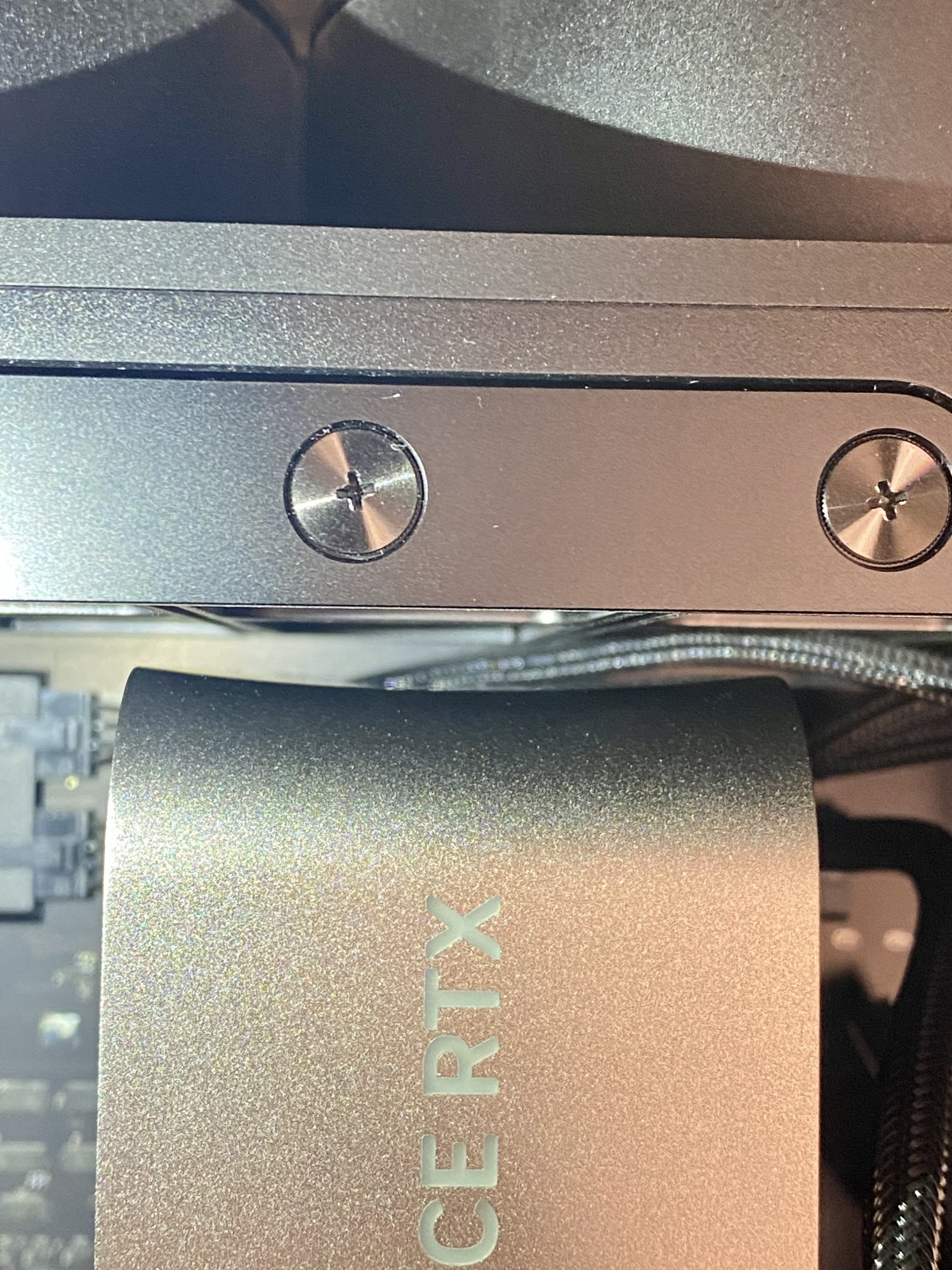

Just chiming in here -
Am still waiting on a few things to finish the build, but I am able to physically get a 3090 into my 2019 MP. It is tight, and you must flex the fan grill a bit...but it does fit in, and you can very easily put both the front and rear PCI slot covers back on, the rear one especially shouldn't be an issue since the card bracket should lock into the slot. The front cover wasn't an issue, I suppose if the grill was flexed *a lot* it could have been, but it's really only being pushed on just a little bit. Waiting on the Belkin cables (which are strangely hard to get a hold of now) and still trying to figure out what I'm going to run as a startup disk for Ubuntu. But, at least physically, everything fits.
