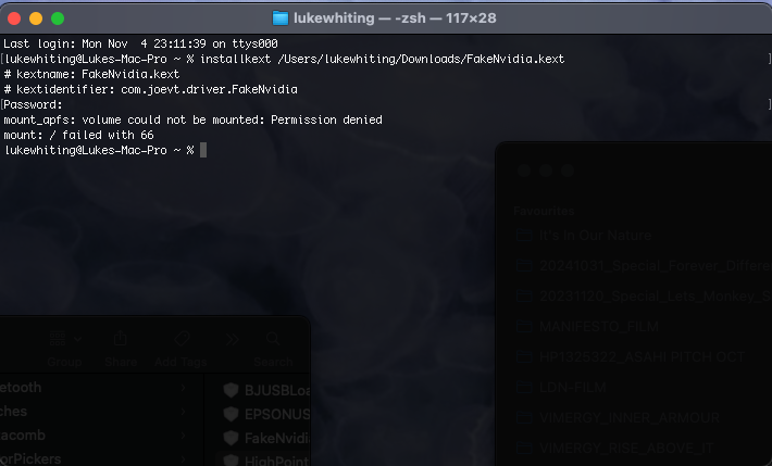

@LEOMODE or anybody really that has a clue of what they're doing, I'm getting this error when trying to install fakenvidia.kext with your script in terminal on Sequoia:
mount_apfs: volume could not be mounted: Permission denied
mount: / failed with 66
I've disabled SIP in recovery
Any ideas or help would be much appreciated!

Which installkext are you using?
The latest is at https://gist.github.com/joevt/a4ef4cd2e1485d0dd595893007bdfd6a
The default install location should be /Library/Extensions instead of /System/Library/Extensions

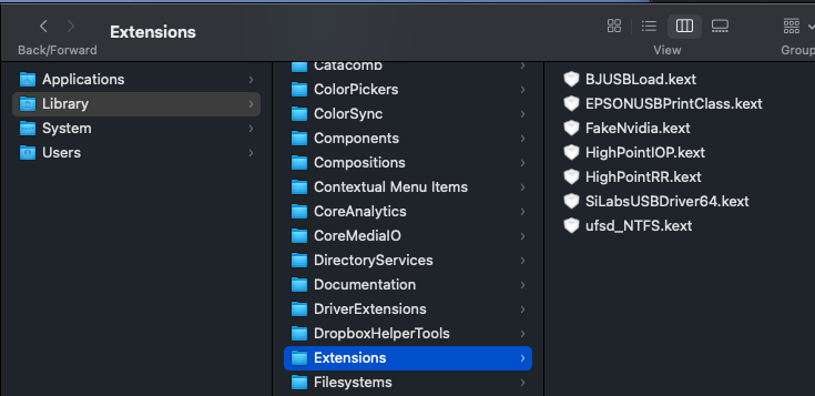

I'm no longer getting that error messgae using the latest installkext you linked above and the fakenvidia.kext is installed to the /Library/Extensions folder but after a restart and I try the sleep function my displays go black for a second but the fans and drives don't turn off and then display is back on again after a couple of seconds? I've also added the correct PCI device number for my 4090 into my Info.plist and shared here for ref. Thanks again for your help!

Did you make the change to the Info.plist before installing the kext?
I don't have any RTX GPUs so I don't know what the correct behaviour looks like.
Yes, I made the change to the info.plist before installing the kext. Not sure what else I can do really at this stage…

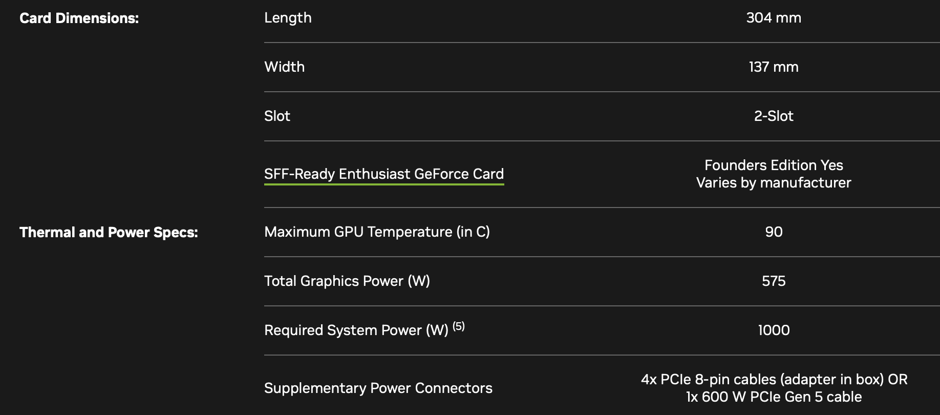

The RTX 5090 will just about fit, The RTX 5090 Founders Edition is 304mm x 40mm
But it will need 4 8-pin power cables.
RTX 5080 needs 3 8-pin, and RTX 5070 TI and RTX 5070 needs 2 8-pin cables

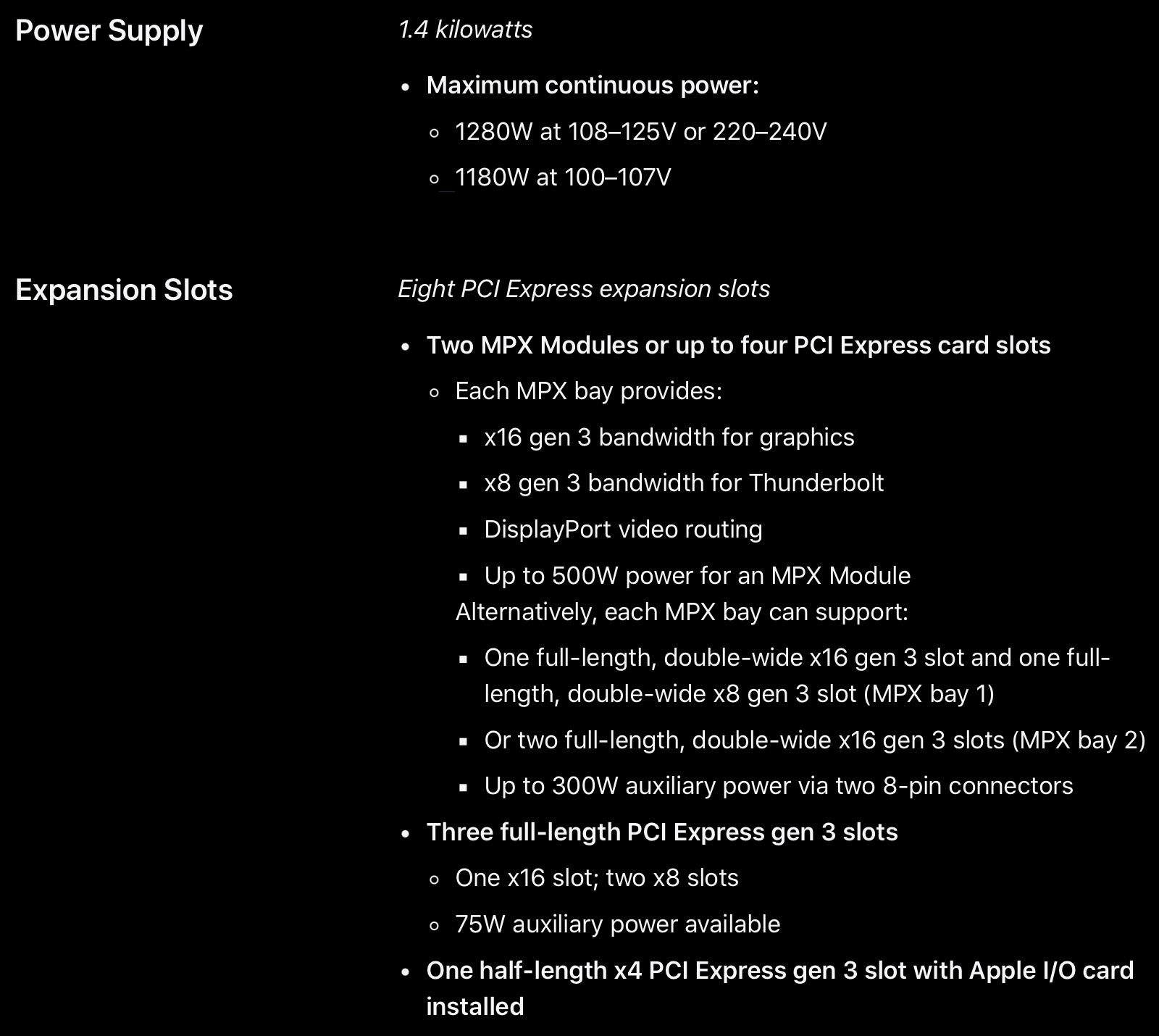

The Mac Pro 2019 does have four 8-pin connectors. Each one is supposed to support 150W.
https://www.apple.com/by/mac-pro/pdf/Mac_Pro_White_Paper_Aug_2021.pdf

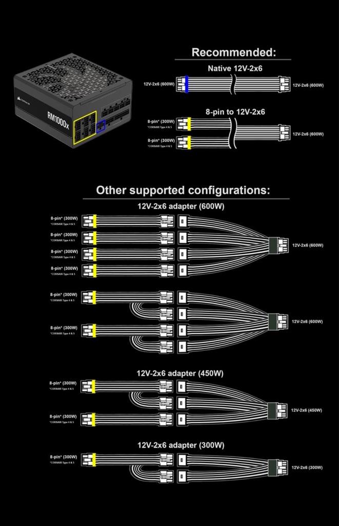

I suppose you would use the Belkin AUX Power Cable Kit with a four 8-pin to 12-pin adapter.
https://www.corsair.com/ca/en/explo...ter-from-my-rtx-gpu-or-the-cable-from-my-psu/
Unless someone makes a four 8-pin to 12-pin cable specifically for the Mac Pro 2019?
Will the 5090 come with a four 8-pin to 12-pin adapter? I think the 4090 did.

Does the Founders Edition version fit OK? Can the required 575W power be delivered OK via the 4 auxiliary power connectors (150W each) on the Mac Pro logic board?

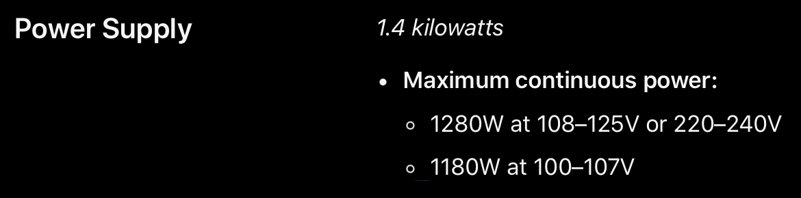

I could be mistaken. Just had a look at the details on Apple's tech specs.
Up to 300W auxiliary power via two 8-pin connectors.
The RTX 4090 needs 450W, and that works according to users here on this forum
