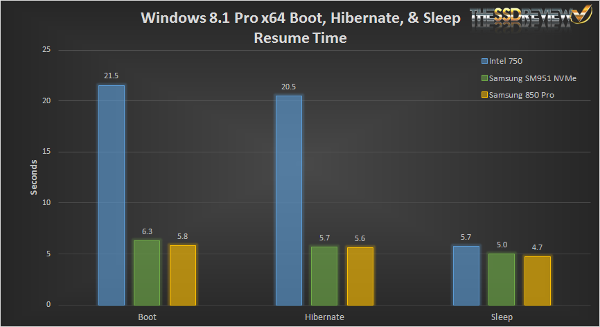

Still, such a waste of time and excitement. From SSDReview:
'Now, let’s be real here, while it is great to see such high performance due to NVMe, consumers will never reach such high queue depths and utilize such high IOPS.'
And if you are expecting some kind of faster boot times...a standard SATA3 drive is still your best bang for buck in terms of real world performance and price. Anything above that just looks good in synthetic benchmarks or when people try to impress each other on a forum with how much money they spent. Here's a dose of reality...
