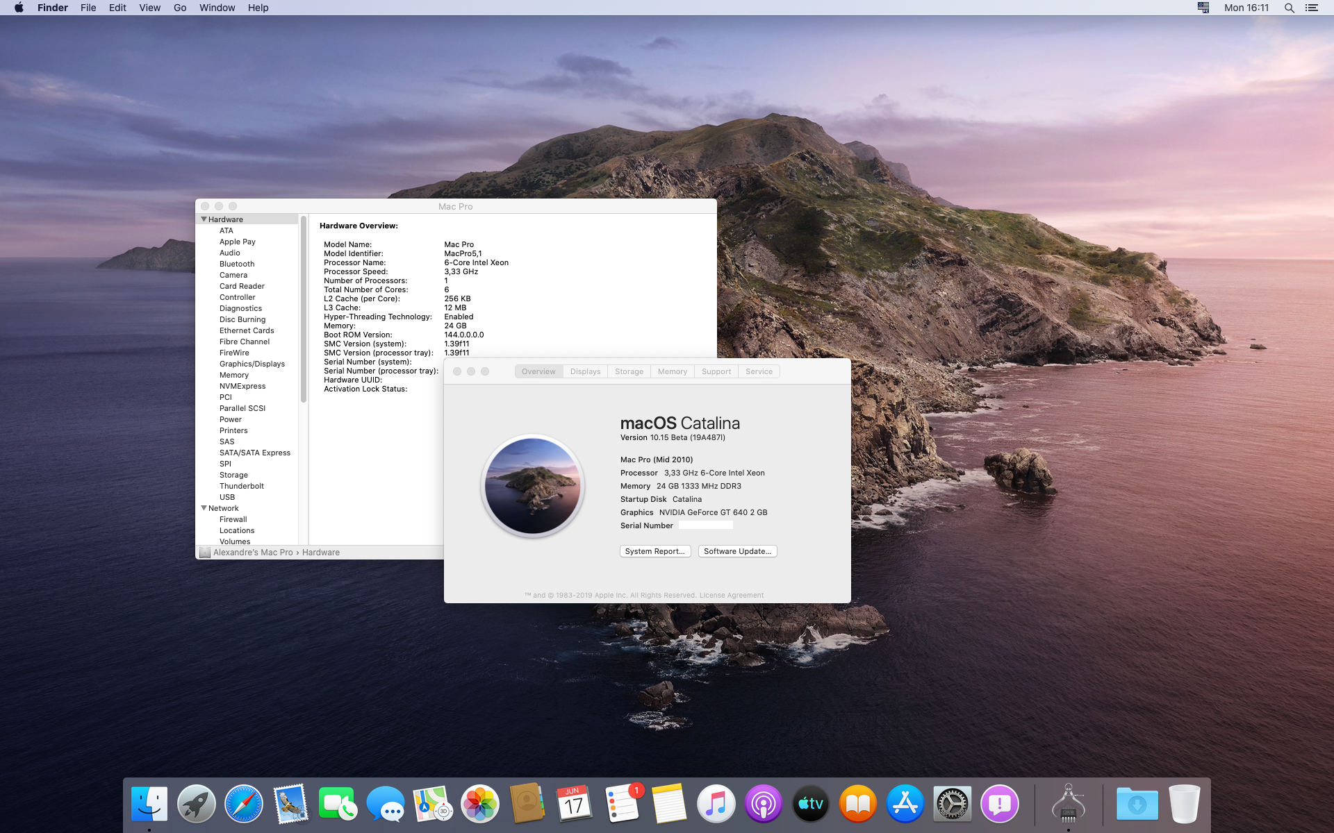

10.15 DP2 still works with a MP5,1, after you install it with VMware Fusion 11.1 to a rawDisk:

If installed by using the fusion method, will it update normally or is a “from scratch” method needed?
Updates have the same Distribution file as full installs, so, the answer is no.
Said that, in the future you can use VMware Fusion to bootstrap the update or you can use a patch from @Czo that emulates VMM and makes the Distribution file to think you are running from a VM.
Btw, DP2 is a full release. Not a differential one. Software Update downloads the full 6,5GB even on a supported Mac.

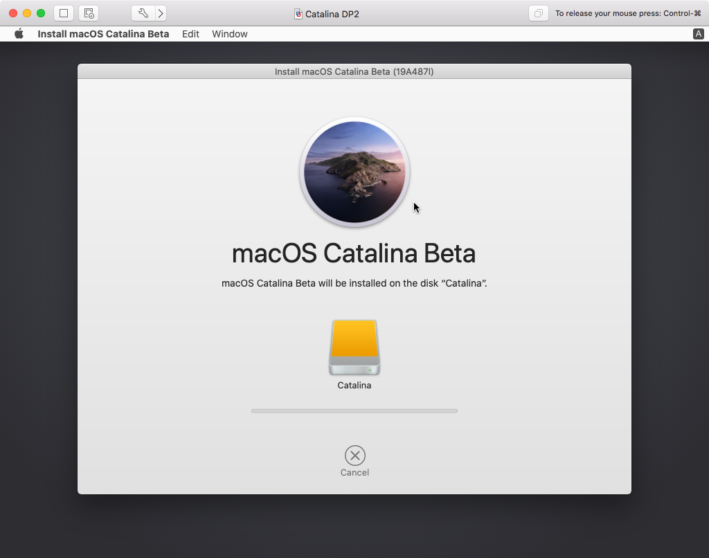

Catalina DP2 changes in the install process made it a little more complex to install, whatever way you are using to install it.
With VMware Fusion it's the same install process as DP1, but it's a lot more temperamental. With DP1 you can almost automatise installs, but with DP2 sometimes the VM tries to boot the wrong disk or won't find any disks since macOS sometimes just kidnap the disk.
Perhaps DP3 will be more stable and easier to install.

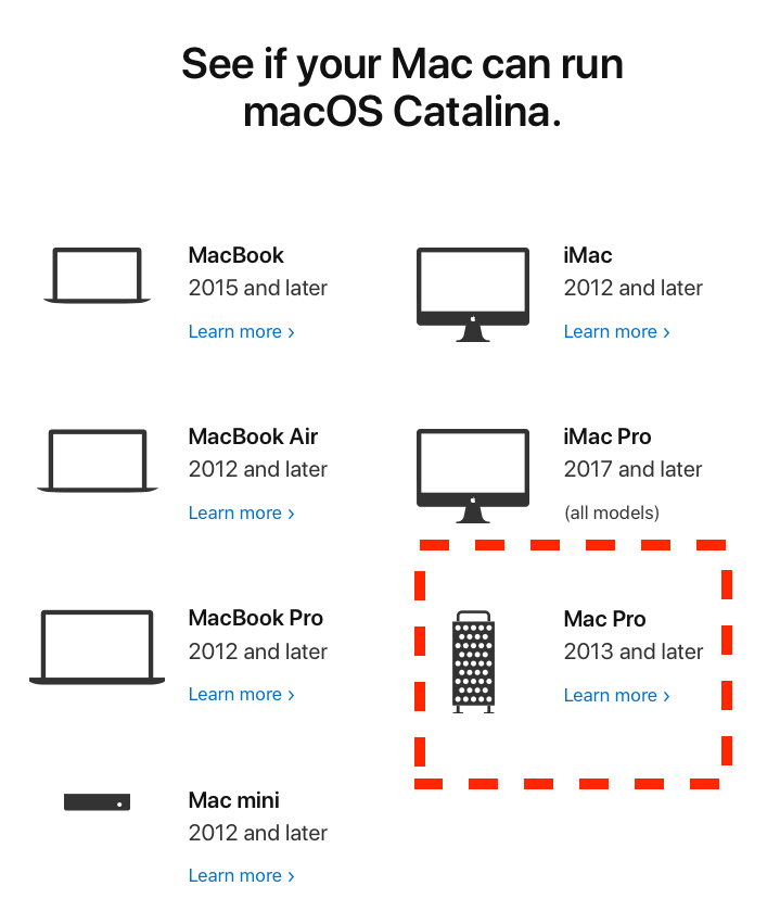

Sorry for giving you the bad news but if Apple intended to support MP5,1 with Catalina later down the road, why they removed kexts necessary for it? Why they are blocking it everywhere. And most important, why this?
Reactions: bsbeamer
cMP 4.1 and 5.1 do not fall in that category. The 5.1 was INTRODUCED in 2010
Sadly, you are indeed correct. Apple is being very precise with the wording, and this precision writing causes trouble for readers who aren’t precise.
I have a Mid-2012 MP51, assembled and sold brand new to me in 2013. However the model was introduced in 2010 so it is excluded from Catalina. It sucks, but that’s the situation.

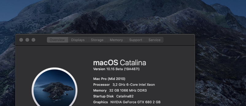

10.15.0b2 is running great on my cMP 4,1->5,1 after copying (dd) a disk from external to internal NVMe from a supported Mac Mini.
With this argument for booting, right?:
Code:
sudo nvram boot-args="-no_compat_check"
Reactions: eksu
