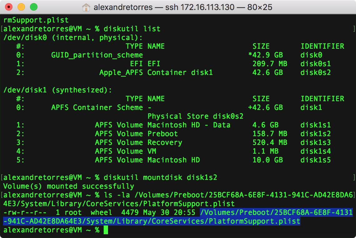

If you used a supported Mac to install and used -no_compat_check to bypass the distribution file, you can't clear the NVRAM. To overcome that, just add Mac-F221BEC8 to SupportedBoardIds and add MacPro5,1 to SupportedModelProperties.
You have to do it in two places:
First one, from the /System/Library/CoreServices/PlatformSupport.plist
Code:
The second one, from the same file in the Preboot volume. You have to mount the Preboot volume first, than go to
Code:
/Volume/Preboot/xxxx-xxxxx-xxxx-xxxx/System/Library/CoreServices/PlatformSupport.plist
Example:
SupportedBoardIds for MP5,1 is:
Code:
<string>Mac-F221BEC8</string>
SupportedModelProperties for MP5,1 is:
Code:
<string>MacPro5,1</string>
How do you edit PlatformSupport.plist on the Preboot volume? I just get "No such file or directory"
Thanks
How do you edit PlatformSupport.plist on the Preboot volume, I just get "No such file or directory"
Thanks
Ok, so I’m new here. Not trynna cause issues, does that mean that I need to boot this file into Linux and alter the files? Or can I do that through the recover terminal? Thanks in advance
Thanks
Just use the -no_compat_check. If you edit PlatformSupport.plist, you will have to do it again every new DP.

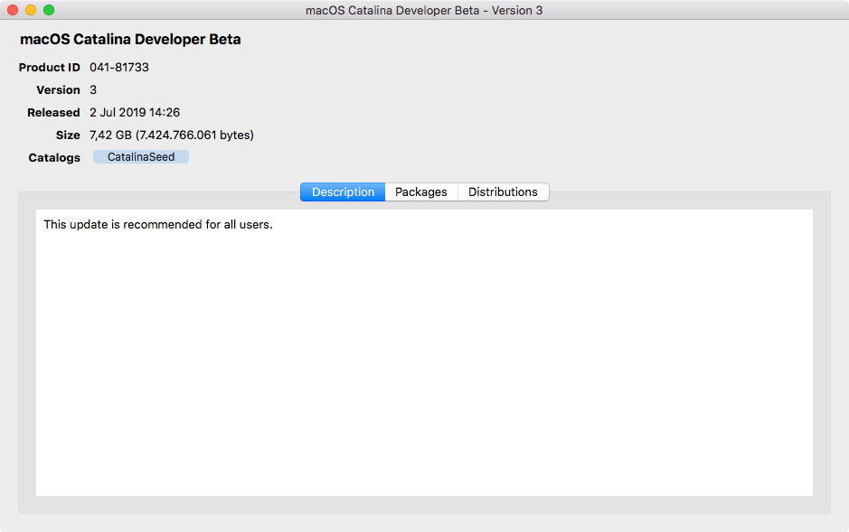

Apple released Catalina DP3, build 19A501i:

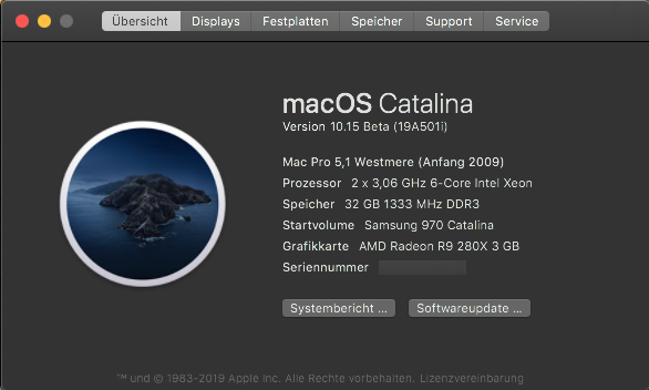

Still blocks MP5,1, hope never ends :p

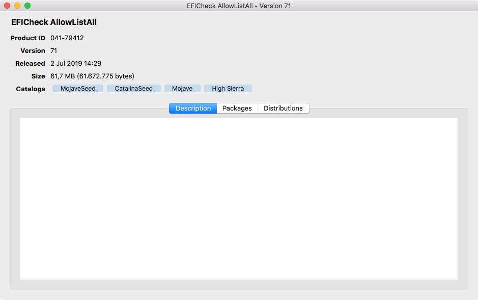

[doublepost=1562092550][/doublepost]Seems Apple is releasing new firmwares for Catalina supported Macs, EFICheck AllowListAll was updated too.

[doublepost=1562092639][/doublepost]DP3 is a full install only and it's 7,42GB download.

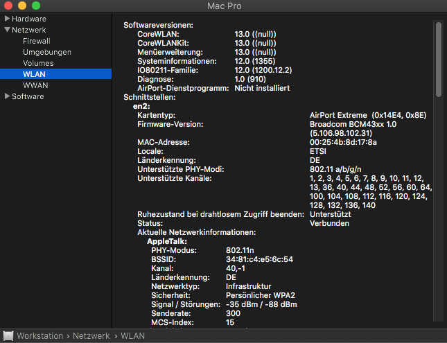

Ta-daah – WiFi is back in 19A501i with the 1.0b6 patcher post install
obviously the Mojave AirPortBrcm4331.kext is included in b6. Nice!

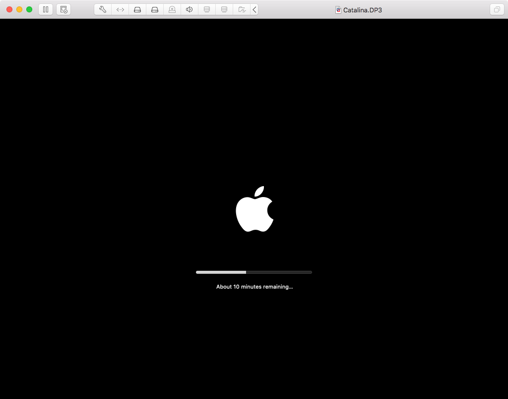

Is there a way to download the "delta" version of DP3 to install on top of a DP2 Fusion virtual machine? Oddly enough Software Update doesn't seem aware of the update at all.
Software update only works with supported Macs and don't work with Fusion at the present release, 11.1.
DP2 and DP3 are full installs, there are no deltas.
