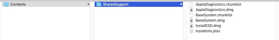

OK, so I ran version 1.0.4 of dosdude's patcher, downloaded 15.0.21 and it went through all the hoops and told me I had a successfully produced Catalina installer, on my USB stick. However what I had was not bootable, but a single folder called Contents per the attached jpg. So now I am totally confused as using The pAtcher version 1.0.2 and 15.0.18 it all worked like a charm...
What could I be doing wrong?
Try it again maybe? And try a different USB stick. Not all are bootable on the cMP.
Did you actually try booting from it? Most probably there is hidden content. Also, make sure the USB is GPT formatted.
Yes I tried, but it didn't appear in the list of startup disks in Startup disk preferences, nor does it appear when option is held down during startup.
[doublepost=1565124211][/doublepost]OK Sorted it out, though this might be of interest to others.
I re-formatted the USB stick to HFS+ before I ran the patcher and it all worked fine. Before it was formatted to APFS.
