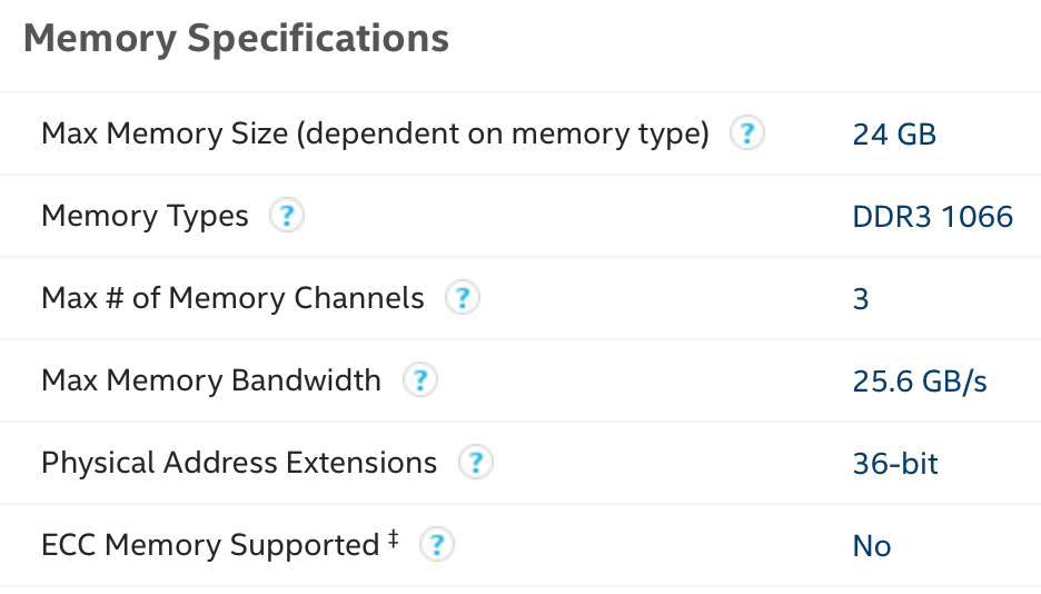

The 990x runs ram happily at 1333. ECC ram also works, just without ecc.
I checked ARK to answer that question since I don't have any 1366 i7, Intel says 1066MHz only for i7-990x:

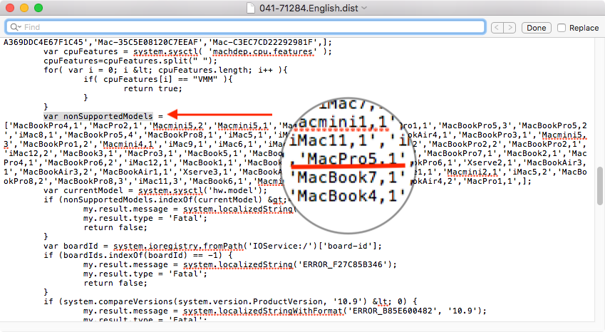

I've been thinking about making a script to remove MacPro5,1 from OSInstall.mpkg/Distribution and add the boardID of MP5,1 since it's just that what are needed, for a MP5,1 that has a METAL supported GPU, to run Catalina.
The future Mojave Catalina Patcher is overly complex with all patches needed for the other unsupported Macs to work, it will take some weeks to work anyway, while MP5,1 is just a distribution file that need two edits. Any thoughts?
The future Mojave Patcher is overly complex with all patches needed for the other unsupported Macs to work, it will take some weeks to work anyway, while MP5,1 is just a distribution file that need two edits. Any thoughts?
As long as there aren't any other restrictions I think it would be OK. We probably need to compare the performance of Catalina vs Mojave on cMP before we jump ships.
It would be great if you create the script, I have a spare 5,1 that I could install right away and help as much as I can. I've ran 3,1s with dosdude patches for a few years...
Thanks!
It's a little more complicated than what I thought initially, seems the installer does another checks (related to METAL?). If you are installing from scratch manually, just OSInstall.mpkg/Distribution is needed to patch.
You mean, the script wouldn't work using the installer while running MacOS but it would with the USB install method? I do have Nvidia GPU with Mac ROM for boot screen.
tsialex
Contributor
Jun 13, 2016
13,455
13,602
Installing from scratch is not what you are thinking, it's manually unpacking and putting everything on the correct place - it's not for most people.
BTW, I started to evaluate the feasibility of doing this today and I don't yet have the full picture of what the Installer checks.
For now, use a supported Mac using what is described on the first post.

<snip>
Code:
sudo nvram boot-args="-no_compat_check"
<snip>
Note:
Before anyone asks again, Catalina is not supported (actively blocked) on a MP5,1:
Thanks for the -no_compat_check hint!
Just for fun I tried the install from OSInstall.mpkg, which actually proceeded without errors.
(I changed the Distribution file and repackaged it)
I booted on a 5.1 flashed 4.1 with Mojave, and installed it on to another empty hard drive I had.
Problem though is, I obviously don't understand the installation procedure (especially post install) not enough.
I rebooted, and the "new" Catalina disk then gives error messages on not being able to mount some stuff, and then eventually shuts down.
When booting up in verbose mode, (lots of garbage)
It can mount the drive, but then fails to mount the "vm" /private/var/vm
I then see a "Darwin Bootstrapper Version 7.0.0..." doing its magic.
It eventually claims the disk is clean, and APFS is fine, but then fails with not being able to mount something, and shuts down.
Anyways, it might be related to be installing from the OSInstall.mpkg, and not relevant. But I found it interesting that I got over the compatibility check with the installer ...

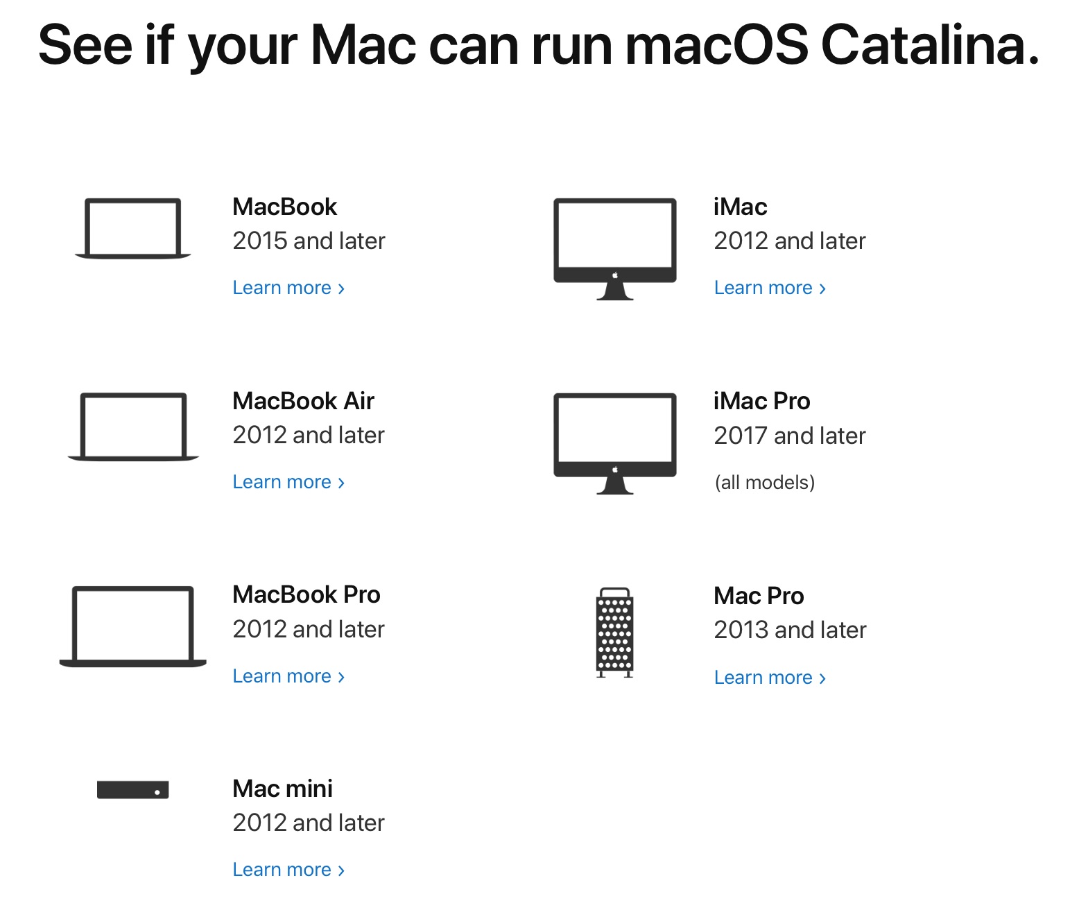

@tsialex do you think this is a definitive « we will not support mp5.1 anytime anymore » or could they just prevent installation because they feel the beta is not ready enough for those, but could still turn the switch « on » latter on?
crystalidea
macrumors regular
Apr 3, 2014
188
50
Belgium
cMP is officially unsupported and never will be. Nobody knows if they will disable current workaround, I personally think they will turn the switch off and MacPro5,1 will be finally retired, but let's see
[doublepost=1559744261][/doublepost]https://en.wikipedia.org/wiki/MacOS_Catalina#System_requirements
bookemdano
macrumors 68000
Jul 29, 2011
1,514
846
Zero chance. They have clearly outlined the models that will be supported on their Catalina page
