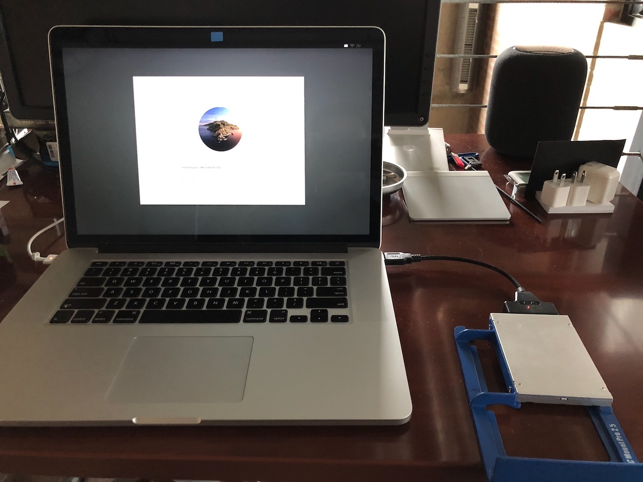

Do I understand you right (regarding the update): You take out the MacPRo 5,1 system SSD (where Catalina runs), connect it externally to the MBP and boot the MBP with it. Then you make the update via the MBP, shut it down, reinstall the SSD to the MacPro and boot the MacPro from the SSD?
That's the plan... I installed 10.15.1, so have not had an update yet. When 10.15.2 comes out, I'll try it and post update here...
Next time just boot the MP in Target mode and boot the MB from there.Happy to report that it worked exactly as I'd hoped...
- removed the drive from the mp5,1 and connected to mbp with a SATA-USB cable
- booted mbp using option key
- update to 10.15.2 using system update
- shutdown mbp
- moved the drive back to the mp5,1
- booted and all up and running on 10.15.2

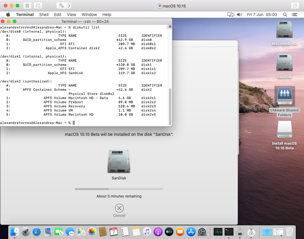

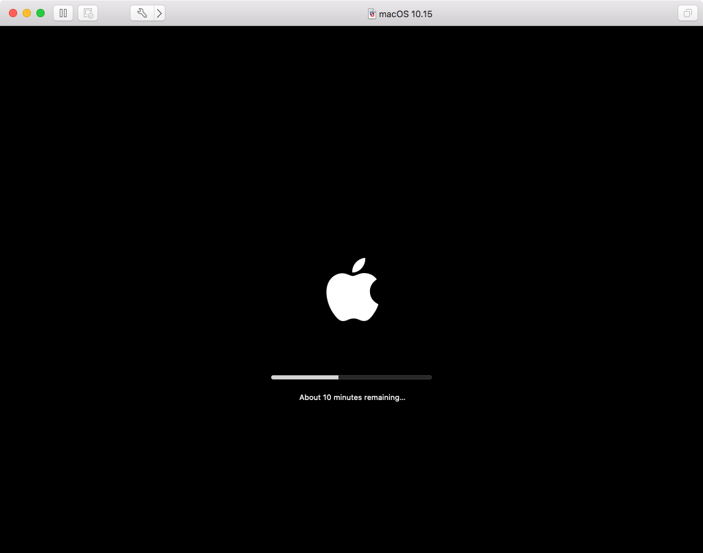

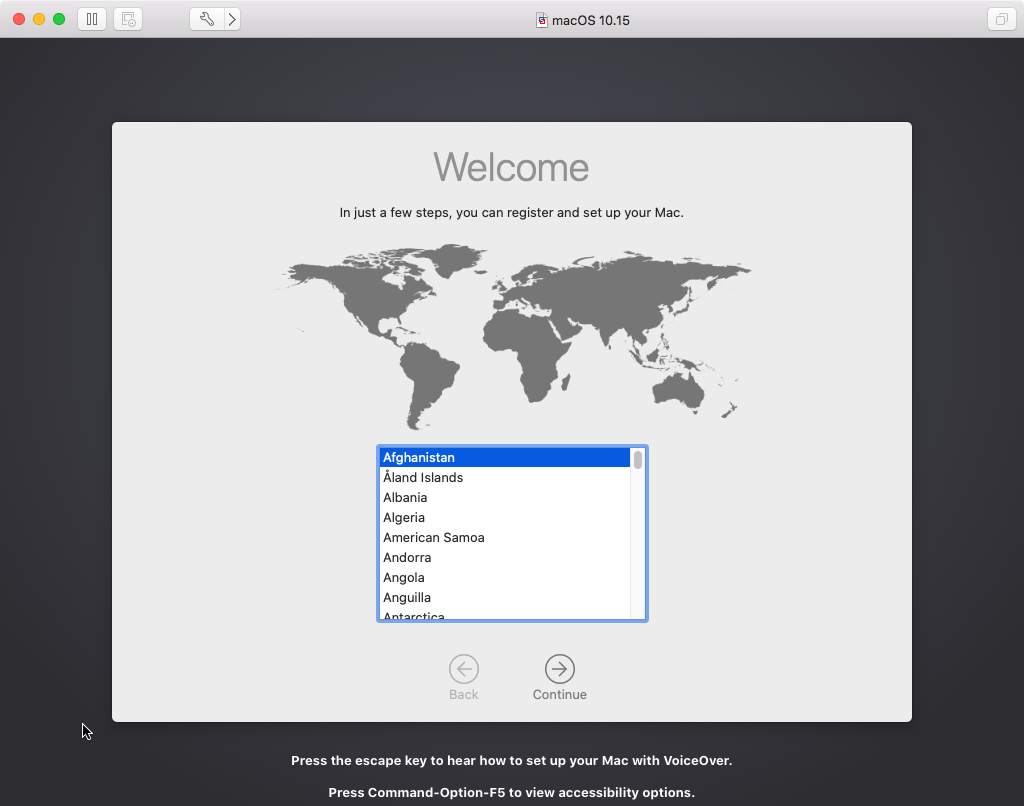

Installing Catalina from a VMWare Fusion 11.1 Catalina VM to a real disk attached to the VM (using vmware-rawdiskCreator to create/attach the disk):
Works beautifully and people that don't have a supported Mac to install Catalina have a way to install it to a MP5,1 without the need to do it by hand.
It's a lot more practical and faster than installing it using an USB adaptor + a supported Mac.
As explained on the first post, you just need to add -no_compat_check to the boot-args to boot your MP5,1 from the Catalina disk installed by the Catalina VM.

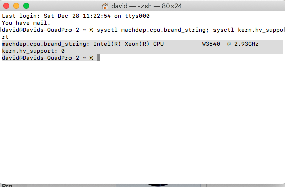

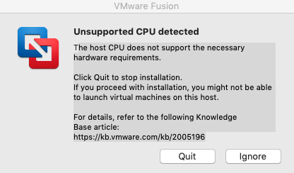

I acquired VM Fusion Pro 11.5 and tried to install it on my cMP4.1 ->5.1 to find it will not run with my W3540 CPU. It prevents it from running. It gives me an error on install
In one of your early posts of this feed you say you too have a cMP4.1 ->5.1. How did you get to use VM Fusion 11.1 to do this?

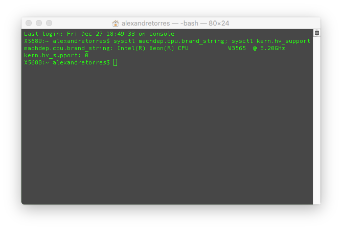

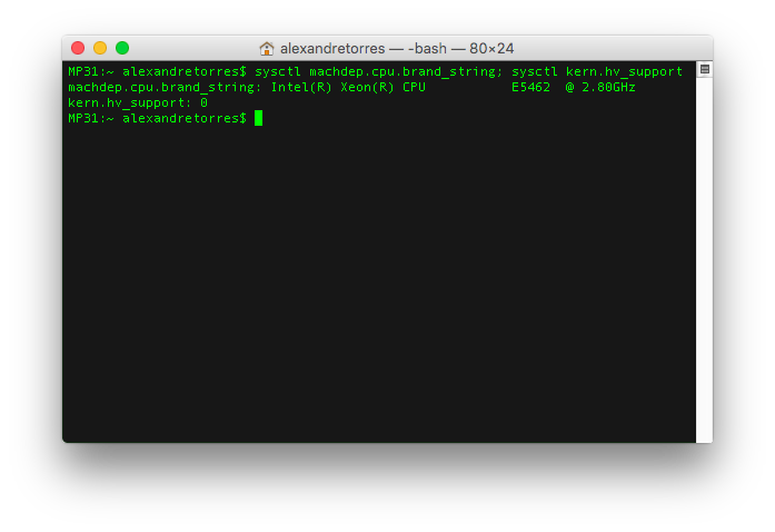

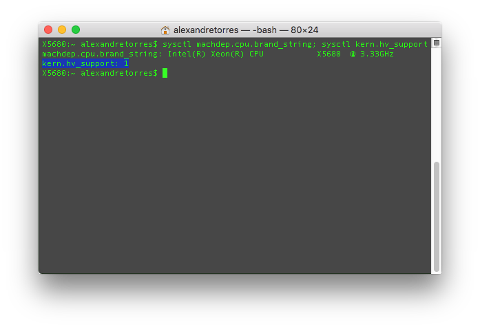

sysctl machdep.cpu.brand_string; sysctl kern.hv_support
	That was very useful - wish I'd known about it prior to starting down this road with = VMWare Fusion and Catalina VM attached to a real disk...Since most people don't know how to check if your current CPU supports Apple Hypervisor, this is how to check if your current CPU supports it and can run VMware Fusion 11.5, Docker, Anka and more importantly, spoof the VMM flag with OpenCore for having native Catalina installs and software updates.
Open Terminal:
Code:sysctl machdep.cpu.brand_string; sysctl kern.hv_support
Apple Hypervisor supported the answer will be kern.hv_support: 1, it's a mid-2010 Mac Pro upgraded to X5680:
This is the same mid-2010 Mac Pro but back with the original W3565 Xeon Nehalem installed. Apple Hypervisor unsupported, kern.hv_support: 0,
This is a early-2008 Mac Pro, Apple Hypervisor unsupported, kern.hv_support: 0:
Since you have a W3540, you have a single CPU tray MP4,1>5,1. Only dual CPU trays for 2009 Mac Pros use de-lided Xeons.That was very useful - wish I'd known about it prior to starting down this road with = VMWare Fusion and Catalina VM attached to a real disk...
My output for my cMP 4,1-> cMP 5,1 was:
but following your advice my replacement processor (X5677) is on it's way and should arrive between Jan 6 and 13. Plenty of time to get hardware for de-lidding and hex wrench long enough to reach the 3mm screws.
