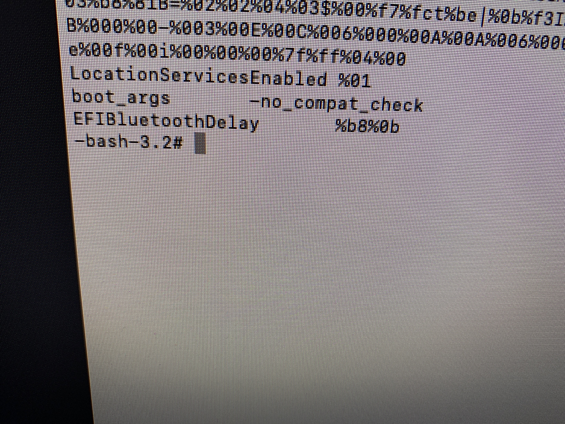

Not sure if this is the right thread, but I was trying to install Catalina on my macpro5,1(updated 4,1) using the "install on a supported mac first" method, and I got the prohibitory mark when trying to boot.
Here's the story: I downloaded a full copy from the developer SUCatalog using the installinstallmacos.py script, and installed on an SSD, attached to my iMac14,2. The update went well but, but,weirdly, I found out that my mac was enrolled to receive developer updates although I am not enrolled to the developer program.
I then moved the SSD to my macpro and the mac refused to boot: I was getting the prohibitory mark after selecting it. I had to install back the GT120 to find this out, as with my MSI Radeon Vega56 I couldn't see anything, of course.
As a side note: I decided to try to update the OS on the SSD, since the iMac was suggesting to update to 10.15.3 Beta2; update completed and now bootrom on the iMac is 141.0.0.0, and there is also a new default font.
Any idea of why the MacPro reports the prohibitory sign ? Is it because of this developer enrollment ?
Or maybe because a bootrom update was triggered and this was obviously not compatible with the MacPro?
Missing no-compat-check? Read the 1st post.

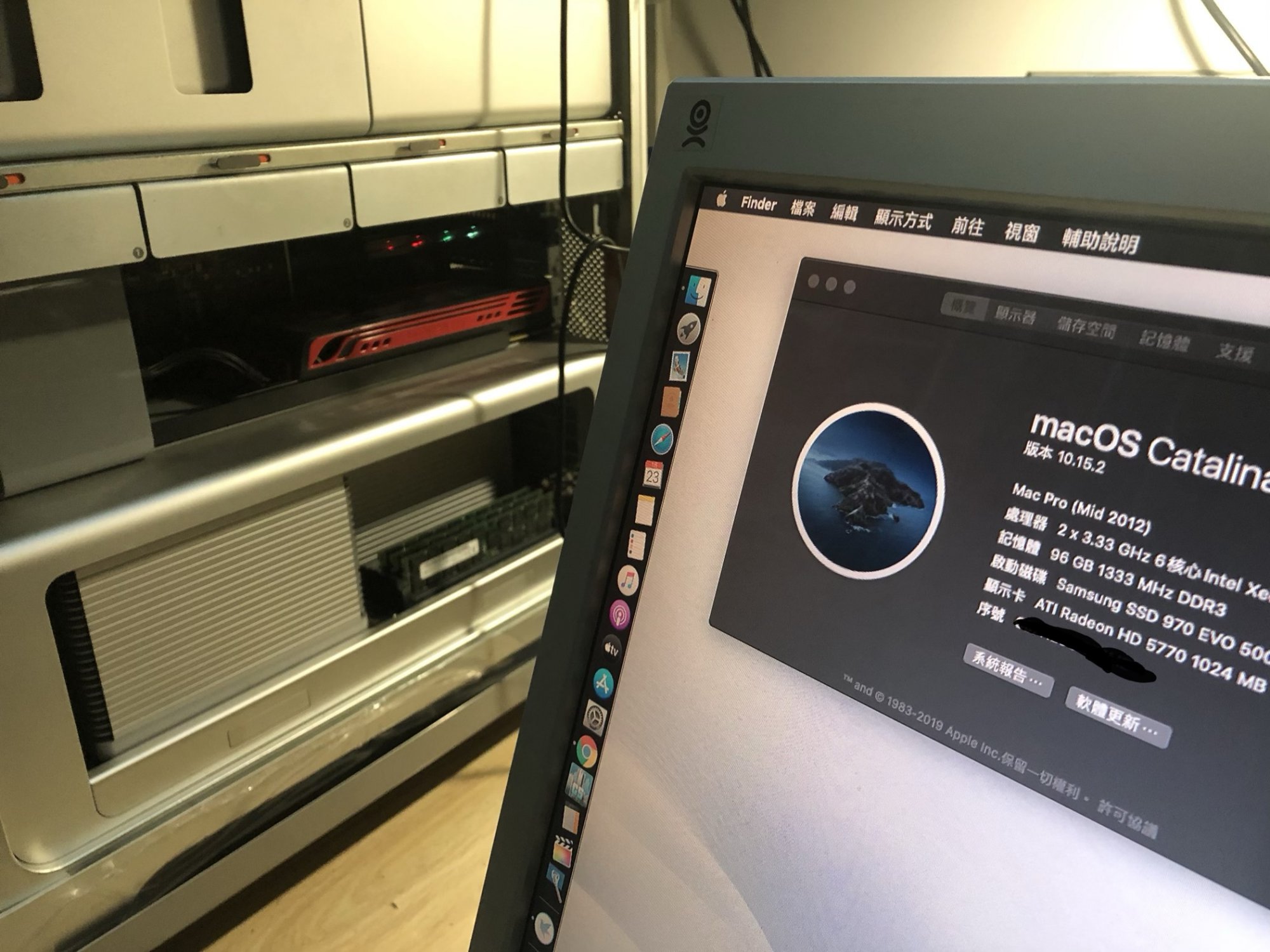

Yesterday I placed an order for a 5700 graphics card online, took out the cMP5.1 SSD, connected it to a macbook through a transfer device, and smoothly upgraded to Catalina.
I upgraded directly from High Sierra to Catalina. Today I got the 5700 graphics card, and then I was pleasantly surprised that I forgot to order the power cable of the macpro to connect to the graphics card ...
I don't seem to see the same case as me (High Sierra-> Catalina, & 5700 graphics card), I am very worried whether this will cause problems.
Wish me luck :)

Hi guys, I think I got some interesting results, and now Catalina is working happily with ATI Radeon HD 5770.

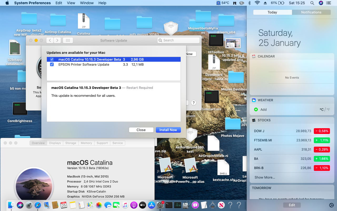

This sounds interesting for OTA update:
zemaker
macrumors 6502
Nov 25, 2011
295
188
Is this only for the patcher?
