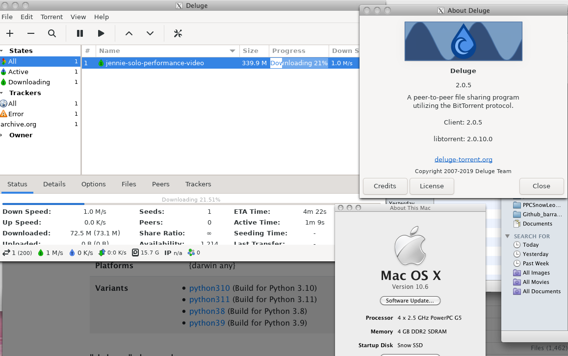

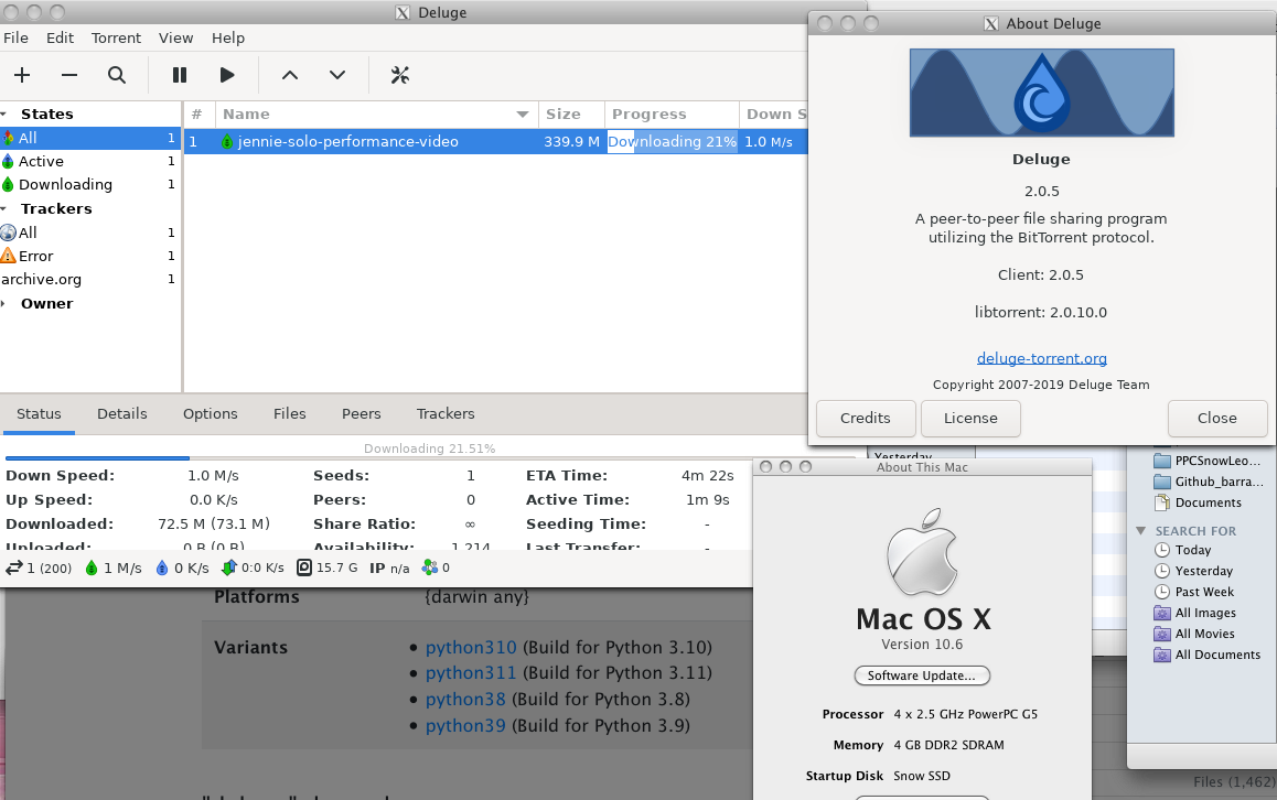

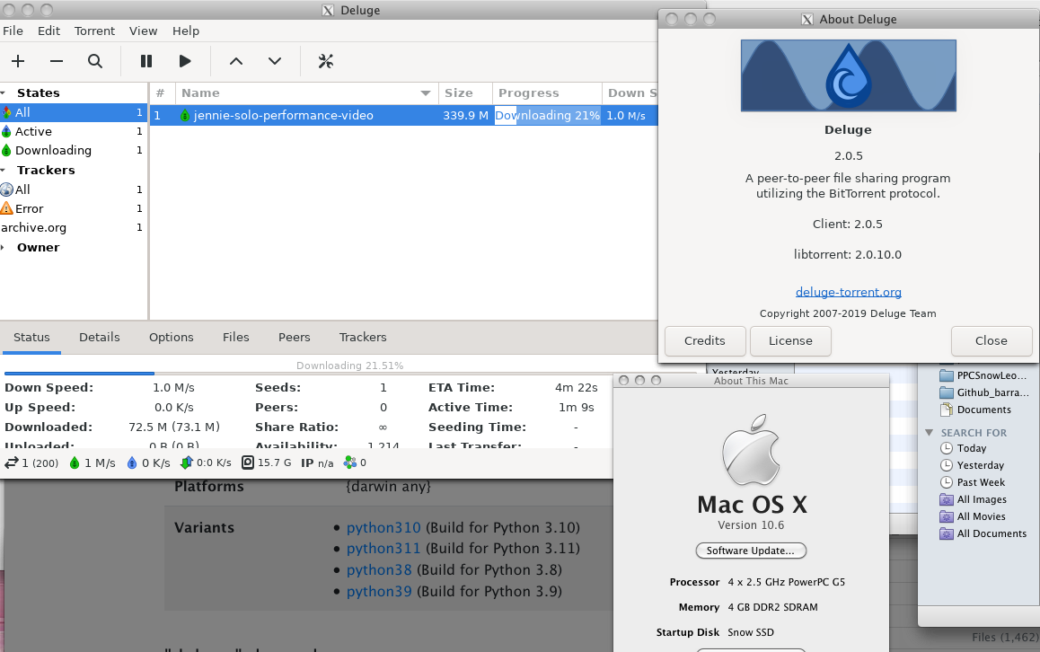

I got the latest Deluge working on PPC.
Will need a few fixups and updates in MacPorts, do not try right now, it will not work yet :)
In fact 2.1.1 works also.
These should work:

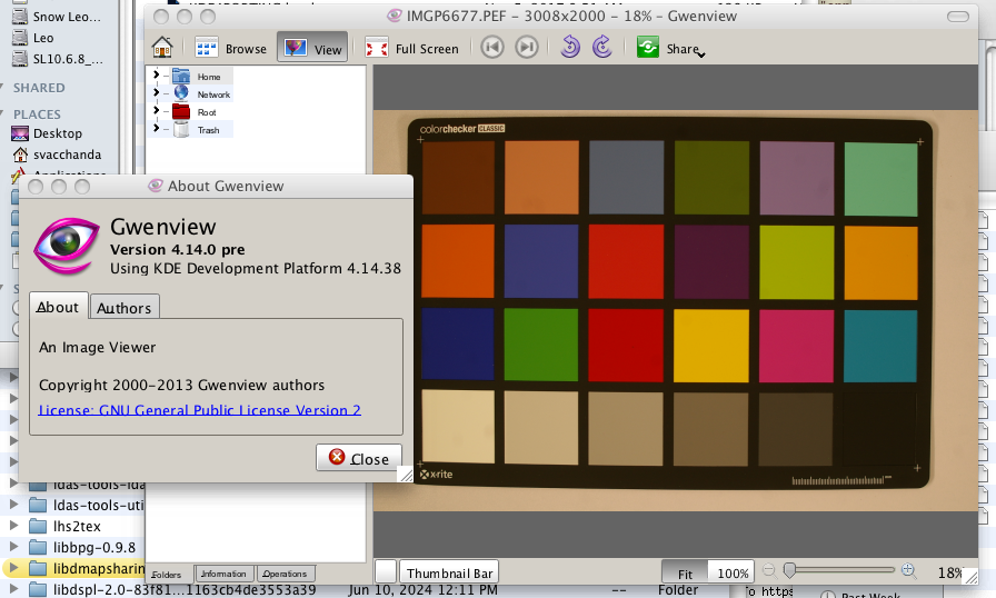

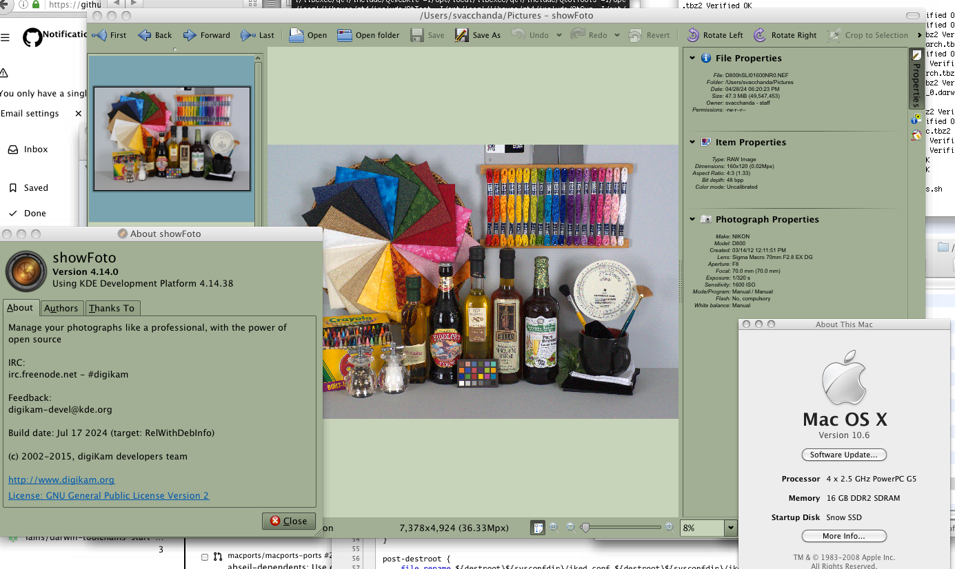

Pretty basic app from KDE4, but works. Has some simple RAW processing.
P. S. I was able to build full-blown digikam today, but the app crashes on launch, unfortunately. Maybe fixable.
By the way notice that even though Qt4-based software is not the latest, to put it mildly, in terms of GUI, it links to the current versions of libraries. So you still get modern FFMpeg, modern audio codecs and modern image processing.
