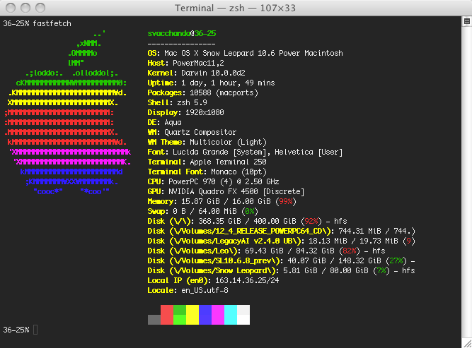

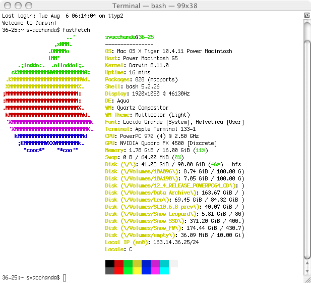

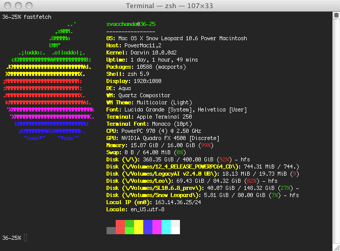

Can anyone try fastfetch on 10.5 by the way?

I get this when building on 10.5:
Code:
gcc-mp-13: error: unrecognized command-line option '-fobjc-arc'; did you mean '-fobjc-gc'?
Build log attached.
Looks like you did not run `port sync`. The current version is 2.21.0. Your log shows 2.8.6. That will not build, since fixes were merged with 2.20.0 and updated with 2.21.0.
The flag was fixed in https://github.com/fastfetch-cli/fastfetch/commit/1d95f9b22468a5b58a892f92c25c5e88965ba93c (so there is no patch for it in MacPorts, it is unneeded).
My post was simply to state that I used your Portfile for QMPlay2 as-is out of your GitHub and it worked great.
Ah, okay, thank you. I think I do not have any special fixes for QMPlay2 in MacPorts tree, so it should be identical to what MacPorts’ master has.
Wow, I had literally just posted that my tree was out of date. I need to sleep more, eh? Thank you for the gentle reply and not calling out my rookie mistake, which you were well within your rights to do.
I haven't the stomach for a full sync at the moment, mostly because I'm too lazy to do the work to remove references to older gcc make gcc13 the default again (yes, I know it's not that much work, but I'm thinking of a way to automate that process before I do it). Unless...is there a way to make sync not overwrite those .tcl files? Does that only happen during a selfupdate?
At any rate, I grabbed the Portfile from your repo and get a different set of errors aound undeclared functions. Log attached.

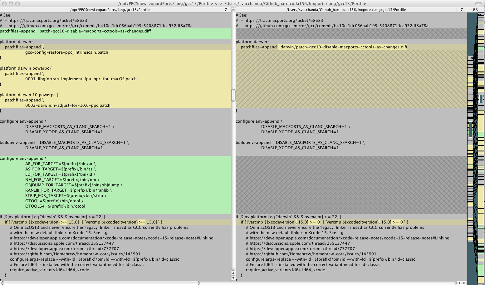

Well, you could perhaps use your git repo as an overlay for all ports and portgroups, this will ensure you portgroups and whats not gonna be used consistently.
Or you can tweak the base to fetch your own port sources and discard upstream ones. (Not recommended unless you know what you are doing.)
Or tolerate two lines of code to execute following every sync (you do not do it every hour anyway), to overwrite the portgroup and compiler settings tcl.
It is perhaps not too hard to replace two files manually in Finder too.

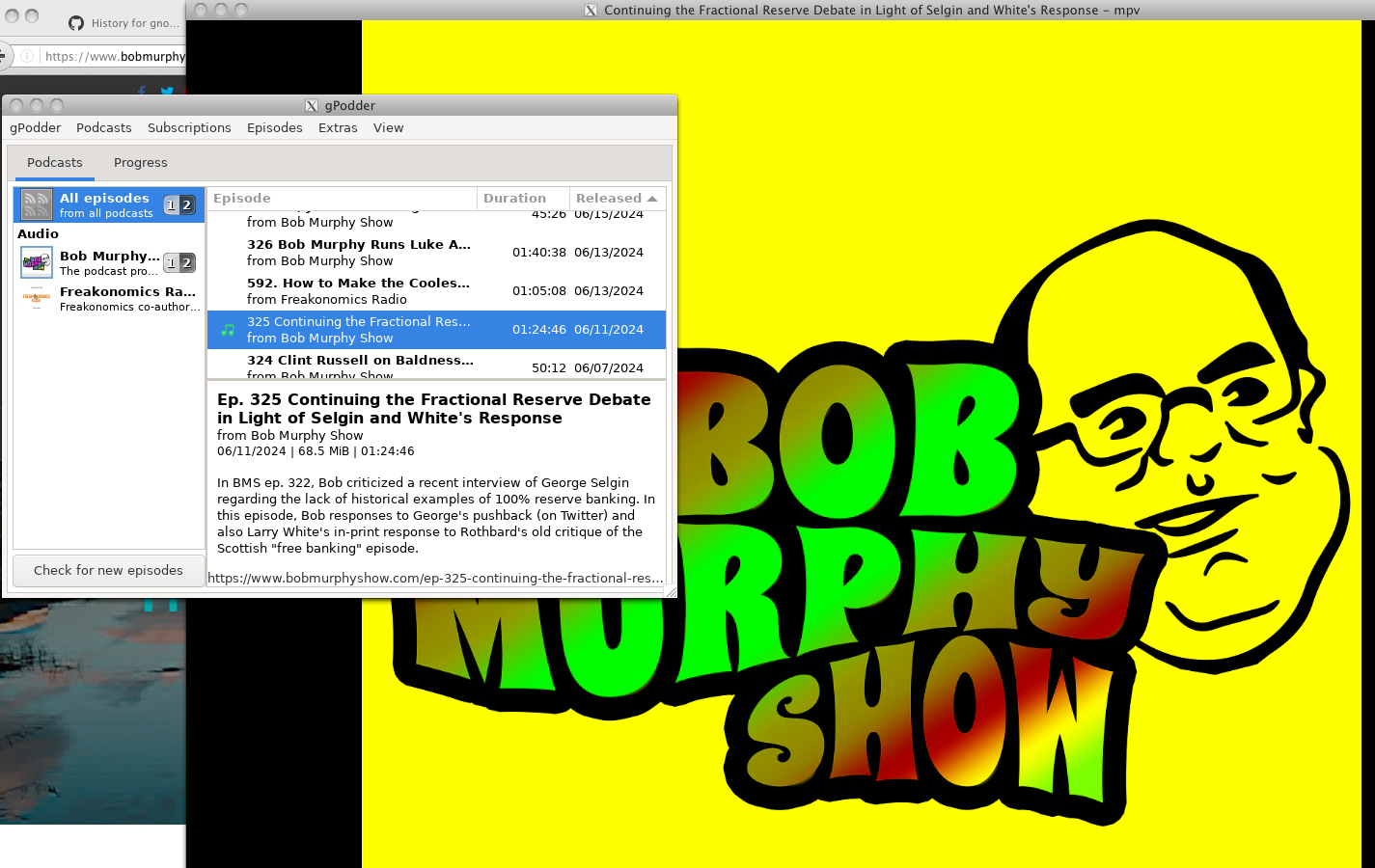

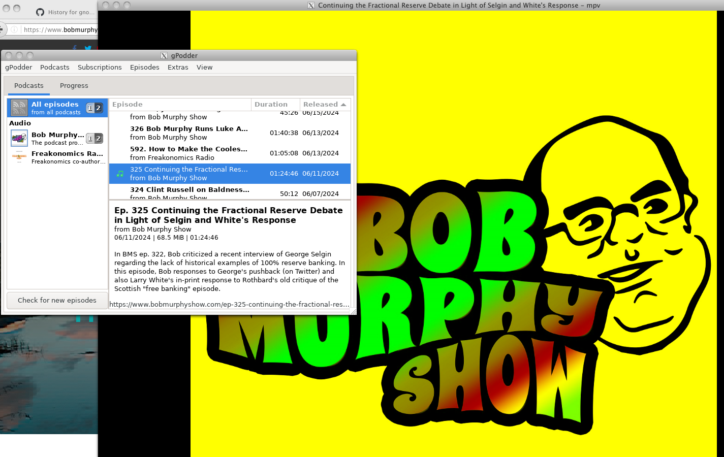

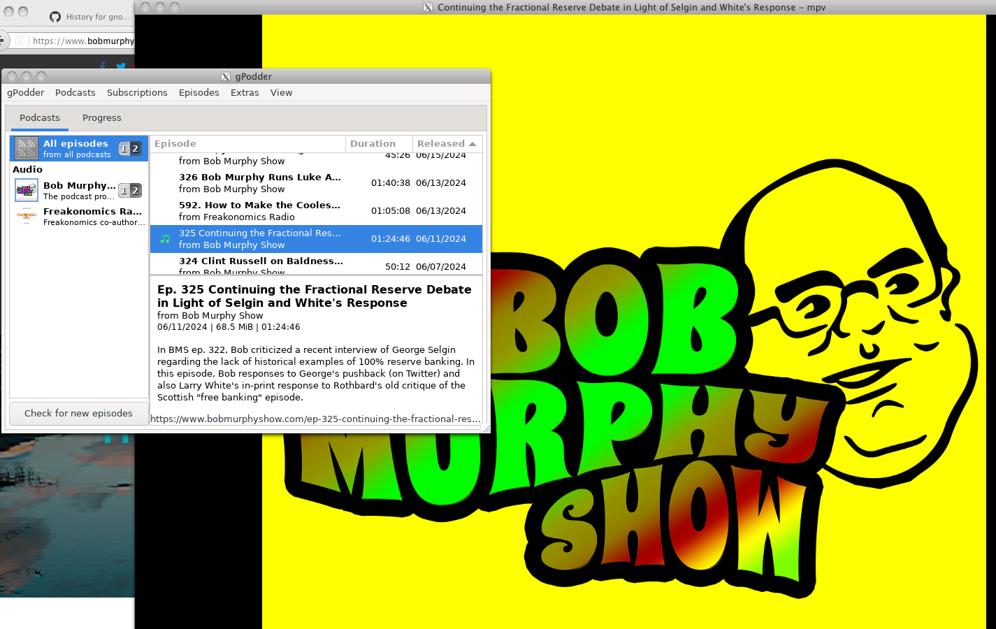

Podcasts working on PowerPC via gPodder
Seems to be a nice app! I Tried to compile it via macports on my 10.5.8 PB, it compiled without errors, an app can be found under /Applications/MacPorts but there is a sign which marks gpodder as incompatible with 10.5. if I start gpodder in a terminal, following error occurs:

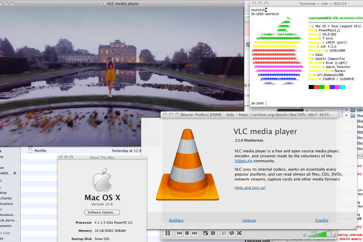

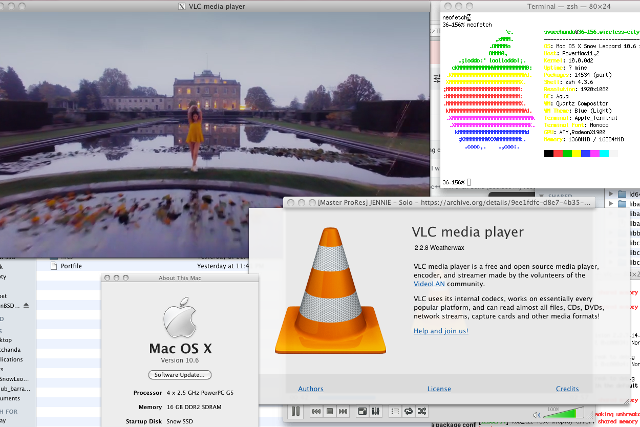

if I understand the nomenclature regarding VLC correctly there is
a) VLC vers. 3, not supported on 10.5 ppc. @barracuda156 with his wizardry compiled a headless version of it. How to get it? Do I have to mix my installation repo with your 10.6 repo then?
b) VLC2, up to version 2.2.8, supporting 10.5 ppc
on 10.5 with MP I tried to compile it but I threw out errors at the very end.
log attached. it seems you, @barracuda156, fixed it for 10.6, is the same possible for 10.5 ?
  • vlc2.txt
  • vlc2.txt

Could you install `py312-requests` and try launching `gpodder` again? Python software is a pain, since it allows to install it without checking if needed dependencies actually exist.
UPD. Wait, something besides that also needed. I get same error on Sonoma, it is nothing about powerpc.
UPD2. Okay, the problem is this: https://github.com/gpodder/gpodder/issues/1614
Just do the following now:
Code:
sudo port -v install py311-requests
sudo port -v upgrade --enforce-variants gpodder -python312 +python311
In the meanwhile I will submit a fix to MacPorts.
Reactions: TheShortTimer
Code:
gpodder is installed! I read in an archlinux forum about incompatibilities between gpodder and python 3.12.
wenn i start gpodder, there is a small error on the command line . . .
Code:
admin$ gpodder
1728642607.596081 [gpodder.util] WARNING: html5lib was not found, fall-back to HTMLParser
    Warning: pyobjc not found. Disabling "Subscribe with" events handling
I searched for html5lib and pyobjc, there are many variants like py-pyobjc or py311-pyobjc and so on. both seems to fail (there is a warning). what do you recommend cause both installs are dragging a lot of python stuff with them to compile . . .
The last version to build on ppc is with Python 3.10. See: https://ports.macports.org/port/py-pyobjc6
I.e. you can try installing `py310-pyobjc6` (and obviously use the same python with gpodder).
I think it should work without it though.

Could you try replacing contents of src/darwin/netconf.c with this:
And just resume the build from there. (I cannot check this, but this is an earlier version of the code, where 10.6-specific stuff is used only for iOS, so it may work on 10.5.)
Code:
cd /opt/local/var/macports/build/_opt_local_var_macports_sources_rsync.macports.org_macports_release_tarballs_ports_multimedia_VLC2/VLC2/work/vlc-2.2.8/src/
i edited the whole file with the replacement text.
log attached.
  • vlc.txt
Code:
log attached.
Ok thank you. Apparently these symbols are referred to elsewhere as well, and then the linker cannot find them.
I will make a fix soon, need to look through the code and commit history.
I am sure we can make it build, but it may take a few iterations, since I have no way of knowing what gonna fail in advance.
