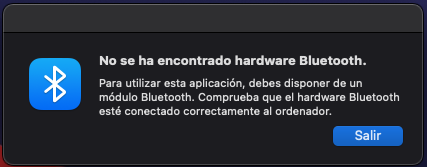

Hi all,

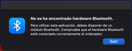

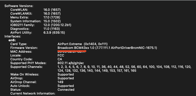

Have the same problem on a cMP 5.1(4.1) Single socket. The bluetoth card was upgraded as the same user @TECK.
I can use the Wifi but the bluetooth it's totally missing even on the hardware specs.
IY4F8zv0pSXK8c3GwXTiWoJAG63RFo7QLw3tjKq4bU8S_6oGInfhGFLdTdZ71U6GGMQzAjt648Pxn67HbPeCuvsz17rBbXAOwPePAk9rft8Ij21RC02TtesxOOJVgib7B2YutmnC
FbeD3niAlN20l62_iZbyeB75gZ6WSIqL7bEkXmDslrIhFGbY4fwcMZnwuKJVh9Mxk34foQvAYMdYC8Z6fVivGzNe09jq-cw0akbv-Jlfu3rzKORRCHXEF13y1vSPMw6aC6xJdFPc
I have catalina on my main NVME installed and This is on a SATA hdd as a TEST before migrate production. Open core 0.64 and change the config.plist name as the Big Sur Guide says.
Hope that this issue can be solved soon
I just noticed that package is for Broadcom USB devices, so I don't need to apply it

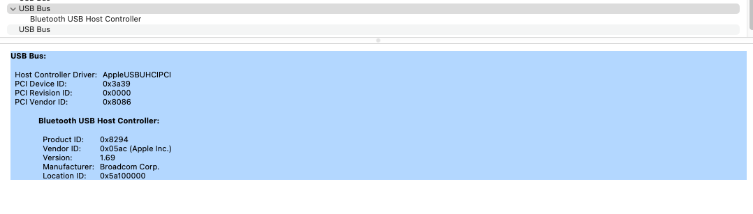

If you look closely at the system info you will realize yours is a USB device too (internal). It just does not have the supported product id for that patch:

Hi all,
Wi-Fi is connected via PCIe, but Bluetooth is connected via USB, thats why you always have Wi-Fi.
Big Sur and MP5,1 USB2.0 controllers are a problem right now, but people that never had Big Sur still have the same BT random loss and from all BootROM dumps sent up to now it seems to confirm that the multiple bluetoothActiveControllerInfo occurrences inside the main VSS store of the NVRAM are the real offender here.

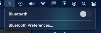

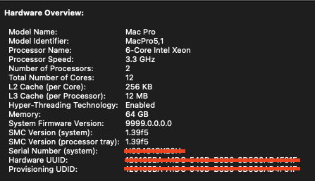

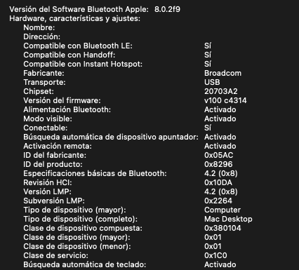

Hey, it appears that I am having the same Bluetooth issues on my 5,1 machine (4,1 upgraded to 5,1). I put in an AirPort card from another newer Mac and it worked fine until I upgraded to Big Sur 11.1 (currently on 11.2). Seemed to work ok under 11.0.1 and all previous versions of macOS. I would be interested to see if my BootROM is also corrupted. I am currently running OC 0.6.6 following the guide from the OpenCore on Mac Pro thread. My BootROM is the latest 144.0.0.0.0, however the new OC guide spoofs it to 9999.0.0.0.0 to prevent accidental firmware flashing which is why it comes up as such in the hardware overview. All other OS functions seem to be ok. Regardless of how many times I reboot into Big Sur the issue persists.
