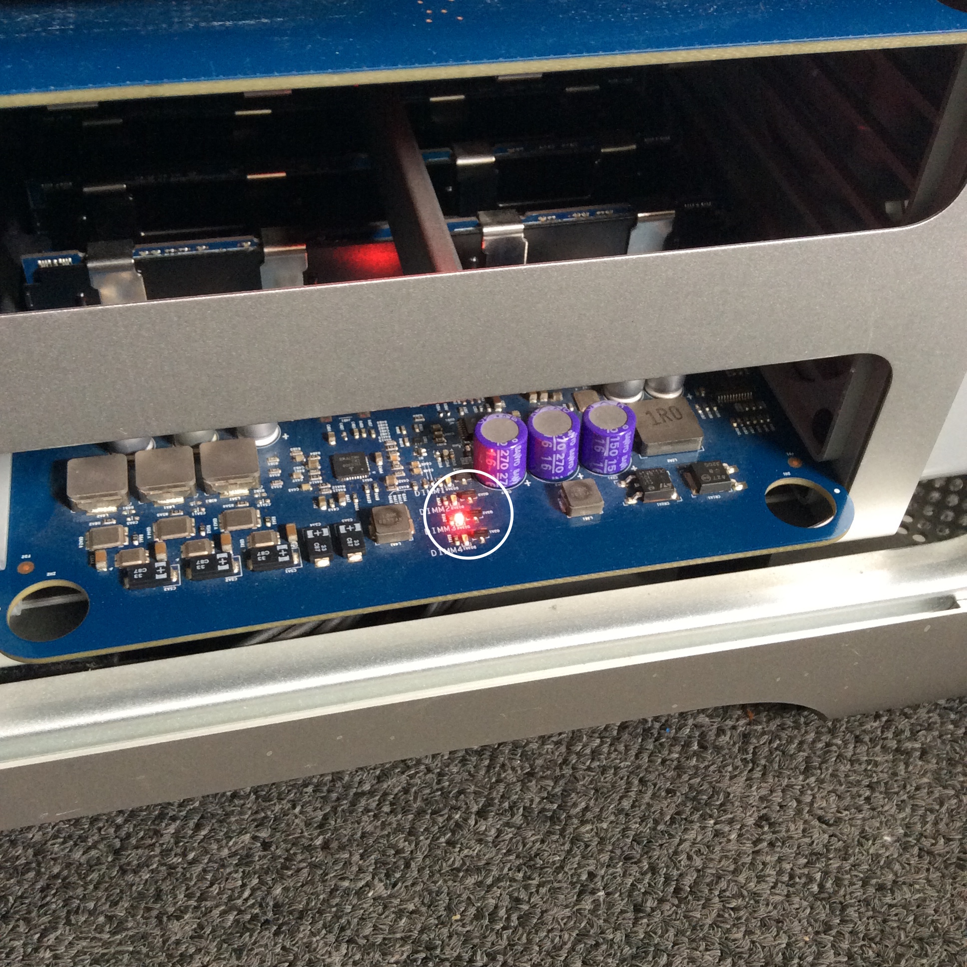

All the LED diagnostics are looking good.

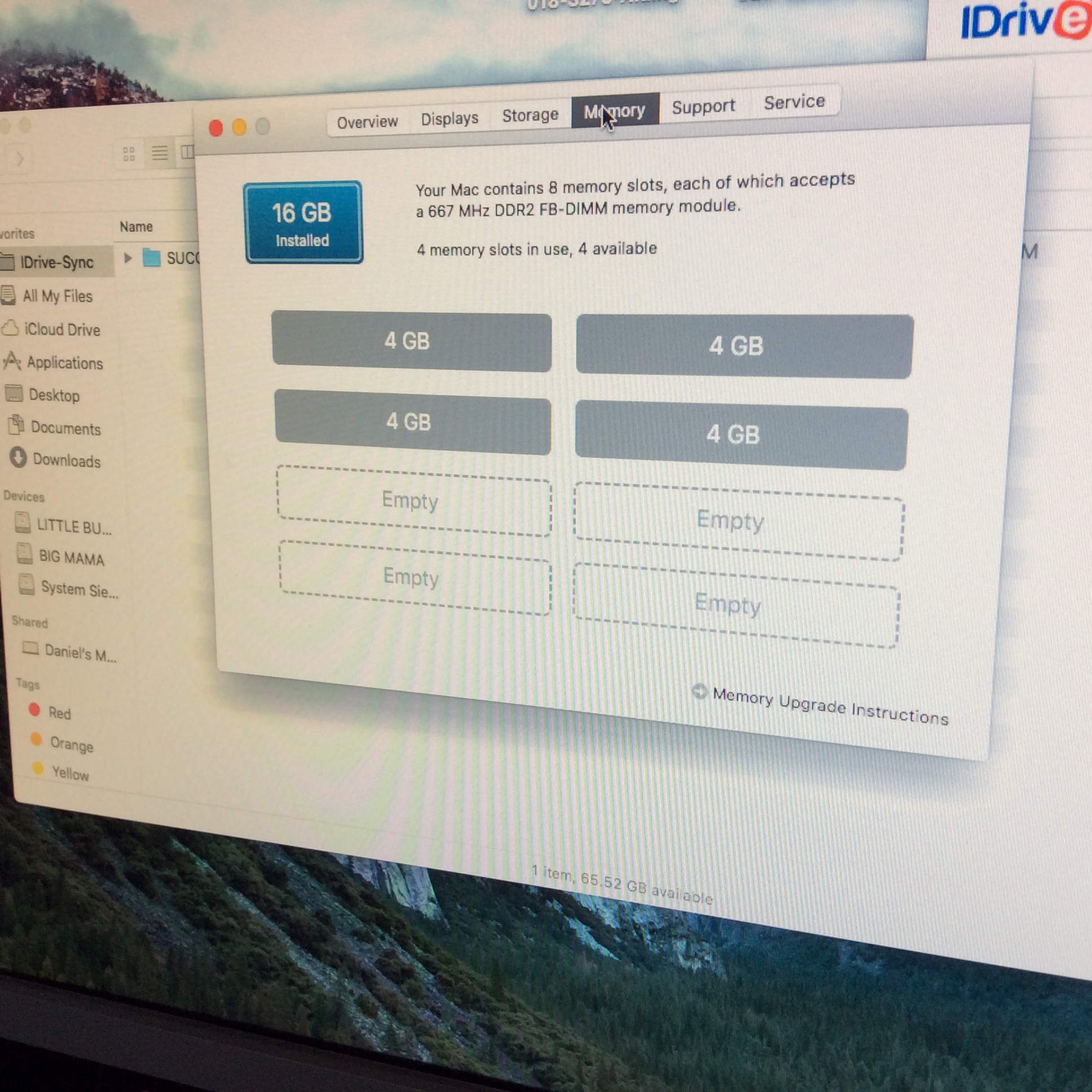

There are however some interesting RAM developments:
I assume this light isn't meant to be on?

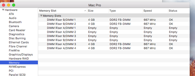

Despite all my slots being full (oh behave), the mac only seems to be seeing four occupied and four empty:
I bought this Mac Pro second hand, and have never touched the RAM. I always thought it only had 4 x 4GB of Ram, but it seems there are either 4 dead modules or 4 faulty slots in there. Going to do a bit of swapping around and see whats going on. For the record, does it matter which board is in the top and which is in the bottom?

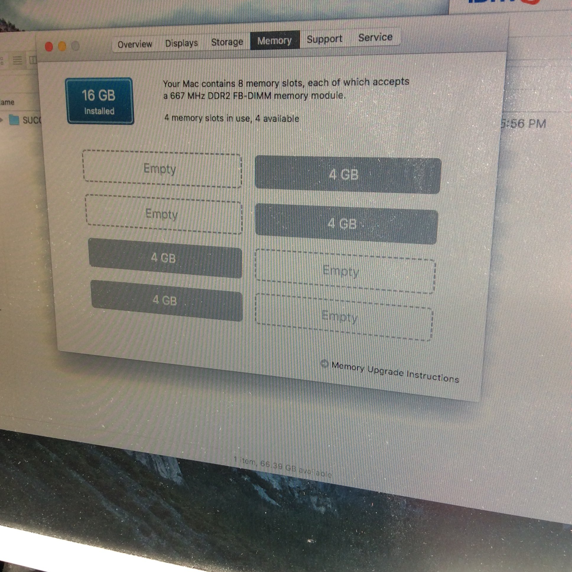

Service manual said ok to swap boards around so did that, and got reverse readout of which modules are working.
Implies that it's dead modules, and not dead slots - so that's good news.
Looking at the congfiguration of functioning modules, it doesn't match what Apple says is ideal. Going to move some modules around. I have an upgrade pack of 64GB RAM en route from the USA already. Getting ready for that upgrade is what got this whole palava started in the first place....
