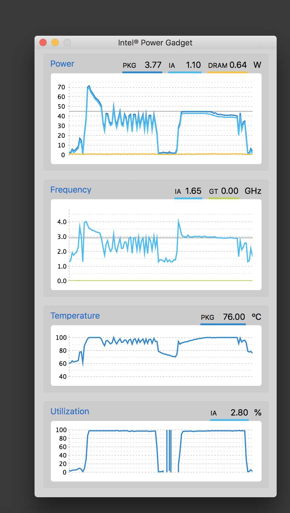

With OP's settings I still get a lot of throttling, whereas with Volta set to limit power to 45W (turbo boost still active) I get a solid 3+ Ghz. Graph below shows both tests, the left half is with OP's settings and the right half with Volta active. Everything is back to back so other than activating Volta halfway through all other variables should be relatively consistent.
I don't think the settings are surviving sleeps from the look of it, unless I'm misunderstanding.

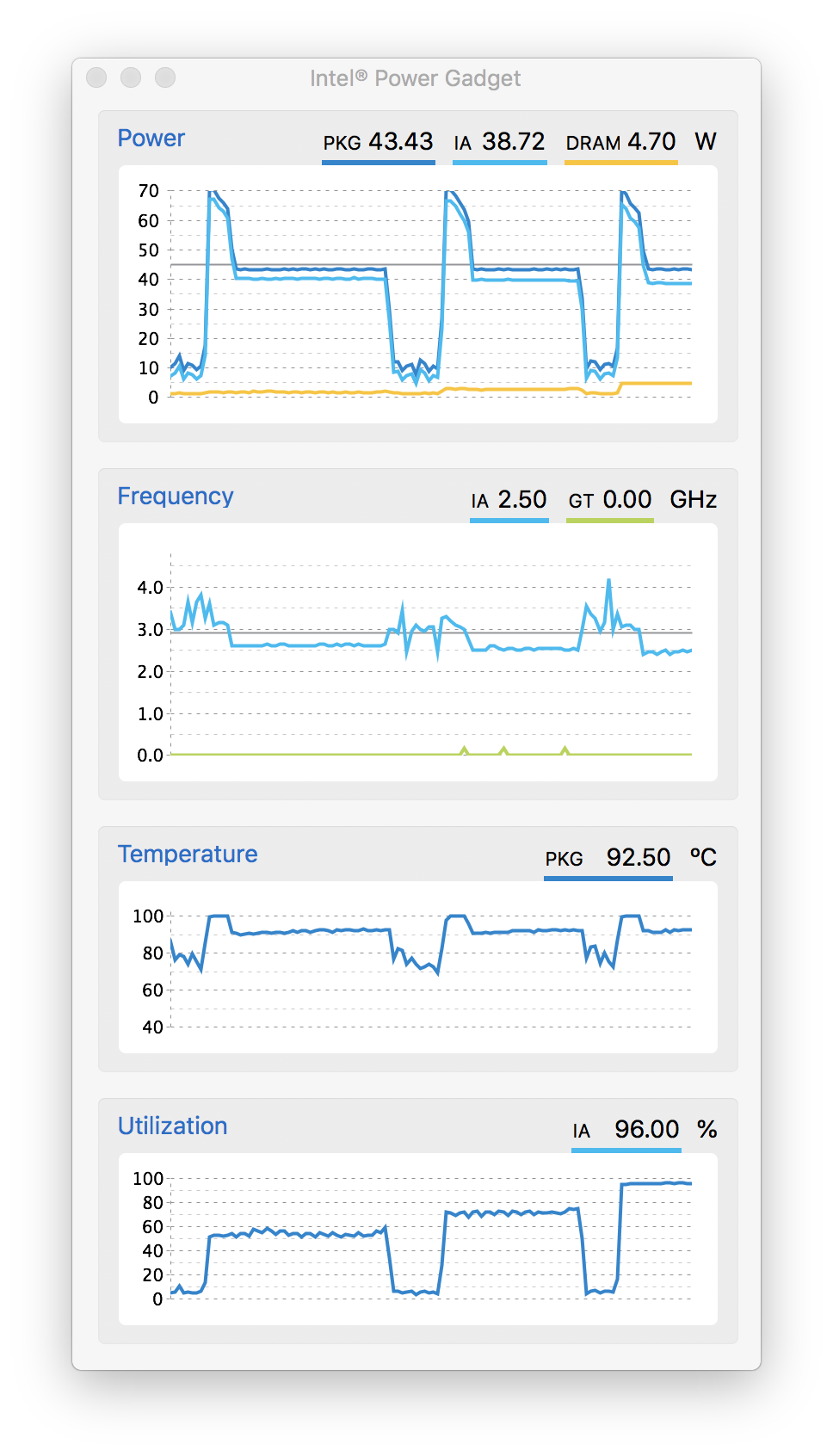

I'm playing with the PL2. I'm finding by setting it lower, I can sustain high boost clocks without overheating the CPU before it hits steady state... but 10 seconds is not a long enough window... And I can't work out how to derive the values :)
Any chance you can post the values from 10..20?
28 is too long :)
FWIW, this is what i'm using right now
0x428235001B815C
70.625W Boost, 43.5W steady, 8s window.
And an example of boosting at various cpu utilizations... then going to steady state. There's no VRM or thermal throttling. Its worth pointing out that p95 uses AVX instructions and so clock speeds get reduced by a few buckets.
