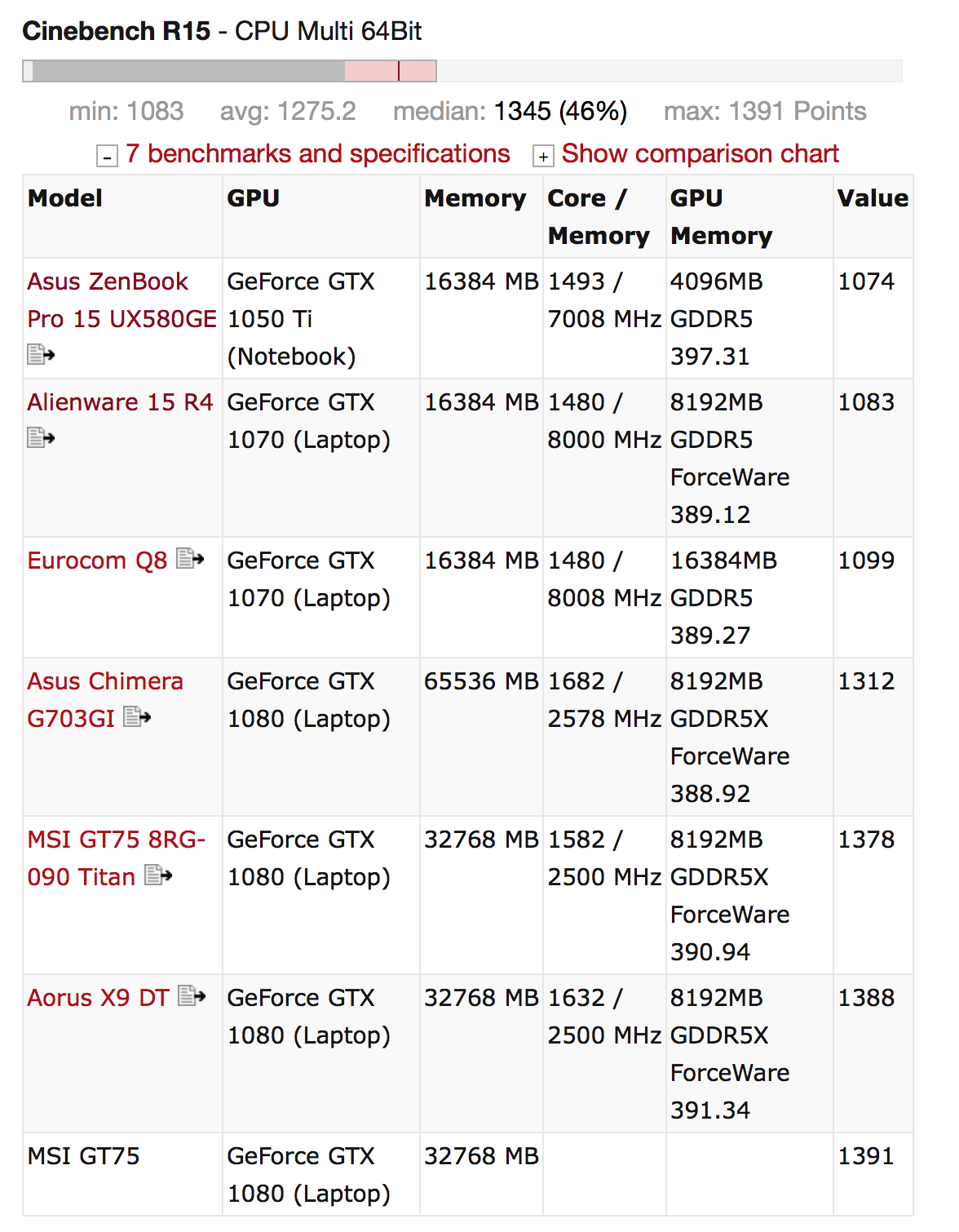

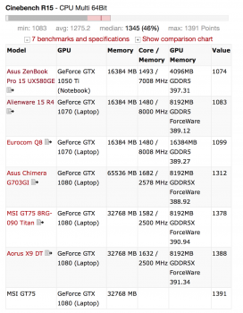

The average sustained Cinebench R15 multi-core CPU scores that notebookcheck.net has measured for other i9-8950HK implementations can be found in the screenshot below (source: https://www.notebookcheck.net/Intel-Core-i9-8950HK-SoC.279270.0.html). Four achieved 1300+, but they are all 8-10 lb. gaming laptops. The only one in the 15" MBP's weight class (it weighs 4.0 lbs.) is the 4.1 lb. Asus Zenbook Pro 15, which averaged 1074.
Also in the MBP's weight class is the 4.6 lb. Dell XPS 15 i9, whose stock performance averaged ~1000 but, with undervolting, averaged ~1150 (https://www.notebookcheck.net/Dell-XPS-15-9570-15-more-performance-by-undervolting.317738.0.html ).
So it would seem that if the post-fix i9 MBP could, under the same test conditions, average in the 1000 - 1100 range, it would be in the ballpark for multi-core thermal performance within its class—at least for the use cases approximated by this benchmark. [I am assuming that the OS doesn't significantly affect Cinebench CPU performance.]
