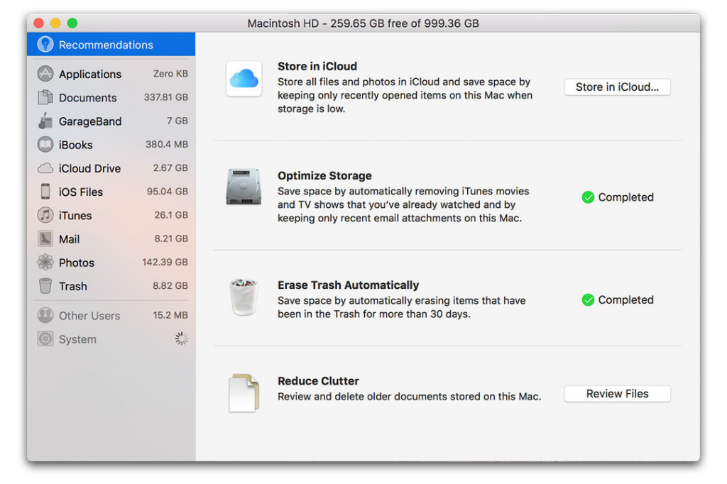

Optimize Storage
Apple's recent wording:
Save space by automatically removing iTunes movies and TV shows that you've already watched and by keeping only recent email attachments on this Mac.

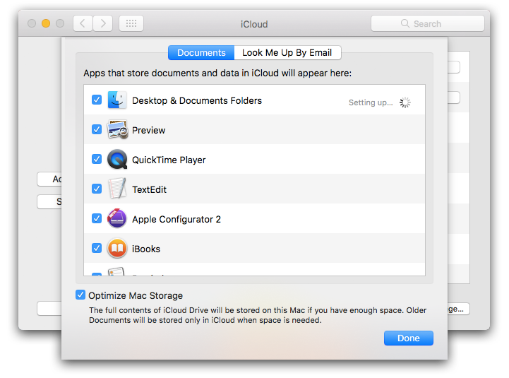

Optimize Mac Storage
The full contents of iCloud Drive will be stored on this Mac if you have enough space. Older Documents will be stored only in iCloud when space is needed.
At http://techsviewer.com/macos-sierra-slow-fixes/ (the page from which both screen shots were taken) I see some possible misunderstandings:
When using macOS Sierra, you have access to identical backup of everything you have on your HD stored in the cloud. This backup can be accessed on your Mac and you can also download and use it on another Mac elsewhere. The remote access and unlimited nature of this storage is something to maximize by simply storing some of the data in the cloud and freeing up your disk space. You can always retrieve the data and files when need for their use arises. However, an external offline backup is often more preferable especially since the cloud backup automatically syncs and may choose to lose some data if unused for quite a long period of time.
1: I should not never treat it as a backup, although I understand why some customers will think of iCloud Drive Desktop & Documents Folders in that way.
2: it's far from everything on your local disk. Even if you have enough space in iCloud for everything in the two local folders, you should expect some types of exclusion.
3: I'm not aware of an unlimited option. iCloud storage plans and pricing - Apple Support (en-gb version captured in April 2016) shows a maximum of 1 TB.
4: if the last sentence suggests that iCloud Drive Desktop & Documents Folders may lose data, that's probably untrue.
Side note (postscript): the article's recommendation of CleanMyMac 3 is highly questionable, but that third party software is off-topic from Apple optimised storage. The four points above are to draw attention to the types of misunderstanding that might become commonplace. Yeah o_O I should have chosen a better article as an example.

Re: the second screenshot above, @niji wrote:
does this mean: that if you do NOT click the check box at the bottom (Optimize Mac Storage) that in fact your Desktop and Documents Folders would be BOTH on your local device and in the iCloud and nothing would be evicted by apple?
if that is possible then i am all in for this sync as it would be me controlling what is deleted.
thanks for your advice.
The meaning of Apple's paragraph for [*] Optimise Mac Storage might become clearer if the two sentences (for that one feature) are rewritten in this way:
When this Mac has enough space for everything that's on iCloud Drive: everything that's there will also be stored on this Mac.
When this Mac has not enough space: newer documents will be in both places, older documents will be on iCloud Drive alone.
I would like to verify the truth of those statements, but I can not create a suitable remote data set; after days of trying, there's only 2.3 GB of documents. The combination of iCloud Drive plus the current build of Sierra is struggling to complete my first test set of around 1.05 GB.
From WWDC 2016 there's a transcript of What's New with CloudKit (session 226) which mentions iCloud Drive but there's no mention of optimised storage. https://developer.apple.com/wwdc/schedule/#/details/2300 and https://developer.apple.com/wwdc/schedule/#/details/2370 also mention iCloud Drive, but neither has a transcript.

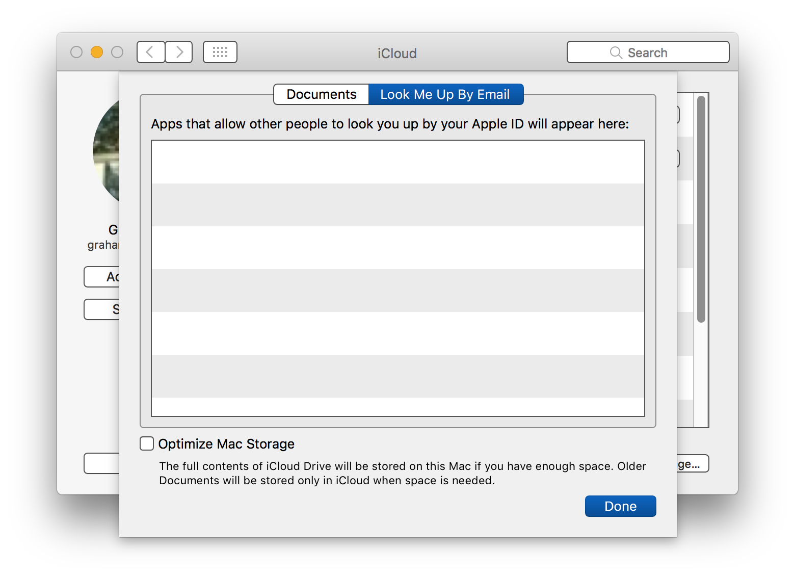

To anyone who has the first golden master:
  • does Optimize Mac Storage still appear at the foot of the following dialogue?
iCloud —> Look Me Up By Email
Feenician
macrumors 603
Jun 13, 2016
5,313
5,100
I can't answer your question exactly, I didn't get the first GM and am downloading the 2nd now, but that setting isn't exactly at the bottom of "Look Me Up by Email", is it? Well, visually it is but not logically. It appears on the other tab of the iCloud Drive settings too, "Documents" and is a more general iCloud Drive setting. That dialog is a bit of a horror show though.
