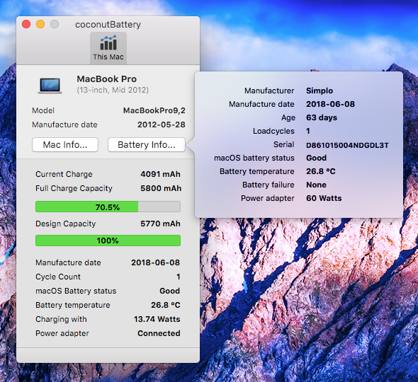

Battery in my MacBook Pro 13" Mid-2012 has just passed 490 cycles and doesn't hold a decent charge like it used to. So I hunted around for a new OEM battery online as I didn't want to pay the price Apple is asking for a battery replacement and yesterday I've bought what seems to be a brand new, "genuine" OEM Apple battery from an eBay seller @ £43 (including postage) who had great feedback (after much research from various sellers).
I was a bit wary of the price but if it didn't work well or wasn't a genuine OEM part, I was going to return it. It arrived earlier today via DPD, opened the package and the new replacement battery looked exactly identical to the original Apple battery I have with markings/warning labels and part numbers being spot on (just like yours).
Just installed the new battery into my MBP, reset SMC and coconutBattery reports the following (initially had 67% charge from cold boot) ...
Looks promising. Will calibrate the battery once it's fully charged and see how well it holds up. Happy with the purchase so far!
