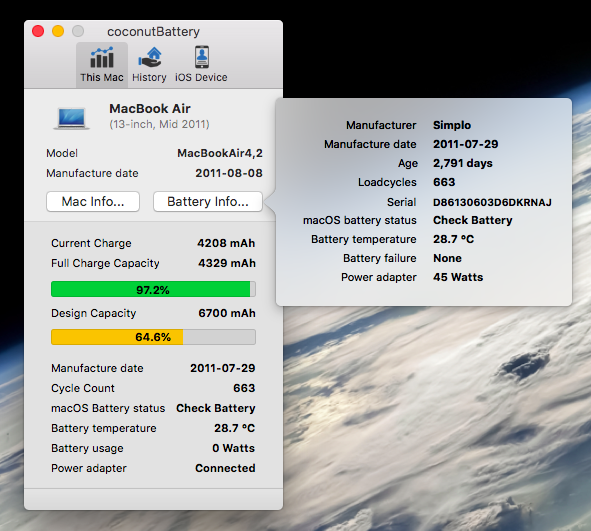

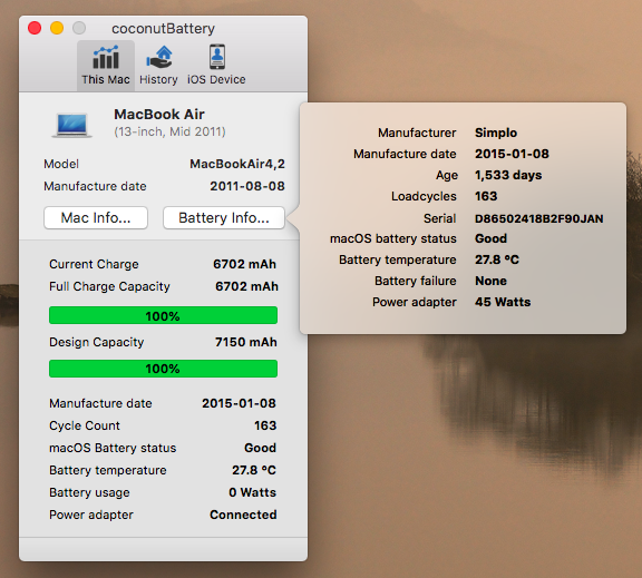

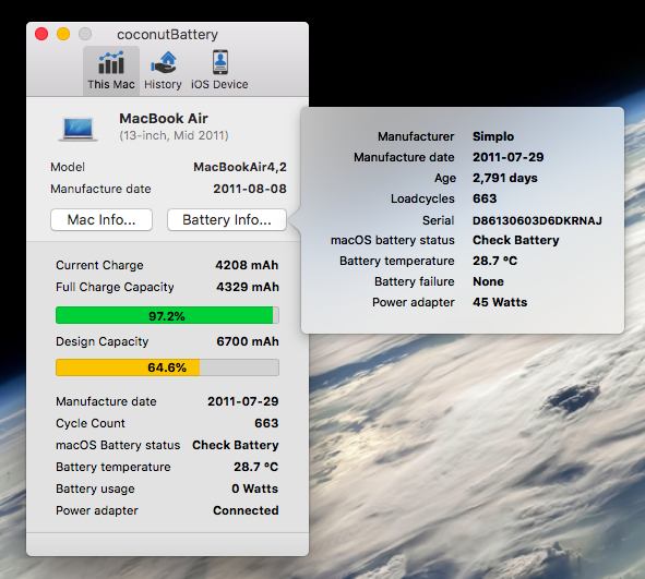

My mid-2011 Macbook Air battery has had it, checked my battery with coconutBattery. The battery has an age of 2,787 days. Has a Full Charge Capacity of 4466 mAh out of 6700 mAh (66.7%) with a cycle count of 662.
After reviewing this thread, I decided to try my luck on a used "genuine" Apple battery off ebay.
I decided to go with seller cnytechsales, because all of the reviews looked good and they listed the number of cycles (in ranges of 100) for the batteries they are selling.
I got a used battery from cnytechsales with 100-200 cycles on it for $20, free shipping.
After I get the battery and install, I'll provide an update.
Got "new" battery and installed it. Here is the comparison between my old battery and "new" battery.
"New" battery looks to be a genuine Apple battery and has 163 cycles on it and a capacity of 6702mAh out of 7150mAh, which is not bad for $20.
