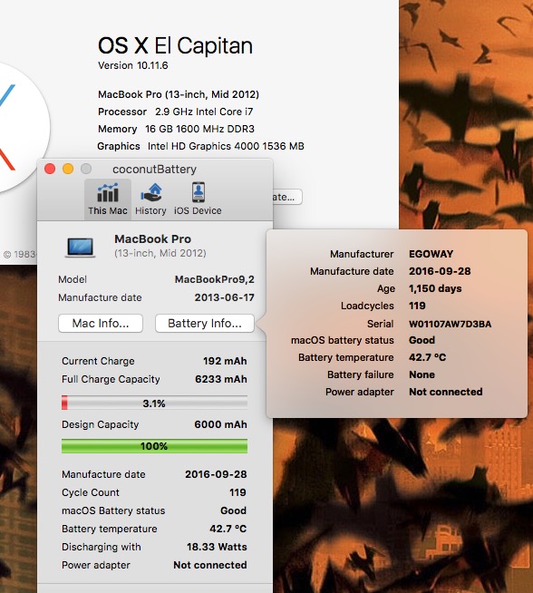

When installing an advertised OEM, and claims to be from the period of same battery as original. Is there any way possible to know it’s not just a fake battery that just looks like the original, when you install it. Is there a date of manufacturing anywhere in the info
Does Coconut battery show manufacturers date of battery or just the MBP? I presume despite what I’ve asked about here, that anyone making a fake battery can fake the name and year readings too?

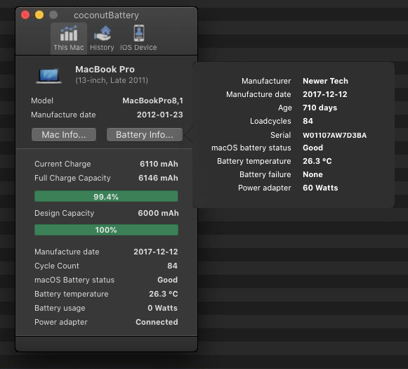

Ok, I checked out he Amazon links and I honestly can't speak to those. There are SO many battery options on Amazon for these machines. But I did go that route before the Newertech B&H battery and the iFixit piece of garbage. My experience with the Amazon battery was that is did not last very long. It started draining fast after one-year. I remember debating and researching all the Amazon options, reading reviews, etc. I can't remember why I chose the one I chose which was an Abyone rated at 6000.
In terms of heavy useage and battery life with my Newertech, I honestly don't run anything that intensive like logic or final cut. I pretty much use Office, Photos, Email, Safari, etc. I can't speak to the life under heavy usage. I am getting about three hours unplugged, sitting on the couch and surfing. My old machine has begun to run hot and the fans do kick in a lot more than it used to. This could be because of the OS that is not supported (Catalina) or my 2133 RAM.
Battery still lists as healthy. Let me know what else I can answer.

Would you mind sharing a Coconut Battery screenshot of your 2-power battery? Did you run Windows(Bootcamp) on your MBP?
I am using a 2-power battery with my MacBook5,1 and hope it will last longer than 12-month warranty period by Duracell Direct.

My Newertech battery is going strong, in fact, it's increasing in MAH as it breaks in. Now showing 100% 8471mah at 44 charge cycles. My last Ifixit battery was at 48% capacity at 34 charge cycles when it was removed and returned for the full refund. My ifixit batteries were NEW, meaning the date on coconut showsed they were like one month old, so factory fresh.
I recomend NOT gluing in your replacement battery until you confirm it won't need to be swapped out again soon...i put some folded up business cards over the batery before putting the lower cover back on, to compress and keep the battery from dropping once turned right side up.

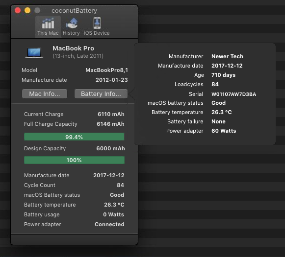

Nope, never run bootcamp, in fact, as you'll see I never really had many load cycles on the battery. It's also manufactured very recently so it's not like I have an old unit. I purchased this mid October 2019 for reference, it cost me £74 GBP to the door.
Complete dud!
Apple have said they'll service it and I have an appointment booked for Tuesday. This is the UK for anyone else following.
